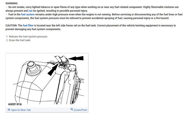

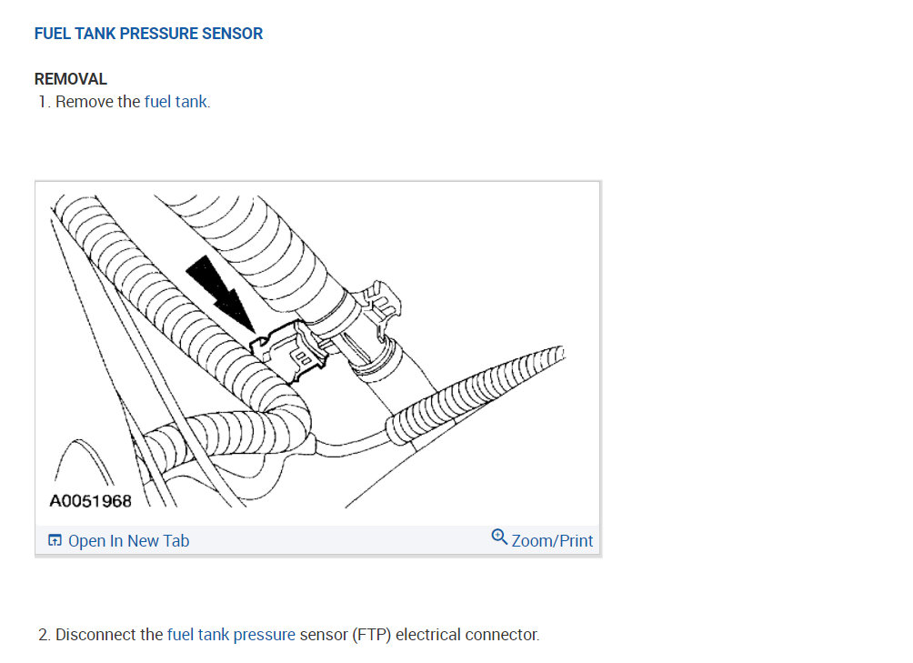

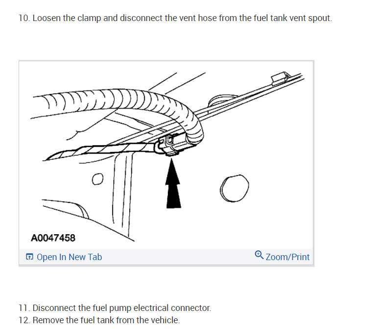

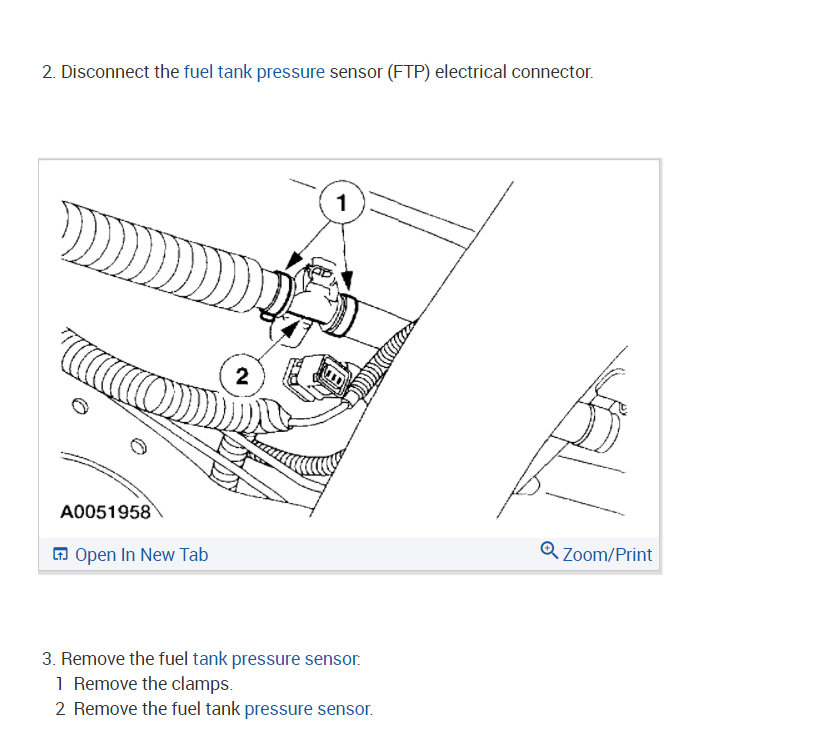

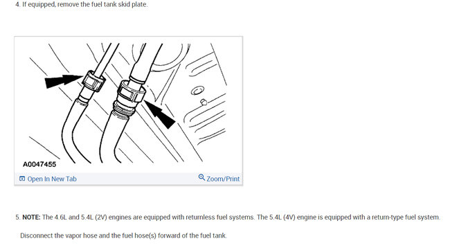

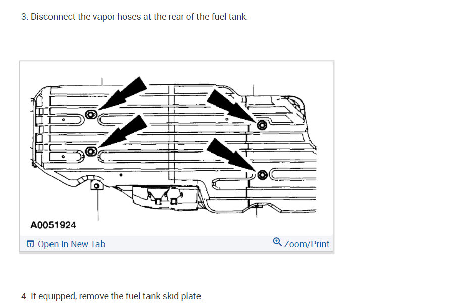

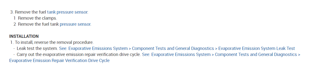

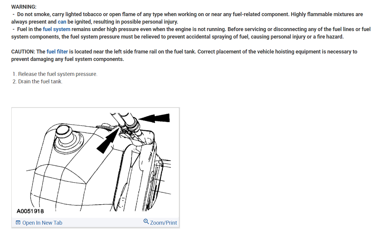

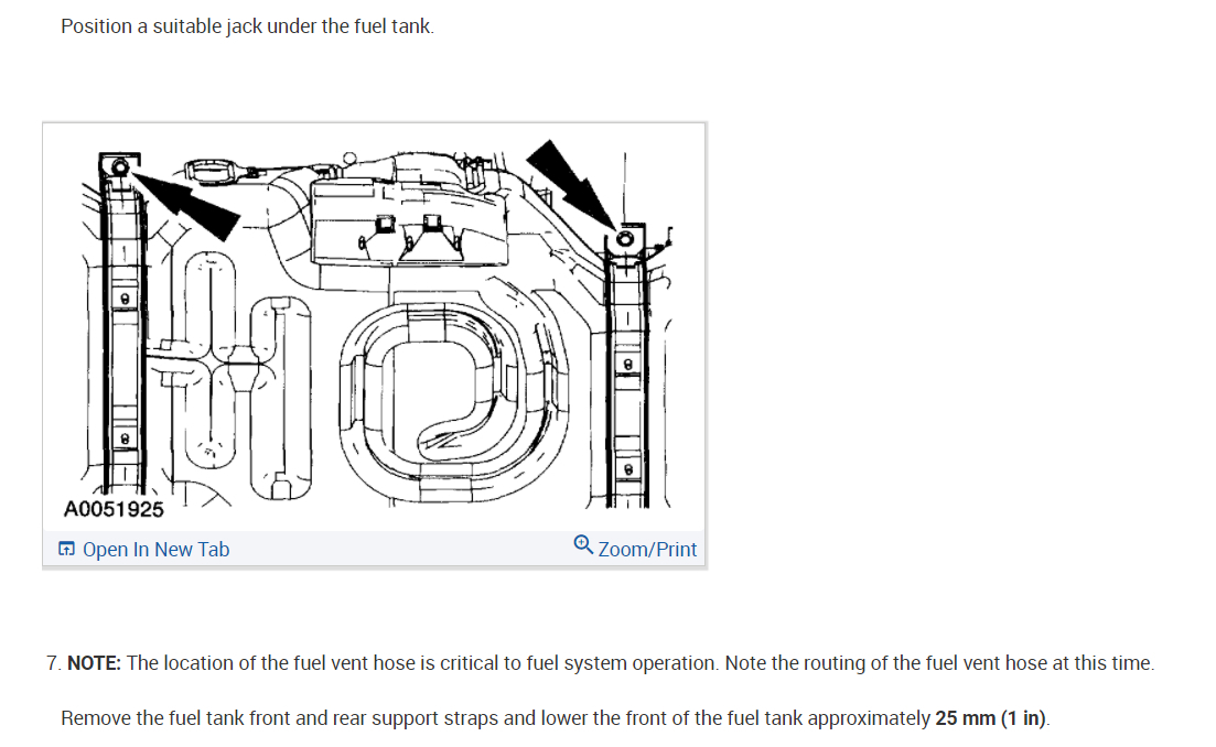

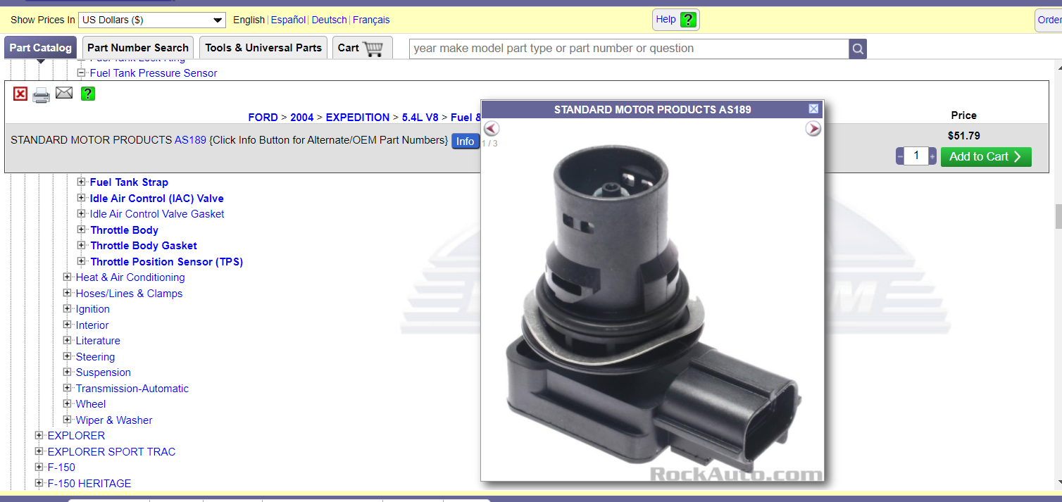

I cannot find a single diagram on the fuel tank pressure sensor location to replace it.
Jul 11, 2021 at 7:57 AM
Experienced Mechanic
52,796 POSTS
Good afternoon,

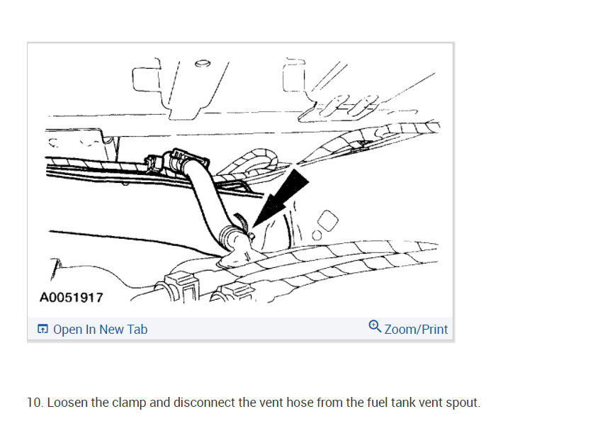

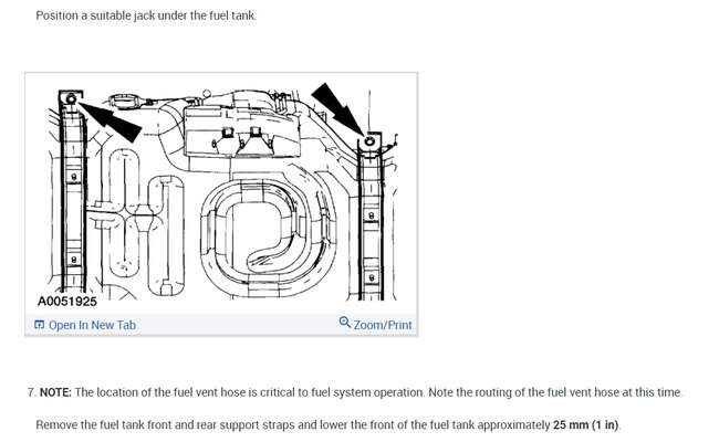

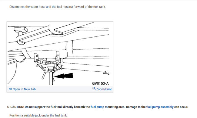

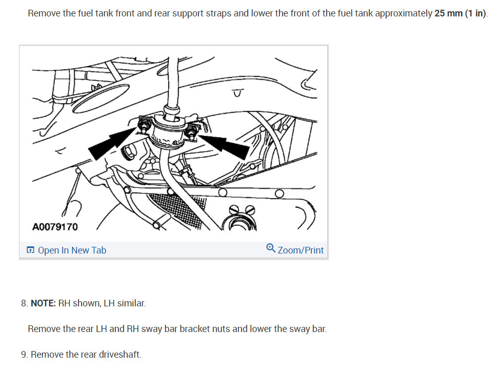

The sensor is in the Evap line above the fuel tank. The tank must be dropped to gain access to the sensor.
I attached the procedure and the part from rock auto for you below.
I also attached the procedure for dropping the tank for you.
