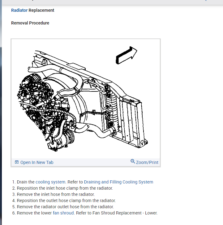

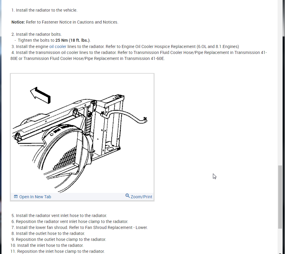

just want to watch a video if you guys have one on how to replace one on my truck?

Good afternoon,
I attached one for an Escalade which has the same platform as the Tahoe.
https://www.youtube.com/watch?v=mt7g-0lM4bY
Mar 10, 2020 at 6:54 AM
Experienced Mechanic
18,907 POSTS

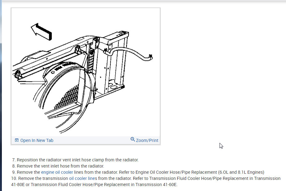

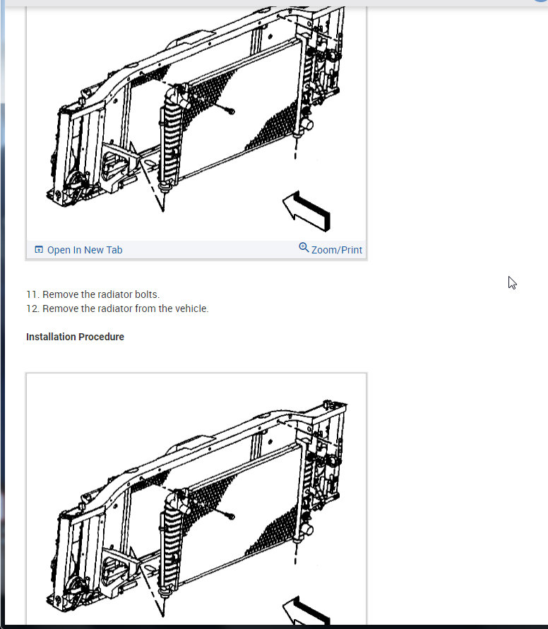

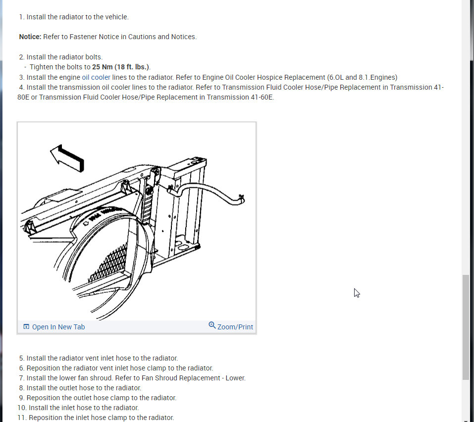

I am also attaching the process from the manual below on how to replace this as that should help as well.
Lastly here is a guide on how to replace a radiator as well. This will help in more general terms.
https://www.2carpros.com/articles/how-to-replace-a-car-radiator
Let us know what questions you have. Thanks
