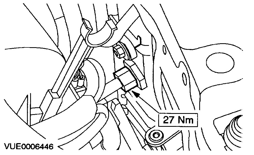

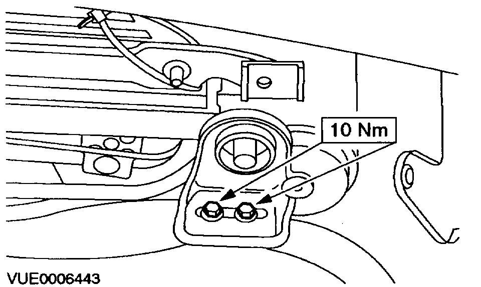

I need to know how to replace the radiator. Mine is pushing water out of the top.
May 24, 2019 at 11:40 AM
  • 110,241 POSTS
Welcome to 2CarPros.
First, I am providing information for a Mercury Cougar (V6 2.5L) If that is incorrect, please let me know.
Here are the directions for replacing the radiator. The pictures attached correlate with the directions.
_____________________________________
PROCEDURES
Removal
All Vehicles
1. Disconnect the battery ground cable.
2. Drain the cooling system.
pic 1

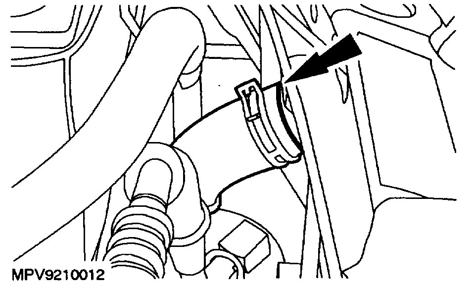

3. Disconnect the radiator upper coolant hose.

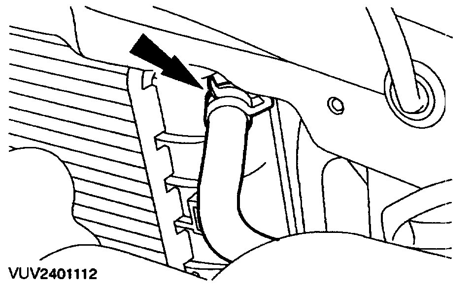

Vehicles With Automatic Transaxle
pic 2
4. Disconnect the transaxle upper cooling line.

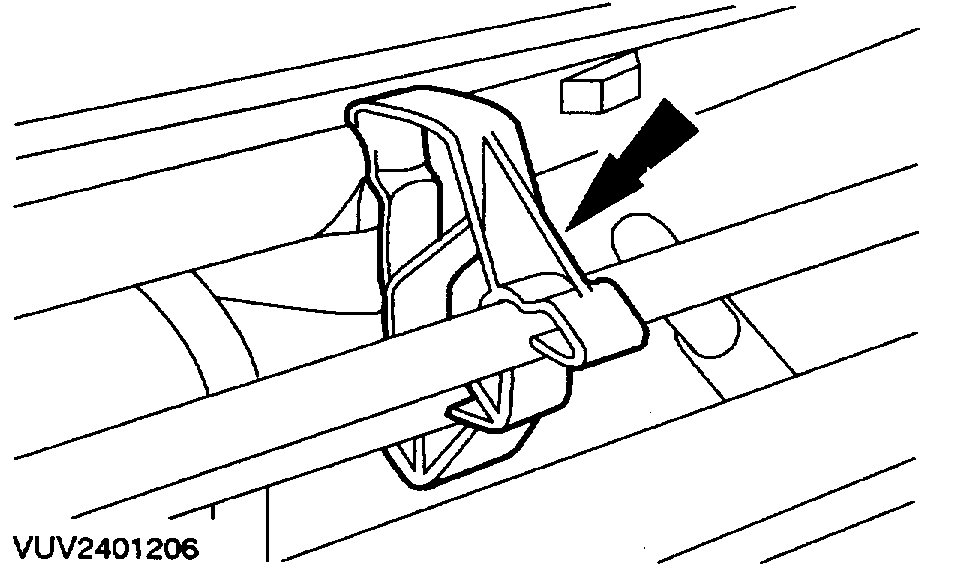

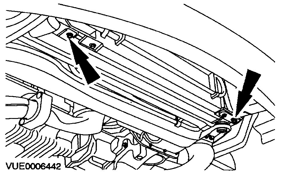

Vehicles With 2.5L Engine
pic 3

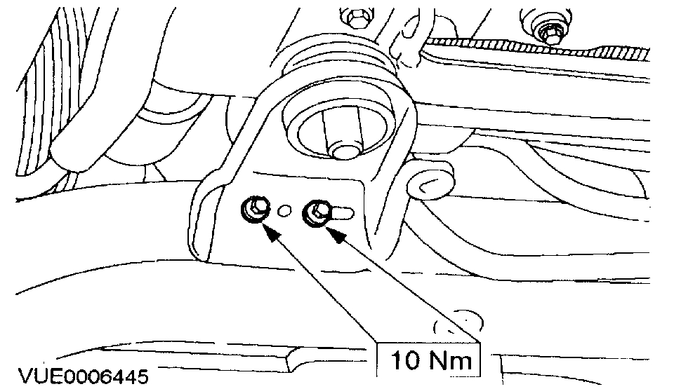

5. Disconnect the coolant expansion tank hose.

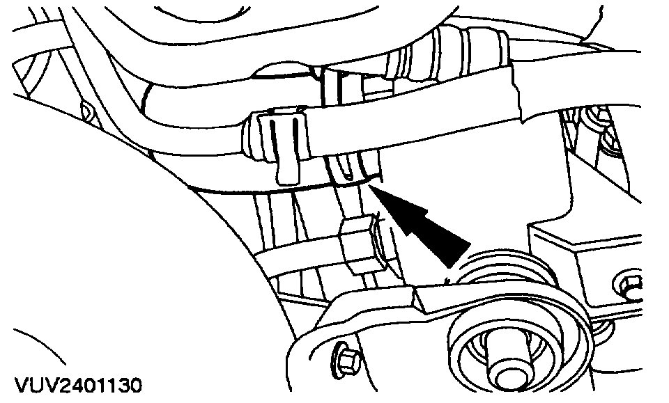

All Vehicles
pic 4

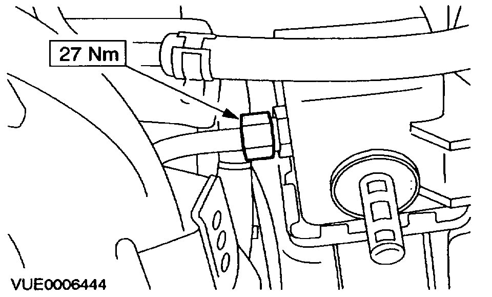

6. Remove the fan shroud nut.

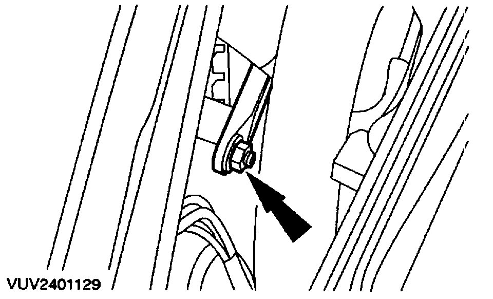

pic 5

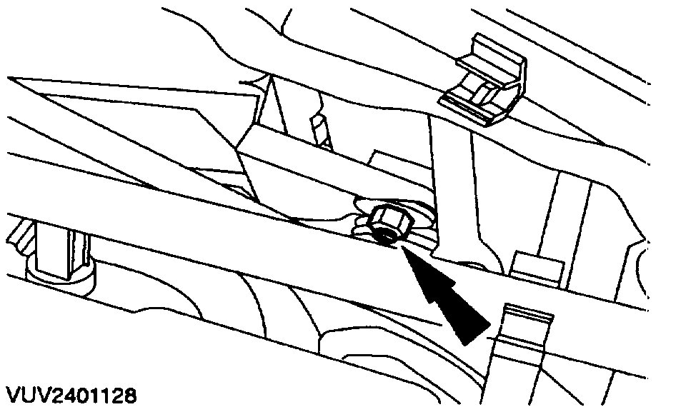

7. Detach the fan shroud and secure to one side.

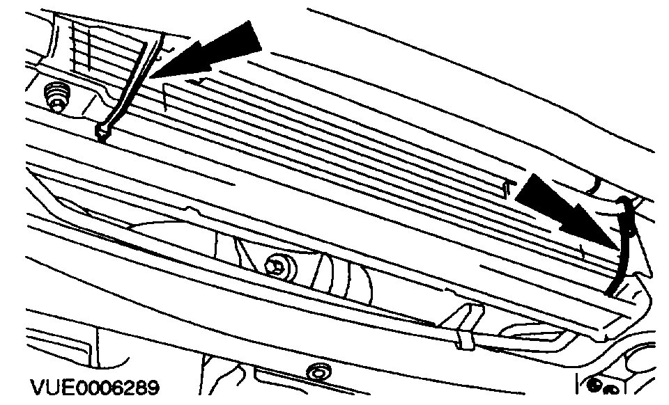

8. Raise and support the vehicle.
Vehicles With Air Conditioning
pic 6
9. Secure the air conditioning condenser.
