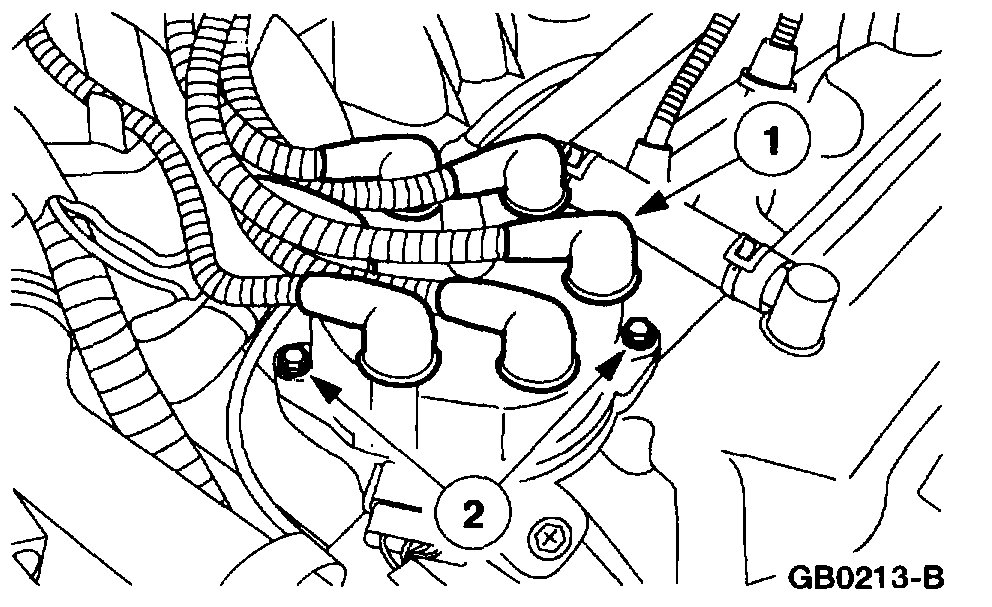

I am getting ready to replace my distributor and will need to reset my timing. I am pretty sure I can do this, but could you tell me step by step how to do this and also the firing order for the spark plug wires?

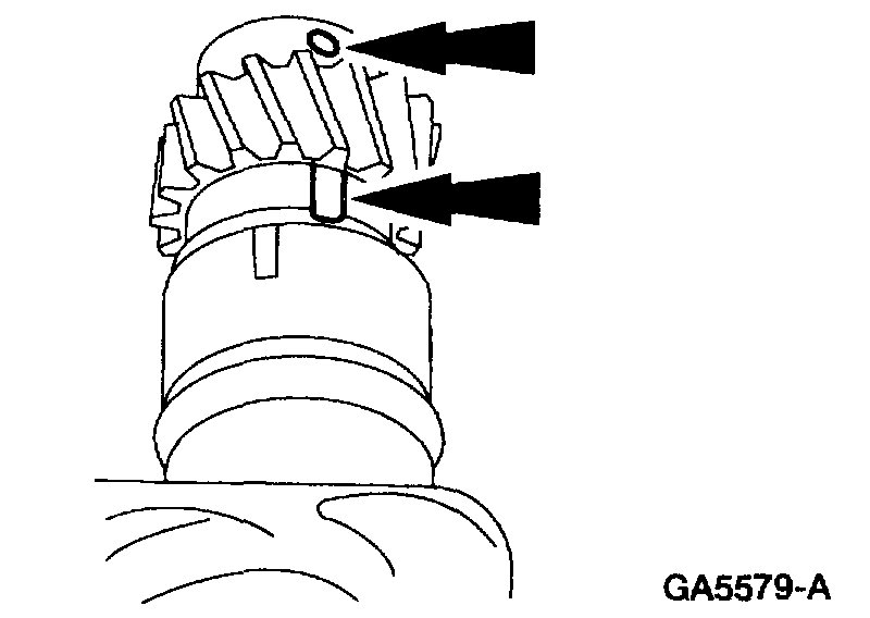

Here are the directions for removal and replacement of the distributor. The attached pictures correlate with these directions.
REMOVAL
1. Set the engine (No.1 piston) to the Top Dead Center (TDC) on the compression stroke.
2. Disconnect the battery ground cable.
Picture 1

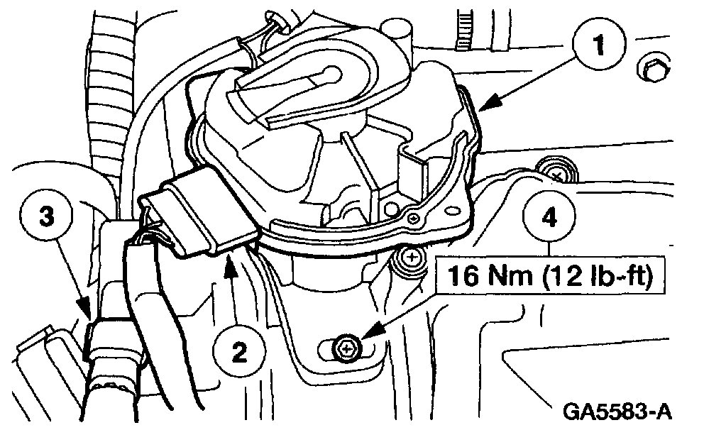

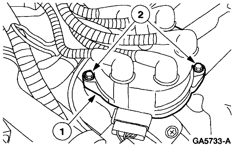

3. Remove the distributor cap.
1 Remove the spark plug wires.
2 Remove the screws.
NOTE: Mark the spark plug wires to make sure proper position on installation.

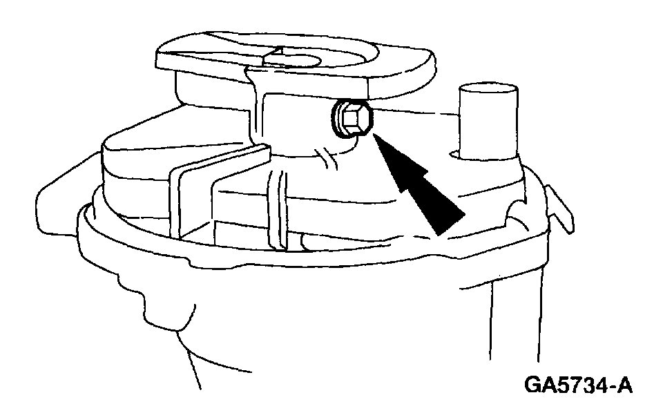

Picture 2

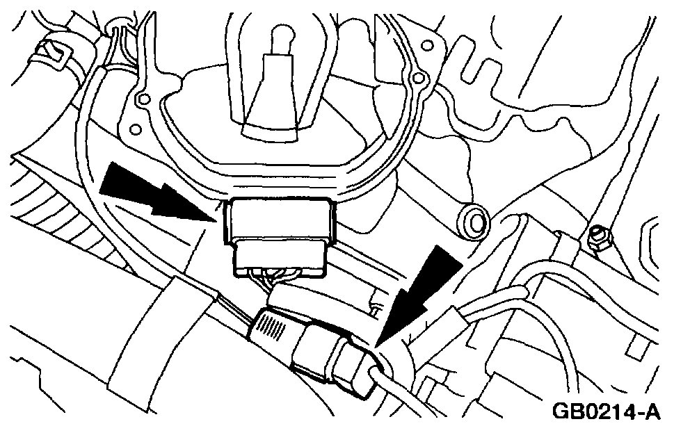

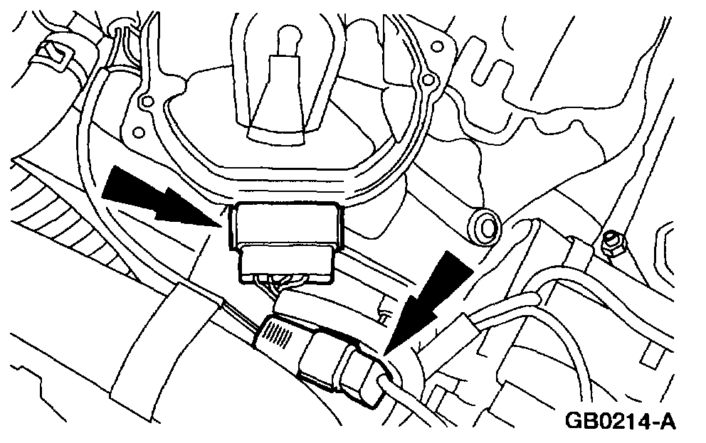

4. Disconnect the ignition coil electrical connector from the bracket and disconnect the Camshaft Position (CMP) sensor electrical connector.
Picture 3

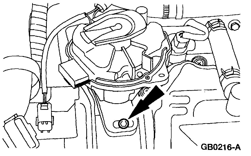

5. Remove the distributor.
^ Remove the bolt.
Picture 4

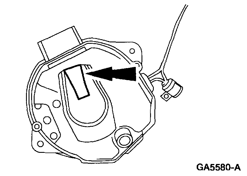

6. Remove the rotor. Remove the screw.

1. Install the rotor.
^ Install the screw.
Picture 6
2. Align the mark on the distributor shaft with the protruding mark on the distributor housing.
Picture 7
3. Install the distributor assembly.
1 Install the distributor.
2 Connect the electrical connector.
3 Connect and clip the electrical connector.
4 Install the bolt.

4. Confirm that the distributor rotor head is set as shown.

5. Install the distributor cap.
1 Position the distributor cap and connect the spark plug wires.
2 Tighten the distributor cap screws.
