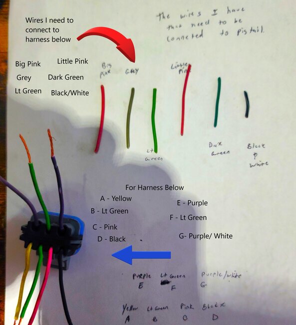

Hello, So I got involved with putting in a transmission and replacing both wiring harnesses for neutral safety switch in which most of this was taken apart before I had touched the vehicle which I hate doing but was trying to help a friend out. However I put a used transmission in "reputable place for used parts" anyhow the wires on the new harness which one has 4 and the other harness for NSS is 7 as I only have a total of 10 wires and they are not oe color coated either so after putting everything in and together I can get vehicle to start but when putting into gear it doesn't matter which one the vehicle won't move as well as instrument gauges at least speedometer is at 80mph at idle and temp gauge is not even reading on gauge it's way passed the hot mark which is not overheating do to just starting vehicle my question is, can the neutral safety switch have anything to do with this? I am thinking it does but I have looked everywhere on how to wire both of them which I know the 4 wire is right that one was oe colored coated so I just matched wire for wire but the 7 pronged wire harness I have no idea if it's correct I am thinking not, hoping you can help please?

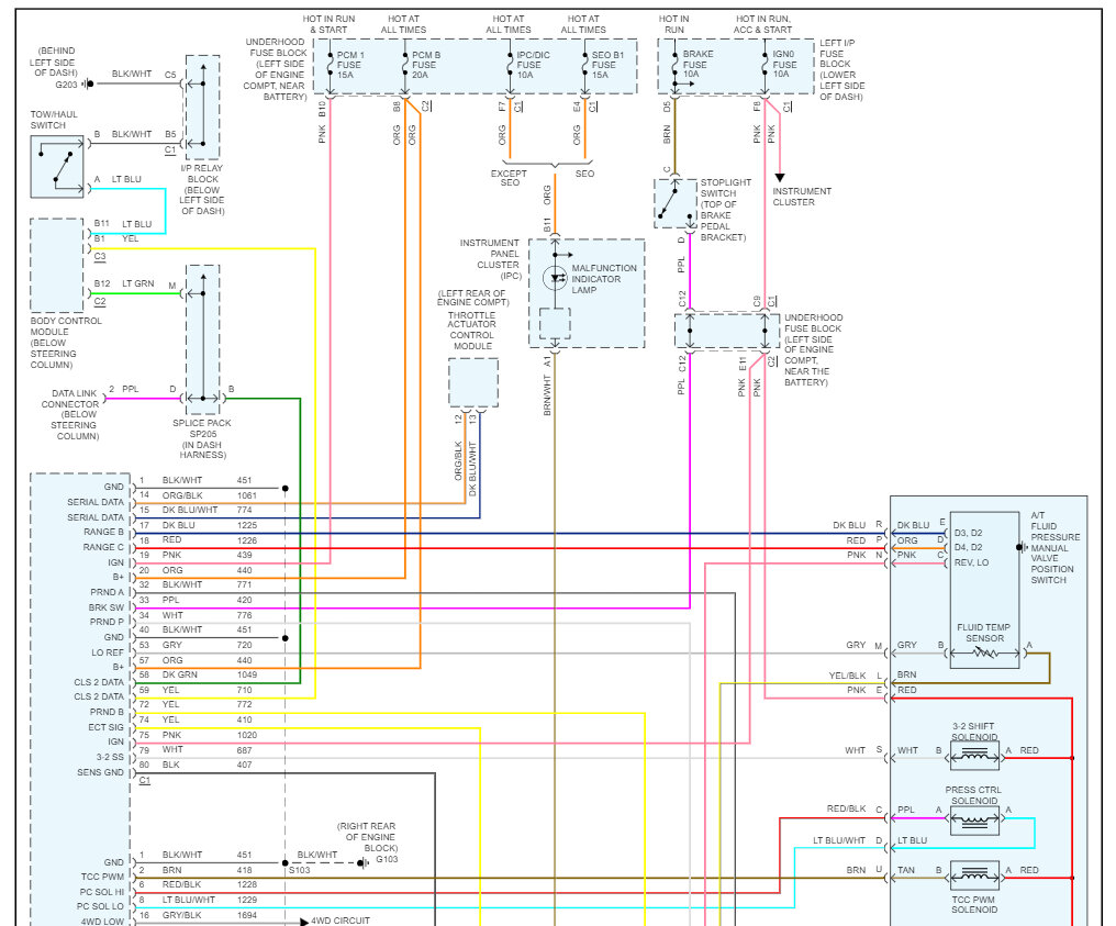

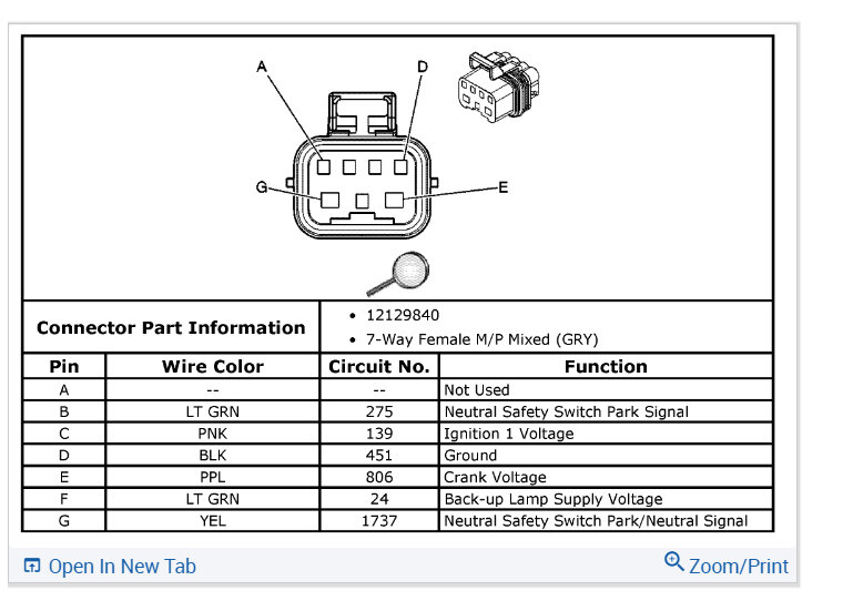

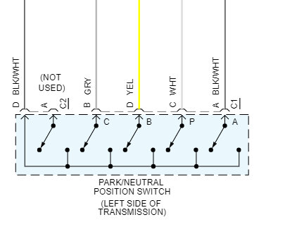

It sounds like the wiring is not connected correctly. Here are the wiring diagrams and a guide to help test the connections to help you see if the wiring is working.
We also run the codes to see what comes up.
Check out the images (below). Please let us know what you find.

So, I am hoping you can help me out with this, and I hope this helps see attached image and can you advise me what wire should go where. As I have looked at the schematics and I am not exactly sure 100% where they should go however wiring is not my strongest suit just hoping you might be able to clarify this for me please?

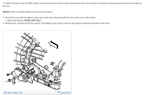

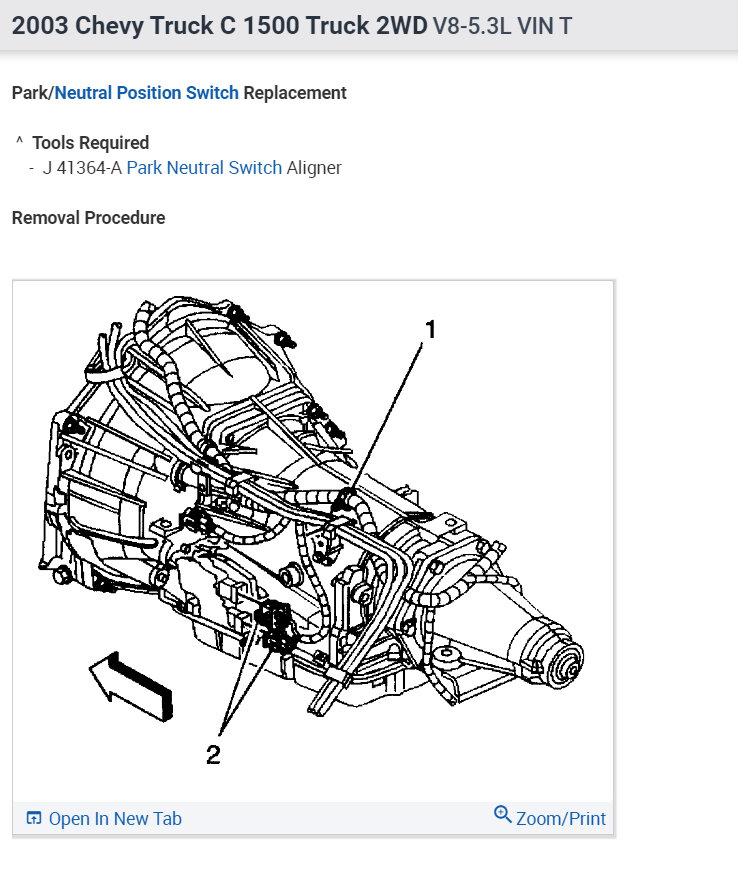

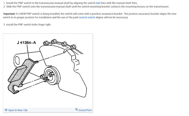

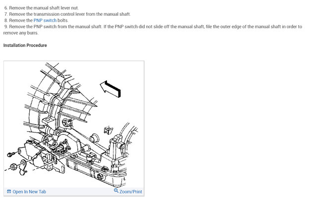

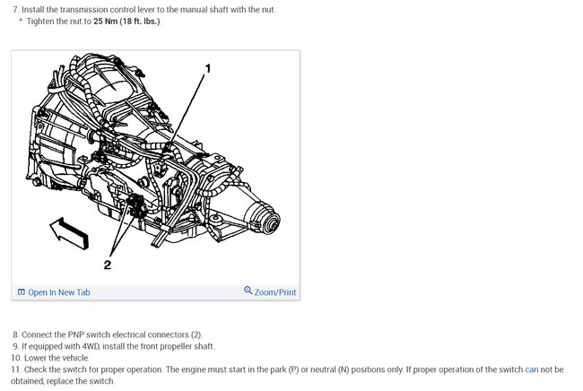

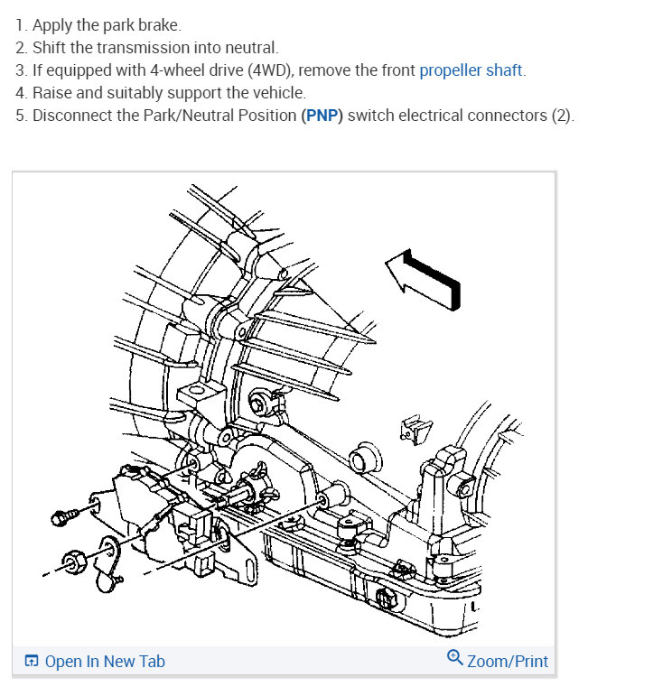

Can you remove the gear range sensor and install it on the new transmission? That would be best instead of trying to wire a switch that doesn't below in the truck. Check out the images (below). Please let us know what happens.

I am trying to install the wiring harness that connects to the neutral safety switch. It doesn't matter if I put the new in and or the one that came off old transmission if I don't have a wire connector to plug into it, why would that matter? The picture I sent is the wire connector that I need to have, and the individual wires are the colors that I have that came off the wire harness. I just need to know what color go to what on wire connector as I seen diagram you posted, and I am not a 100% sure which one goes with what.

What year make model is the neutral safety switch are you trying to wire in? I can get the wiring diagrams for that part and that way we can compare.

We already have the wiring diagrams for that model. What year did the neutral safety switch come out of you are trying to wire in?

Yes, the neutral safety switch, that is what the wiring diagrams are for. I don't have any information on an aftermarket harness.

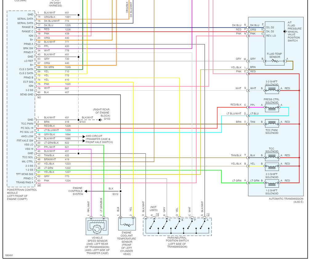

So A,B,C,D,E,F, and G on the wiring harness won't be the same as the original harness? I thought the location identified as the above letters is all that mattered am I wrong? Meaning a certain color wire goes to A, B, C etc, etc?
Jul 28, 2023 at 7:44 AM
OPTIMISITC13
  • 11 POSTS
Because the lettering on the original switch are the exact same on the aftermarket harness. Can you tell me based on your wiring diagram what color wire is supposed to go to what location on the wiring harness?
Jul 28, 2023 at 7:46 AM
OPTIMISITC13
  • 11 POSTS

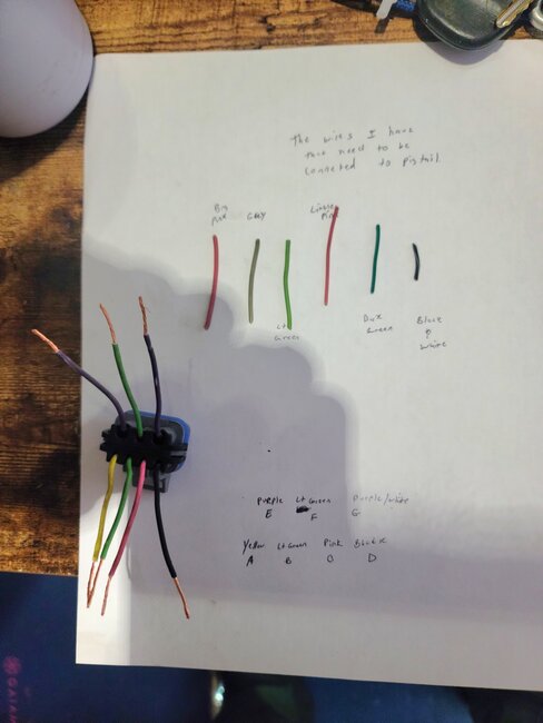

This is the best I can get it I hope you can tell me what wire goes to what location on harness.

Gotcha, here is the information you need to finish the job. Check out the images (below). Please let us know what happens.
