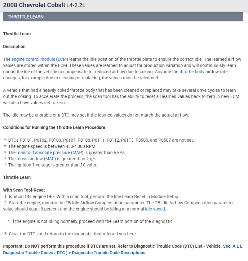

Started car, idle just fine. Drove around, sure enough check engine light came on and high here and there even at stand still when at a light intersection.
Dec 5, 2021 at 12:43 PM
SQM
  • 6,383 POSTS

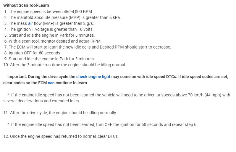

The new throttle body has to go through the re-learning process in order to function properly.
This requires specific step to be performed in specific order.
I have attached the process for both with scan tool and without scan tool.
