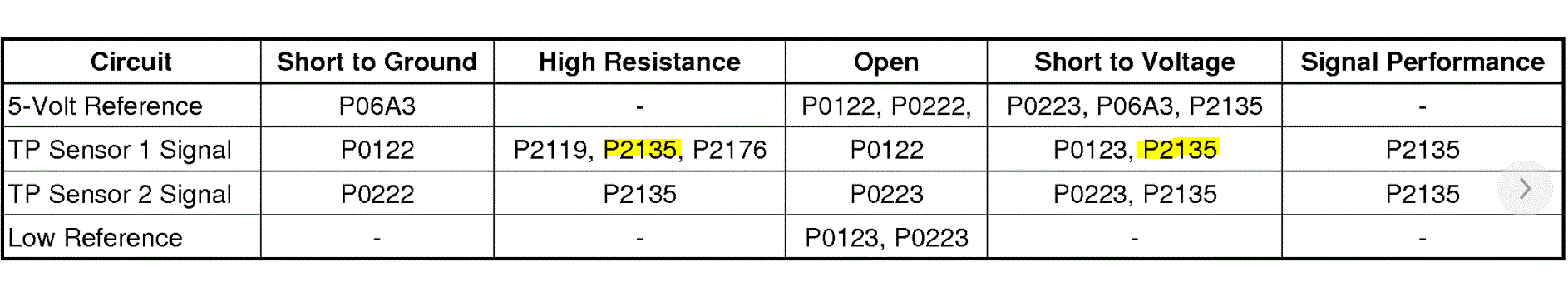

No, that isn't normal. I have a few questions. First, when the code was identified, were any additional diagnostic performed, or was the throttle body just replaced? There are wiring issues that can cause that code. For it to be set, the correlation between sensor 1 and sensor 2 has to be off at least 5% for one second. With that in mind, any intermittent voltage variation can cause the issue.
I'm not saying the throttle body isn't bad. It could be. However, there are other things to check first.
Can you tell me the following information?
1) Is the new TB a factory new part?
2) Do you know if this vehicle has variable valve timing (VVT)?
3) Was the accelerator pedal position sensor replaced with a factory part?

Like you, I find it hard to believe the TB has gone bad this many times. I'm not saying it isn't possible, but a little hard to believe.
By any chance, do you know if there were any other codes set? I'm asking because it will help us determine if there is a short, loss of power, or excessive resistance in the wiring.
If you look at the pic below, it shows other codes that may have been set. Each indicates a possible cause. For example, a P0222 along with P2135 would indicate there is excessive resistance in sensor 2 (APP). That could simply be a loose connection or corrosion in one of the connectors.
Let me know. I have the diagnostics for the code. If you feel comfortable performing the checks, I'll be happy to send them to you.
See pic below.

Thank you again! As of now the only code that’s is coming up is P2135 throttle/pedal position sensor/Switch A/ B voltage correlation. I’m taking it back to the mechanic so if any other codes come up I will put it in my next reply. I really hope it’s just a wiring issue.
