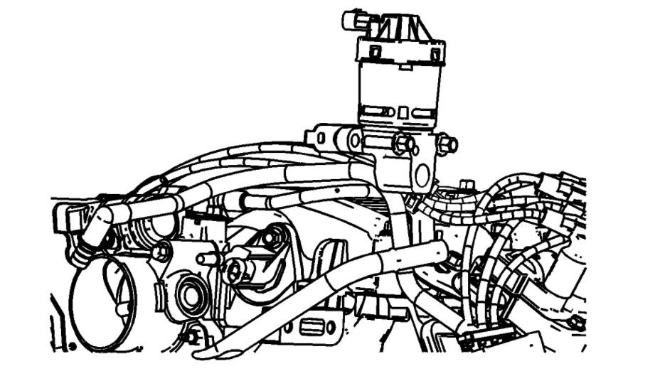

Replaced the EGR valve and I still have the engine light on and code P0401
LINDA A G
  • 2006 CHEVROLET MALIBU
  • 3.5L
  • 6 CYL
  • 578,978 MILES
I took my car listed above to get it inspected and it failed emissions and the code was P0401 which is the EGR valve. I replaced it and it still has the same problem. What can I do to fix this problem so I can get my plates renewed before I can drive it?

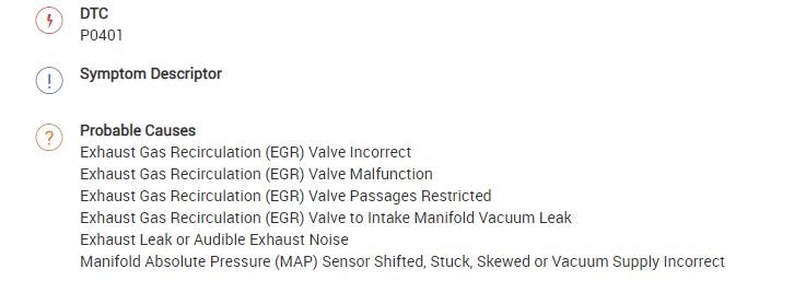

Good morning,
With the valve removed from the manifold, start the car. You should have a large exhaust leak and a heavy vacuum leak. That will confirm the passages are clear for the valve to work.
I attached the flow chart for the code for you to view.
1. Disconnect the exhaust gas recirculation (EGR) valve electrical connector.
2. Remove the EGR pipe bolt and carefully pull the pipe assembly back.
3. Remove the EGR valve bolts.
4. Remove EGR valve.
5. Remove the EGR valve gasket.
6. Clean and inspect the EGR valve gasket mating surfaces.
DTC P0401
DTC DESCRIPTOR
DTC P0401
Exhaust Gas Recirculation (EGR) Flow Insufficient

DIAGNOSTIC AIDS
Inspect for the following conditions:
- A vacuum restriction to the MAP sensor-A skewed MAP sensor reading can cause the PCM to read incorrect MAP changes during the EGR flow test.
- An engine that is running poorly due to a mechanical condition, such as worn piston rings, worn camshaft, etc.-These types of conditions can cause low engine vacuum and thus can cause a less than expected MAP change during the flow test.
- Excessive back pressure in the exhaust system may cause this DTC to set. This condition can cause low engine vacuum and thus can cause a less than expected MAP change during the EGR flow test. Possible causes of this could be a restriction in the exhaust system or non original equipment manufacture (OEM) exhaust parts.
- Exhaust system leaks can cause an insufficient amount of EGR flow through the EGR valve. This condition can cause a less than expected MAP change due to insufficient exhaust back pressure. Possible causes of this could be a leaking exhaust system, a leaking EGR pipe or non-OEM exhaust parts.
- A restriction in the intake manifold such as carbon deposits and casting flash

1. Test the MAP sensor for being shifted, stuck, skewed, and for correct vacuum supply. Refer to Manifold Absolute Pressure (MAP) Sensor Diagnosis. See: Computers and Control Systems > Component Tests and General Diagnostics > Manifold Absolute Pressure (MAP) Sensor Diagnosis
2. Inspect for a vacuum leak between the EGR valve and the intake manifold.
3. Inspect the exhaust system for leaks, restrictions, and for modification of OEM parts.
4. Remove the EGR valve and inspect for the following:
- Cracks
- Heat distress
- Pintle for corrosion
- EGR valve passages for restriction
- EGR passage in the intake manifold for carbon buildup, casting flash, or other restriction
- If a restriction is identified, refer to Exhaust Gas Recirculation (EGR) System Cleaning.
- If a condition with the EGR valve is identified, replace the EGR valve.

I have put a new EGR valve on the car and it was all good until I went 15 miles to the inspection shop and then it started doing it again.
Monday, March 22nd, 2021 AT 10:16 AM
  • 52,797 POSTS
You need to do the test I described. The valve was not the issue. There is another issue.
