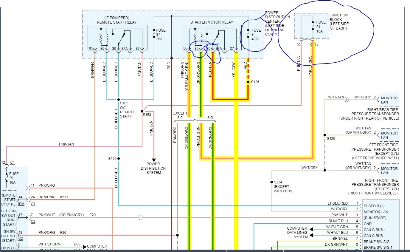

I attached a wiring diagram for you to view. Check both fuses I circled for power on both sides with the key on.
Then test terminals 30 and 85 for power at the relay.
