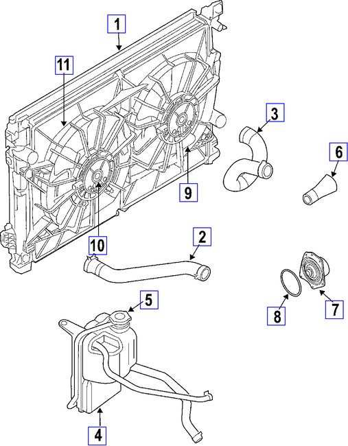

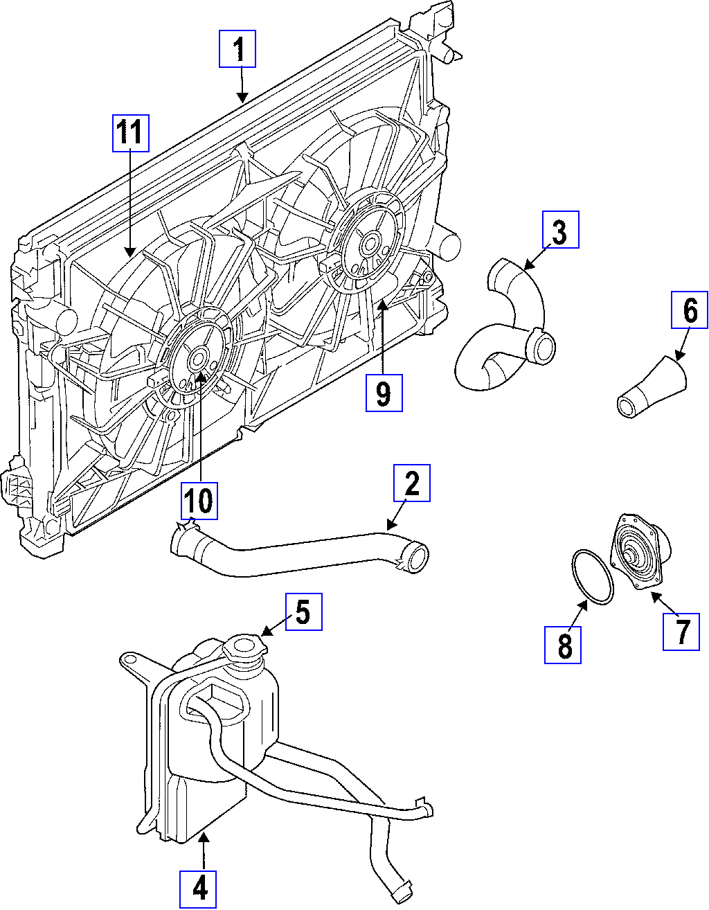

Now, the coolant leak has me concerned. Mostly, you have the upper radiator hose, heater hoses, and I believe the overflow reservoir to check. Here is what I suggest. Read through these links. They show how to pressure test a cooling system and repair leaks. It does require a tool to pressurize the system when the system is cold. However, most parts stores will lend or rent one.
https://www.2carpros.com/articles/radiator-pressure-test
https://www.2carpros.com/articles/car-is-leaking-coolant
The tough thing about a coolant leak is locating where it is located. Coolant can run in all different directions and come out in a place not even near the leak location. That is why I suggest pressure testing. Since it leaked when you lifted the vehicle, I have a feeling it puddled somewhere and started running when you put the vehicle on a tilt. Keep in mind, it is not uncommon for the radiator to leak around the plastic tanks. What happens is the crimps that hold everything together get loose and begin leaking. Also, it is not uncommon for a plastic tank to crack. I mention these things because I need you to look in those places too.
Let me know if you find it. Also, please feel free to ask any questions you have. I am anxious to hear what you find. I attached an exploded view of the radiator and hoses from it. Hopefully it will be helpful.

Okay, so it looks like I have a leak in the radiator. I was going to repeat that burping procedure to see if I could tell where the antifreeze was spraying from. And I was just letting the car run for a bit to get warm. I looked out before I had even jacked the car up and saw a puddle of coolant on the ground. When I looked under, the drips were either out of, or from around the outside of the drain hose, and looks like a second drip from to the side and a little above that. Not sure if it is one leak draining over towards the hose or two leaks.
I want to try some stop leak before replacing the radiator. There is no other cap hiding anywhere right, except for on top of the reservoir? I take it I pour right in there? Some older cars have a cap right on top and the fill tank is separate with just a little pull up cap.
Also, I guess I read wrong when I thought up to $1,400.00 for getting just a check for blown head gasket, it was up to $140.00 right? Would sounds maybe a lot better, lol. Would there be a problem with using a pour in fix, like Steel Seal head gasket repair, to make sure, if the gasket is not actually blown?

It could be the radiator or the hose. The only way to be sure is by removing the hose and inspecting both the hose and radiator or pressurizing the system to see if you can tell where it is coming from. As far as the stop leak, I really do not link it, but many people use it and it works. However, I have seen situations where it has plugged the heater core.
