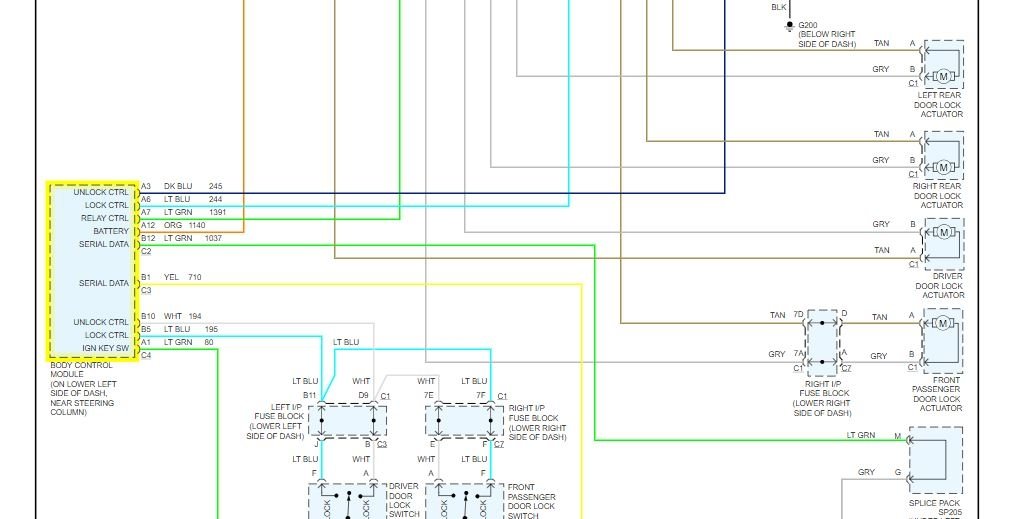

Starts and shuts off. replaced PCM starts and runs battery/ABS/airbag light on widows/locks no work on lights inside.

Did all the options work before you replaced the ECM?
Did you replace the BCM as well? If you did, was it programmed to your truck after installation?
As far as the lights, did you have it scanned for any codes?
https://www.2carpros.com/articles/abs-warning-light-on-easy-repair-guide
Both are controlled by the BCM. That is why I was asking about the programming.
Feb 18, 2021 at 4:41 AM
BOBBODINE
no did not work. it starts and shuts off. no communication so i replaced PCM with a reprogrammed and it started and runs so i replaced the BCM with a reprogrammed one relearn key starts and runs, but no gauge and no interior power or widows/locks battery /ABS/airbag lights on. scan tool error link.
Okay, do you have a scan tool that can access the BCM?
The BCM has to be programmed on the vehicle with the proper programming equipment.
I know places sell them that are pre programmed but they are not always right.
I posted below the steps for the programming.
