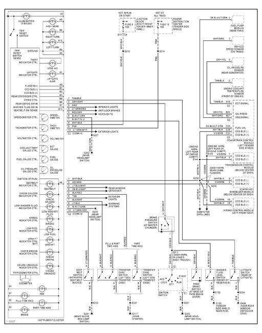

replaced heater core now gauges dont work correctly
1999 JEEP CHEROKEE
264,000 MILES
K07032004
engine runs fine but gauges come on for a second the tach dies after a few seconds and the other gauges don't read correctly when I turn the light on all the gauges die and the turn signal indicator lights both come on and stay on I have checked connections and fuses and still no luck

JUST FOR GIGGLES, HAVE YOUR BATTERY TESTED AT A POPULAR AUTO PARTS STORE.....THIS IS USUALLY A FREE SERVICE........NOTHING LIKE SOMETHING TOTALLY UNRELATED MESSING YOU UP
......SOMETIMES, JUST DISCONNECTING IT MIGHT RESET STUFF
YOU MAY NOT HAVE GOT A GROUND BACK IN PLACE, OR TIGHT
WITHOUT CORRECT NOMENCLATURE AND ENGINE SIZE.......I JUST GUESSED, AND GRABBED THIS DIAGRAM OUT OF "MITCHELL I"
THIS ONE IS "INSTRUMENTS" FOR A '99 CHEROKEE LIMITED (CORRECT ME IF I GUESSED WRONG....I HAD 4 CHOICES ON MODEL) SOMETIMES THE "COMMON STUFF" DIAGRAMS ARE THE SAME DIAGRAM AS FOR THE OTHER MODELS
LOOK FOR THE "GROUNDS" IN THE DIAGRAM.......NORMALLY A LOCATION IS GIVEN FOR THEM
LEMME KNOW THE DEAL
