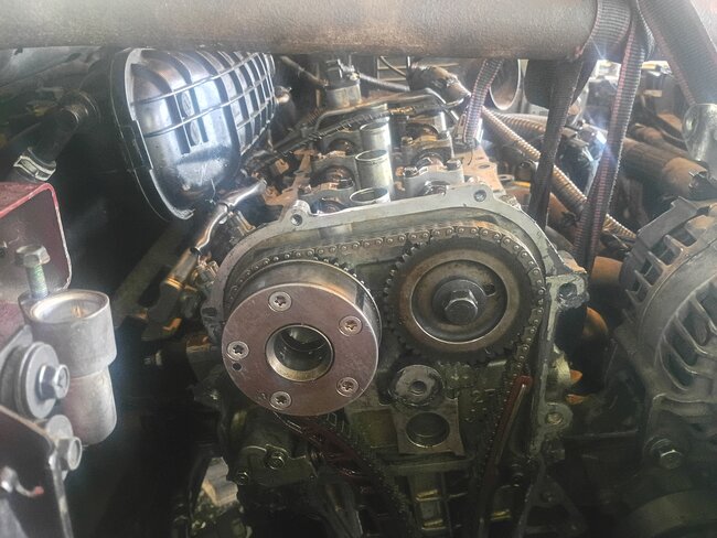

So this is the issue I keep running into I can put this thing on the marks 100 times and rotate the motor over by hand and it will never line back up on the marks on the chain not one time has it got done that for me on either side and I don't see the chain slipping anywhere but I'm getting real aggravated I've been messing with this thing for 2 weeks now and I can line my marks up but the the f****** blue and the two blue links and the orange link will never line back up on those marks but I can be lined up on Mark's on my sprockets but not on my chain That makes any sense The chain will never line back up and if the chains if I put the chain back on the marks as you can see in this picture I just sent then the sprockets or not lined up

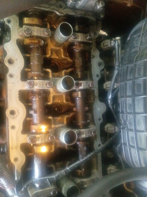

And okay when you say the you can say that you say that I can tell when the valve cover is off which it is that I can tell if the valves are bent but I don't I don't understand what I would be looking at as far as to tell exactly what you're saying there I don't I basically I don't I don't know how to I don't know what I'm looking at so I'll send you a picture of what the cancel look like when they're on their marks right now

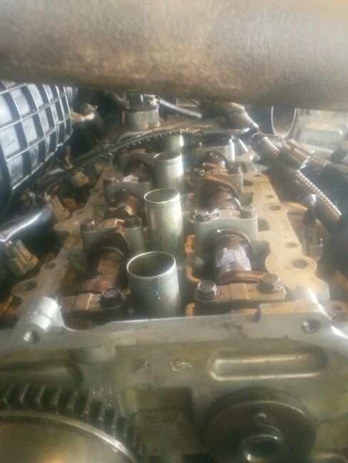

These are the best pictures I can give you a

I mean basically the cams look I mean identical as far as the way they're low down I mean of course opposite of each other in the way they rolled over is you know the exhaust side is would be identical to the intake side except you know reversed or upside down you know so the two loaves in the middle that are up those loads will be down on the on the other cam so everything I mean to me everything looks cam-wise looks correct and I could be wrong cuz that's not that's way out of my expertise there but I'm almost hoping you'll just that what you just said about the vent valves is what it is and I can just be done with this thing and price wise it seems just as feasible to put a whole motor in versus putting doing the head so

Okay, so first the mark will never line up again once the chain is installed, the only way to check the marks is to remove the chain and try it again. Next in this engine you cannot tell if the valves are bent from the top unless you look for play between the camshaft and the valve spring cap once the cam lobe is completely away from the valve cap. Thanks for the images.

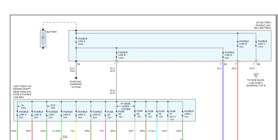

Okay so didn't start but it definitely tried to start so improvement but new issue I have no power to any of the fuses inside the cab but all my dash lights come on radio comes on and everything seems no more but I checked everything with my test light and I couldn't get anything on any of the fuses inside I don't know if that would might I don't know if that would keep anything in there will keep it from starting but I'm just curious why don't have power there now when I did before I get some gas I will put some gas in it cuz it's flashing it 25 mph or 25 miles left so I don't know if there's any gas in it or not engage says there's not but I don't have any brakes on here to to start on that either so I'm determined for this to run I've got too much time and too much time and money in it now that has to run

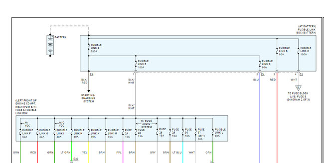

Yep, I would put some gas in it and check the fusible links in the main power fuse panel under the hood. Check out the images (below). Please let me know what happens.

Hey what's up sorry I didn't get back to you yesterday I didn't mess with the car yesterday I broke my foot like last week and I just had to get off of it for day but so I got gas in it and it actually I mean it acts like it wants to start but it's not like a good one to start but at least is is trying to attempt to maybe I'm thinking maybe put a mini put some oil down the cylinders again since it's set for a while maybe it'll get better compression maybe I haven't even looked it I forgot about the fuses till I just read your thing but that's my downfall right there is the wiring and understanding what I'm looking at on that diagram but I just get lost in the wiring thing but it's still tried to it's still I say it's I'll see if I can send a video on here I'll go out there in a minute and see if I can record it I don't know if you able to tell not but I'll see if I can record it and if you can hear it I'll send that here shortly probably easiest thing to do
