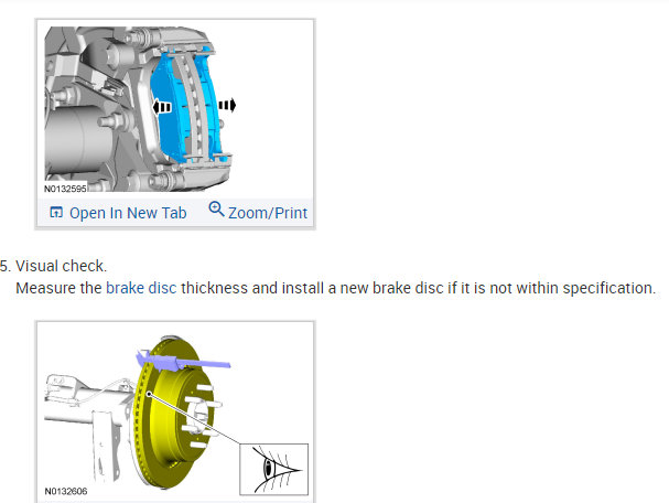

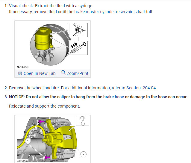

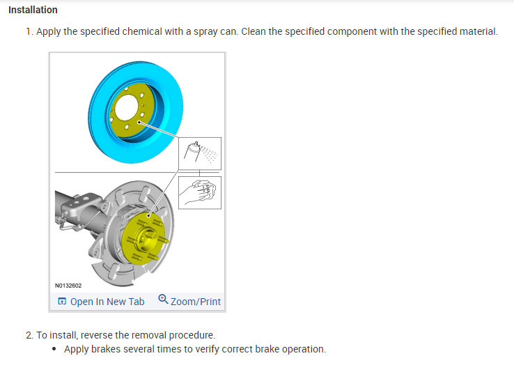

After replacement of the front brake that was clearly the one needing replacement I now have two rear grinding brakes. With a squeal even when not braking. Help!
Jul 25, 2019 at 4:46 PM
DANNY L
  • 5,648 POSTS
Hello, I'm Danny.

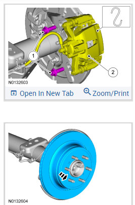

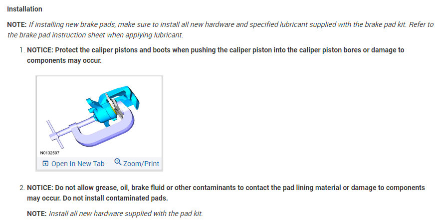

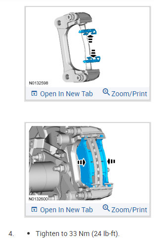

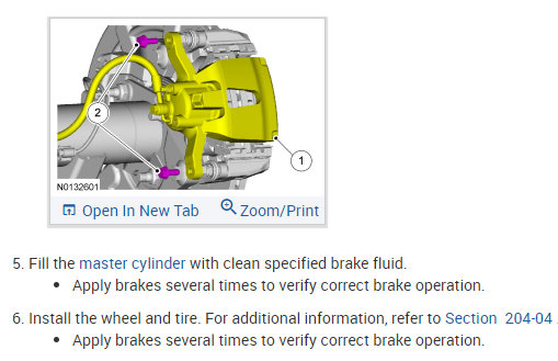

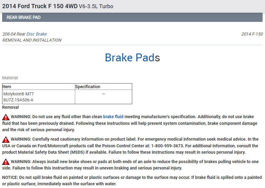

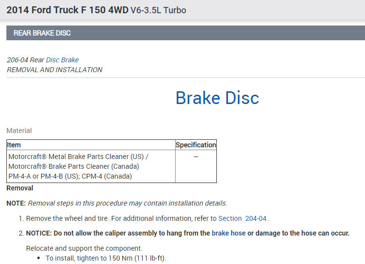

Here is the information you requested. Here is a tutorial on how to remove and replace rear brake pads and rotors:
https://www.2carpros.com/articles/how-to-replace-rear-brake-pads-and-rotors
Here is a YouTube video from our site on how to compress the rear caliper piston when performing a rear brake job:
https://youtu.be/j8YwfSKEzZo
I've attached picture steps below on how to replace the brake pads on your truck. Hope this helps and thanks for using 2CarPros.
