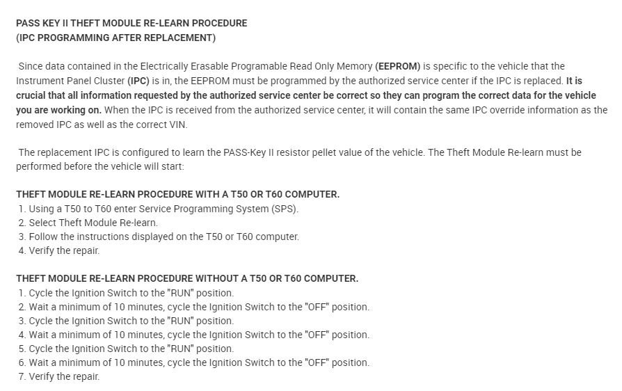

i replaced the dash cluster on my car now the theft system light came on and the car wont start.

Good morning,
Try this guide for resetting the security:
https://www.2carpros.com/articles/how-to-reset-a-security-system
Image (Click to enlarge)
