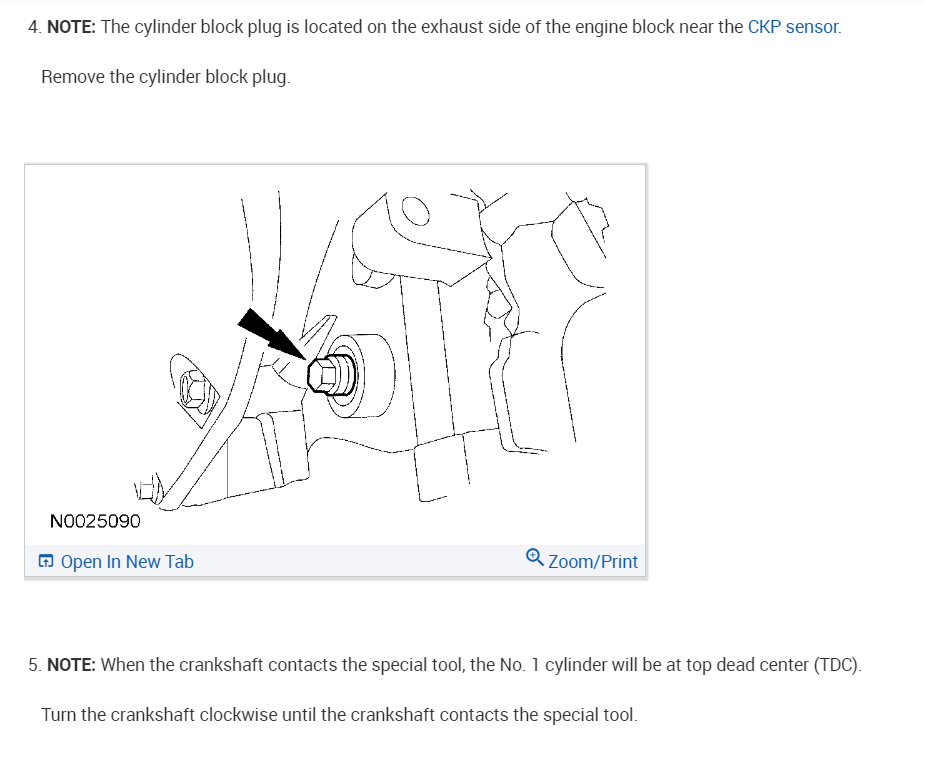

After replacing the crankshaft position sensor, the engine will not stay running?
2008 FORD FOCUS
246,000 MILES • 2.0L • 4 CYL • 2WD • AUTOMATIC
FRANKOJOE4

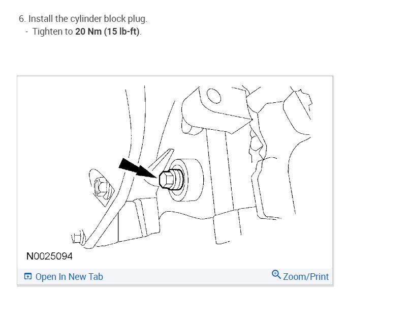

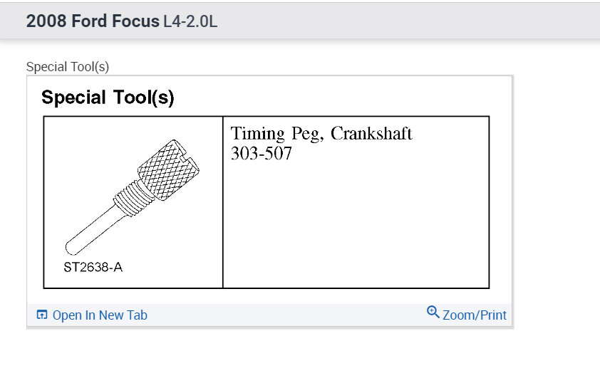

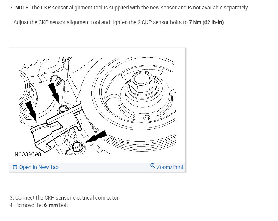

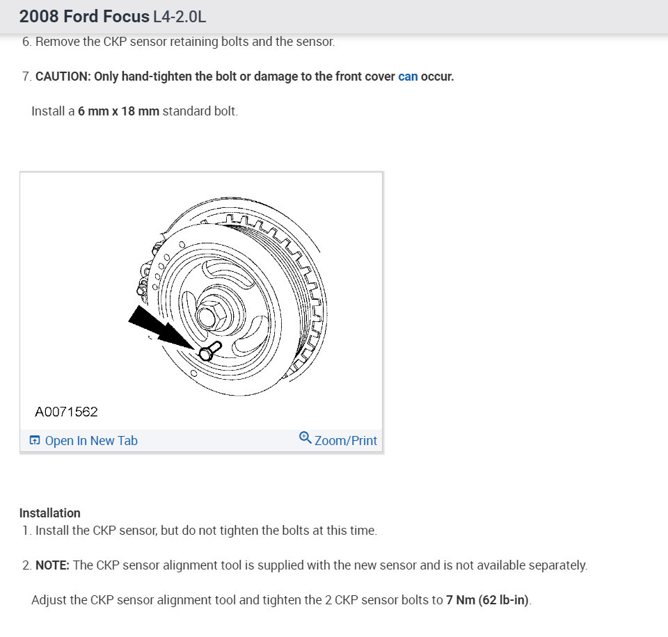

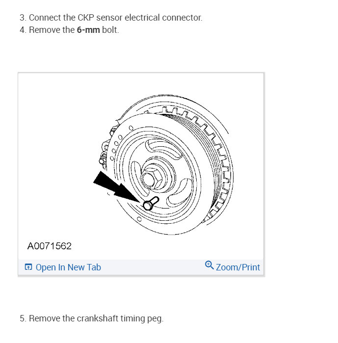

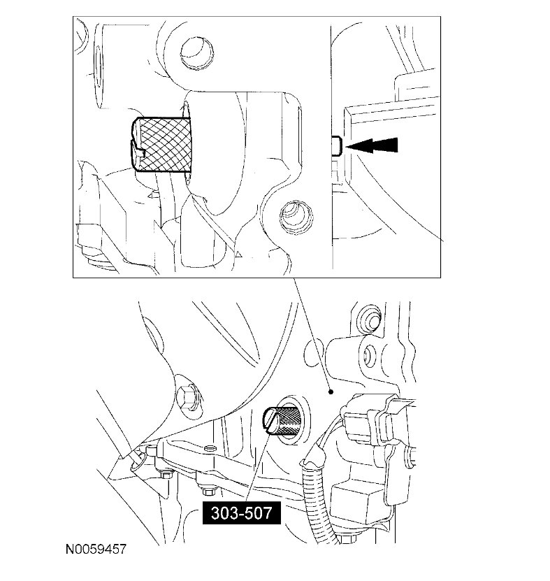

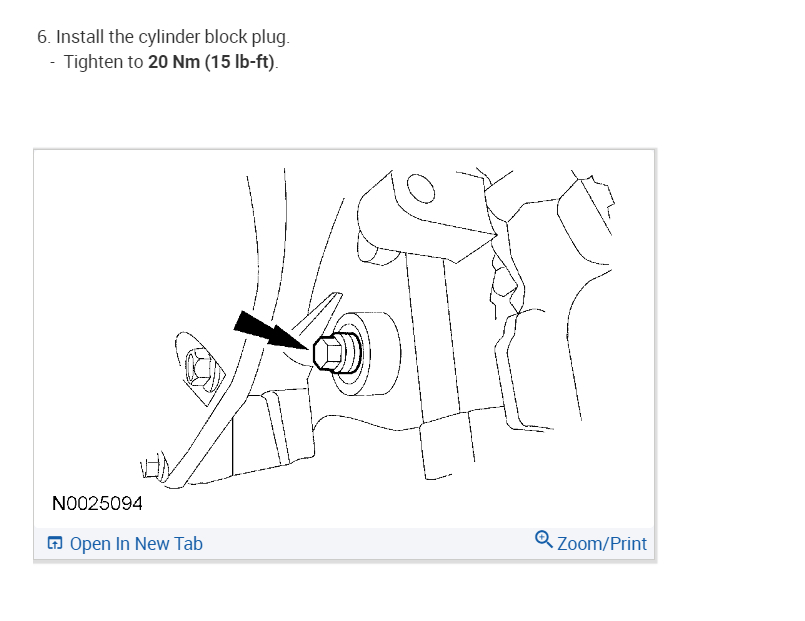

put a new crankshaft position sensor on and the car starts and shuts off right away.
Jan 28, 2023 at 11:41 AM
  • 55,423 POSTS

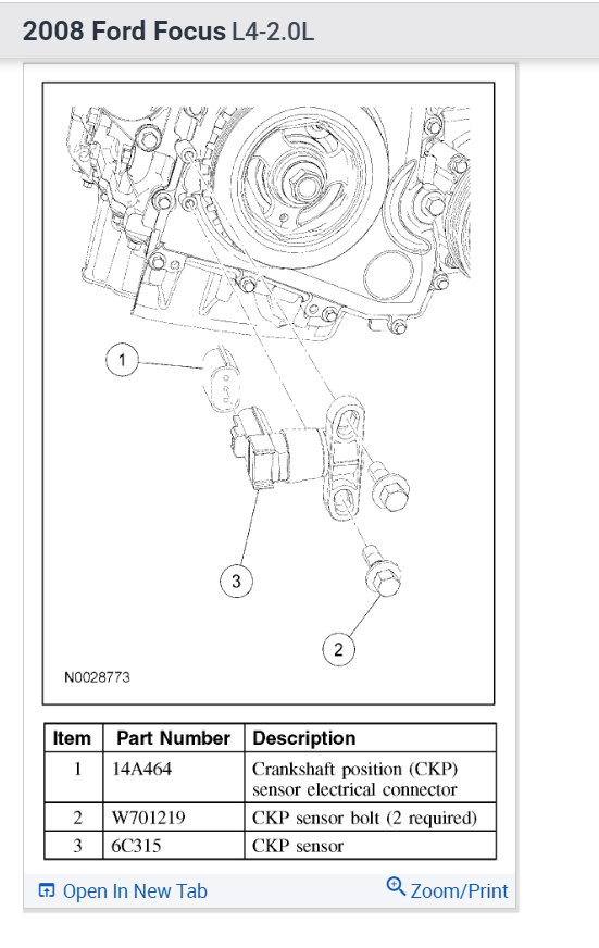

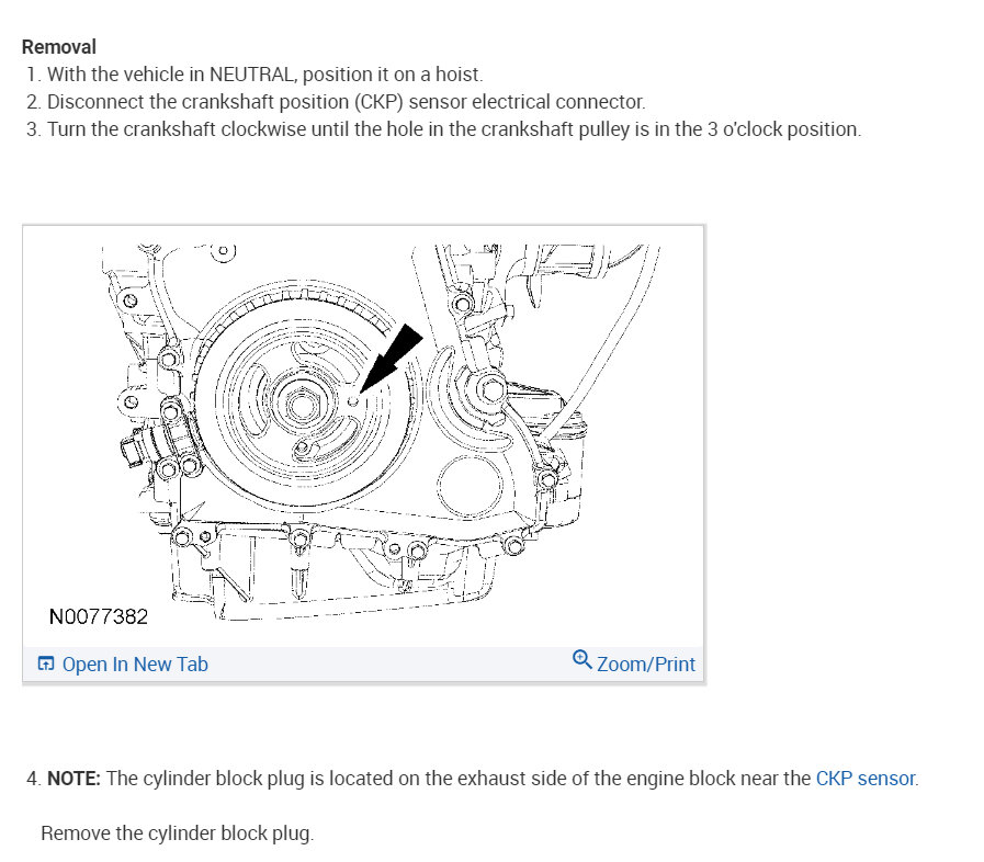

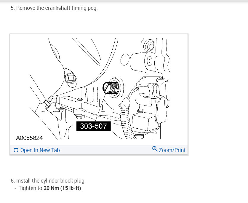

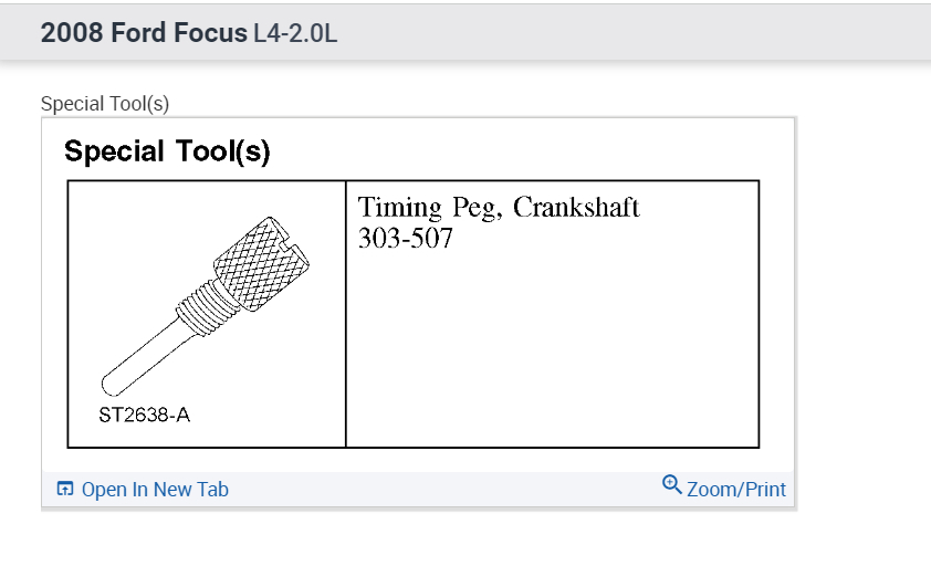

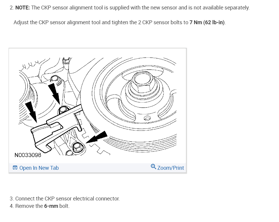

Apparently, the engine needs to be at top dead center for the new crankshaft sensor to be installed for learning purposes. You could have a defective sensor as well here are the instructions and special tool needed to do the job. Check out the images (below). Please let us know if you need anything else to get the problem fixed.
