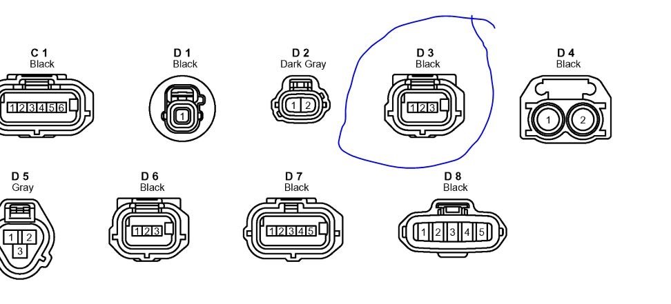

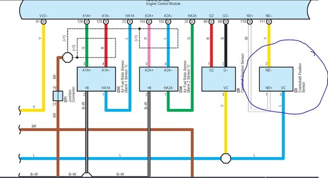

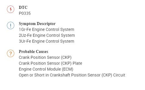

P0335 was the code. I took out the new sensor and put back in the old one and now it will crank, but is still giving the same code.
Jun 14, 2020 at 7:23 AM
Okay, if it runs with the old sensor, then you have a bad new sensor.
I would get an OEM sensor as it may not be up to quality at all. Very common.
I attached possibilities for you.
