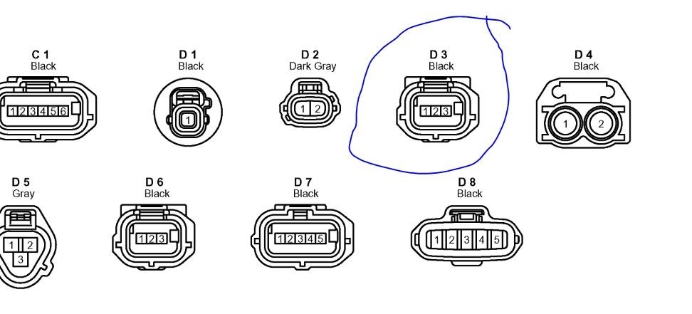

I replaced the crankshaft position sensor because I got a code saying it was bad and had trouble starting a few times but after I replaced the sensor it will not start at all. I did disconnect the negative battery terminal before I replace the sensor. Would that have caused a problem?

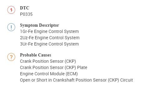

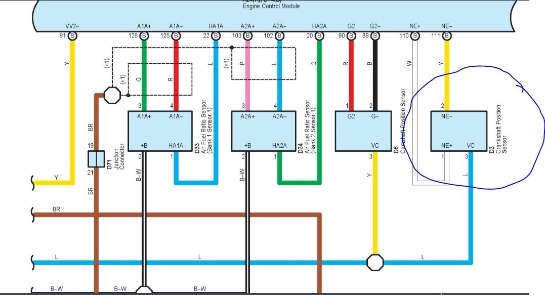

Good afternoon,
What was the code that was set? It is rare that a code identifies a bad part, it identifies a failed system.
https://www.2carpros.com/articles/how-a-crank-shaft-angle-sensor-works
When you crank the engine, does the tachometer move up a little and show RPM? That will tell me if the sensor is sending a signal to the ECM.

P0335 was the code. I took out the new sensor and put back in the old one and now it will crank, but is still giving the same code.

  • 52,797 POSTS
Okay, if it runs with the old sensor, then you have a bad new sensor.
I would get an OEM sensor as it may not be up to quality at all. Very common.
I attached possibilities for you.
