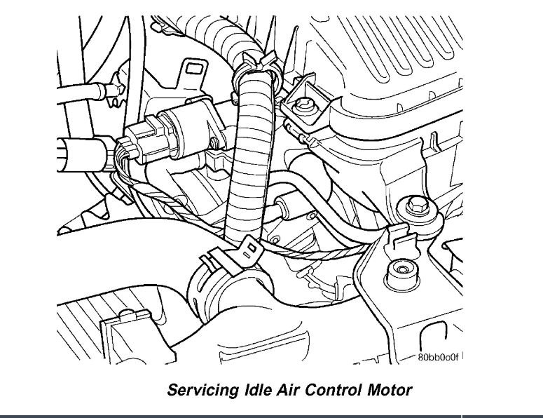

Replaced MAP sensor and TPS.. now wont even stay idling weather hot or cold. new code for IAC malfunction, but i replaced that 3 weeks ago and fixed itself for a bit.

Everything working now. clogged air valve.. but now when i start it it idles fine for 3 seconds then raises to 1,500/2,000 rpm's. i replaced IAC 3 weeks ago so it shouldn't be that. no engine light.
Jan 1, 2020 at 6:39 AM
Pull off the wires to the IAC and see if the idle is normal. What valve was clogged?
