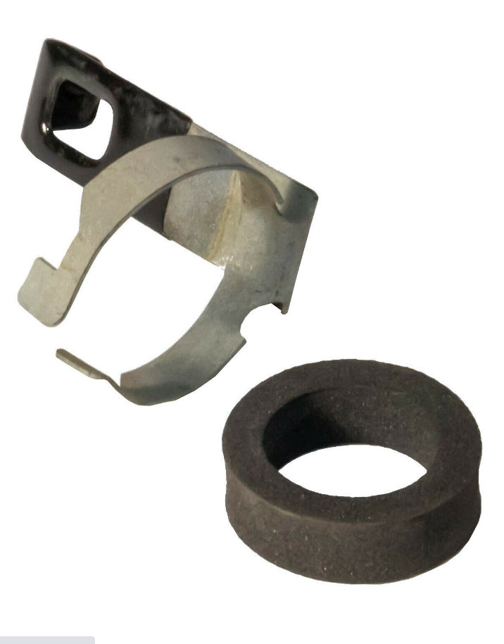

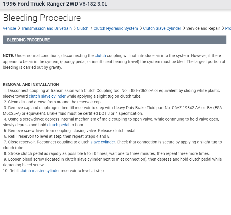

My clutch line popped out so I replaced the line. After installing I had bleed the system and got pressure. After I got pressure the line popped out again. Needles to say every thing is good, but one problem the clip that holds the line in to the slave is bad. So I called around to see if I can get a clip only one problem no one sells the clip with out getting the slave cylinder and I do not need the slave cylinder. So I am looking for an alternative.

If you are looking for retaining clip (look at picture below), those are available through online vendors. You can typically find them in eBay or Amazon.

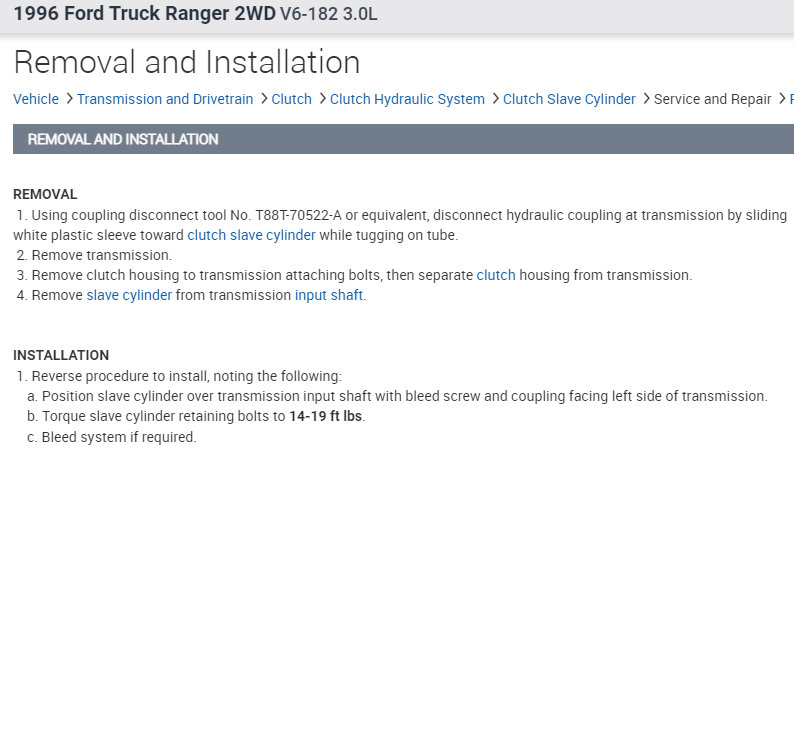

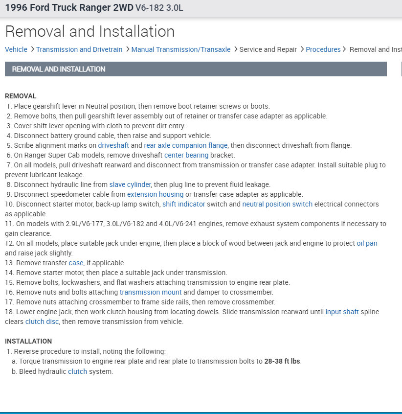

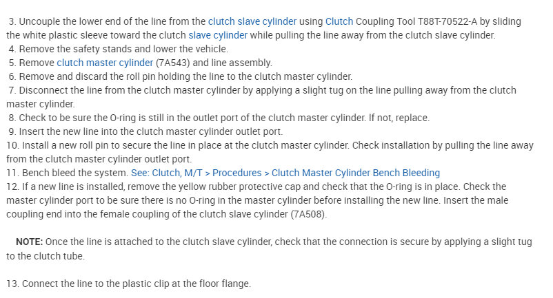

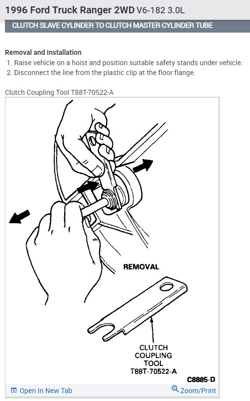

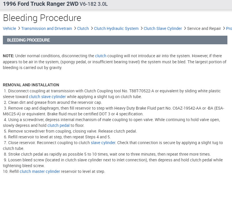

I have attached the slave cylinder replacement procedure below
https://www.2carpros.com/articles/clutch-doesnt-work-sometimes-or-not-at-all
