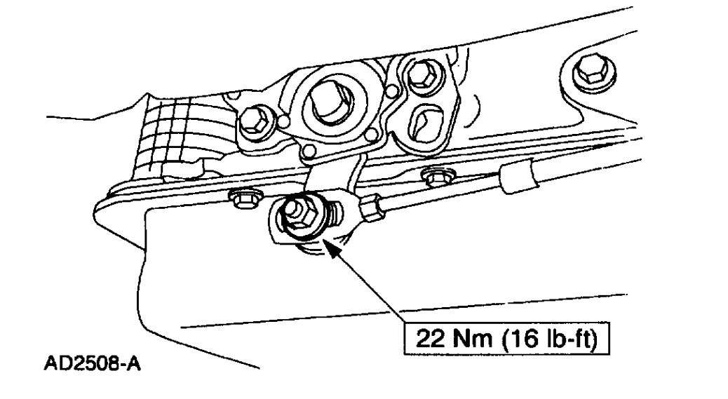

Well, then your reading is wrong on the battery.
Below is the procedure for adjusting the transmission shift cable. You need to do this for it to start in park and neutral.
Cable Adjustment
1. NOTE: Make sure that the range selector lever is tight against the rearward overdrive stop.
Place the transmission range selector lever in the overdrive position.
2. Raise and support the vehicle.
3. Loosen the manual control lever nut.
4. Place the transmission manual control lever in the overdrive position.
5. Tighten the nut on the manual control lever.
Apr 29, 2019 at 9:06 AM

Underneath the car. Anyway thanks again!
Sheryl
May 1, 2019 at 9:25 PM
Yes, under the car
