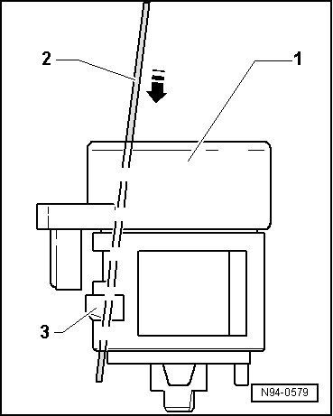

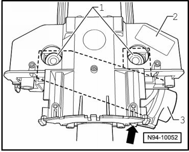

I am going to provide the directions for removal and replacement of the switch. Look through the directions to confirm you did what it requires and let me know.
The attached pics correlate with the directions.

- Unlock the ignition switch with a small screwdriver - arrows -.
- Remove the ignition switch - 1 - from the steering lock housing.

- Install the ignition switch in the steering lock housing until it audibly latches.
- Insert ignition key into lock cylinder and turn into position "Drive".
pic 2
Key must be located in "Drive" position.

Here are the directions for the key tumbler:
____________________________________________
2008 Volkswagen Jetta GLI (1K2) L4-2.0L Turbo (CBFA)
Lock Cylinder
Vehicle Starting and Charging Sensors and Switches - Starting and Charging Ignition Switch Service and Repair Removal and Replacement Ignition Switch and Lock Cylinder, through 05.10 Lock Cylinder
LOCK CYLINDER
Lock Cylinder
When disconnecting and connecting the Battery, the procedure must be followed as described in the repair information. Refer to=> [ Battery, Disconnecting and Connecting ] .
Steering lock may be destroyed.
If steering lock is operated without lock cylinder, it locks and must be replaced.
Steering lock must not be operated without lock cylinder.

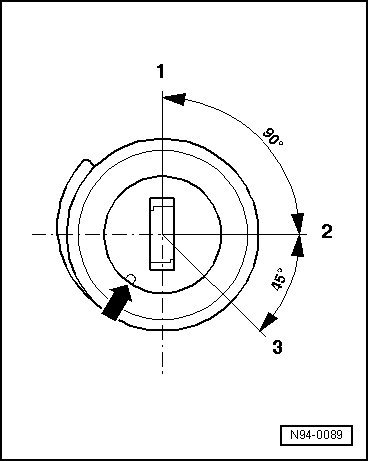

pic 2
Key positions of lock cylinder:
1. Position Off
2. Position Run
3. Position Start
For reasons of clarity, the following illustration depicts lock cylinder as removed and without ignition key.
pic 3

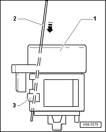

- Insert steel wire (1.2 mm diameter) into hole next to ignition key - arrow -.
- Using the steel wire - 2 -, release - arrow - the retaining lever - 3 - of the lock cylinder - 1 -.
- Remove the lock cylinder - 1 - from the steering lock housing.

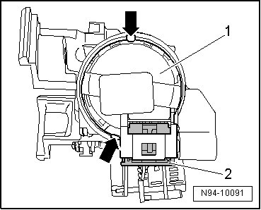

Installation
pic 4
To improve clarity, the ignition key is not shown in the following illustration.
- Insert the ignition key into the lock cylinder - 1 - and turn to the "Drive" position.
- Use the steel wire - 2 - to release the securing lever - 3 - of the lock cylinder - 1 - - arrow -.
- Insert the lock cylinder - 1 - into the steering lock housing.
The Anti-Theft Immobilizer Reader Coil (D2) connection must be inserted into the guide on the steering lock housing.
- Remove the steel wire - 2 - from the lock cylinder - 1 - and then make sure the lock cylinder fit securely in the steering lock housing.
