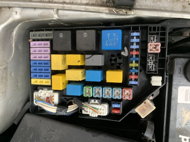

I've attached an image of the fuse box under the hood. I know the small ones are fuses. Are the large blocks (black, blue, yellow, and gray) relays?
I tested the fuses related to functions not working for power using a test light and found that the 15A ROOM LP fuse was not receiving power. I swapped it out for a new fuse, but it still received no power.

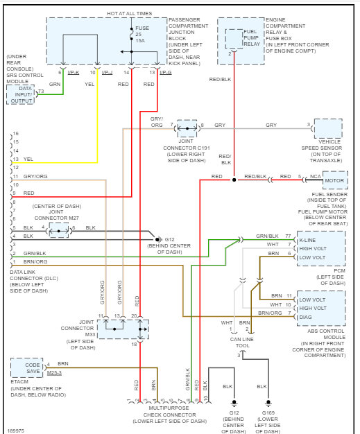

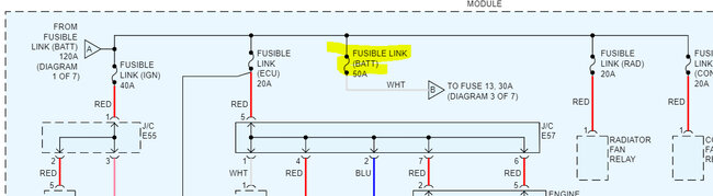

Okay, I had to trace the wiring schematics to locate the power supplies. Ugh LOL I assume the fuse you indicated having no power is in the passenger compartment.
Also, you are correct about the relays.

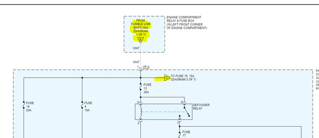

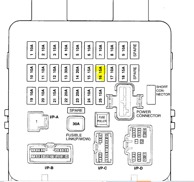

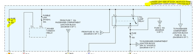

Now, to get power to the fuse you mentioned, three other fuses or fusible links need to be good. So, I need you to follow this path when checking for power so we can determine where it is lost.
In the passenger compartment fuse box, check fuse 16 for power (pic 1). It allows power to reach the fuse you mentioned.

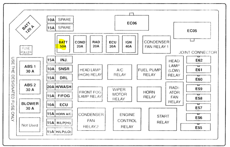

If fuse 16 doesn't have power, there is a 50-amp fuse in the under-hood fuse box that needs to be checked. (Pic 2 and 3)
If there is no power, then it goes straight back to the battery, so we will need to do things differently at that point (see pic 3).
Remember, when you check for power, it needs to be present on both sides of the fuse when the fuse is connected.
Let me know what you find.
See pics below. Pics 4 and 5 show the fuses I mentioned.

No problem whatsoever. If you still have no power to fuse 15, check fuse 13 in the same box. If it has power, then we have an open circuit between the supply and fuse 15. To confirm there isn't an issue before this point, check fuses 4 and 14 for power. They too should have it.
Also, check fuse 25 under the dash. Interestingly, the standard for a power supply on the DLC is to pin 16. On this vehicle, it is pin 9. The power to it is from fuse 25. See pic below.
See pic below.
