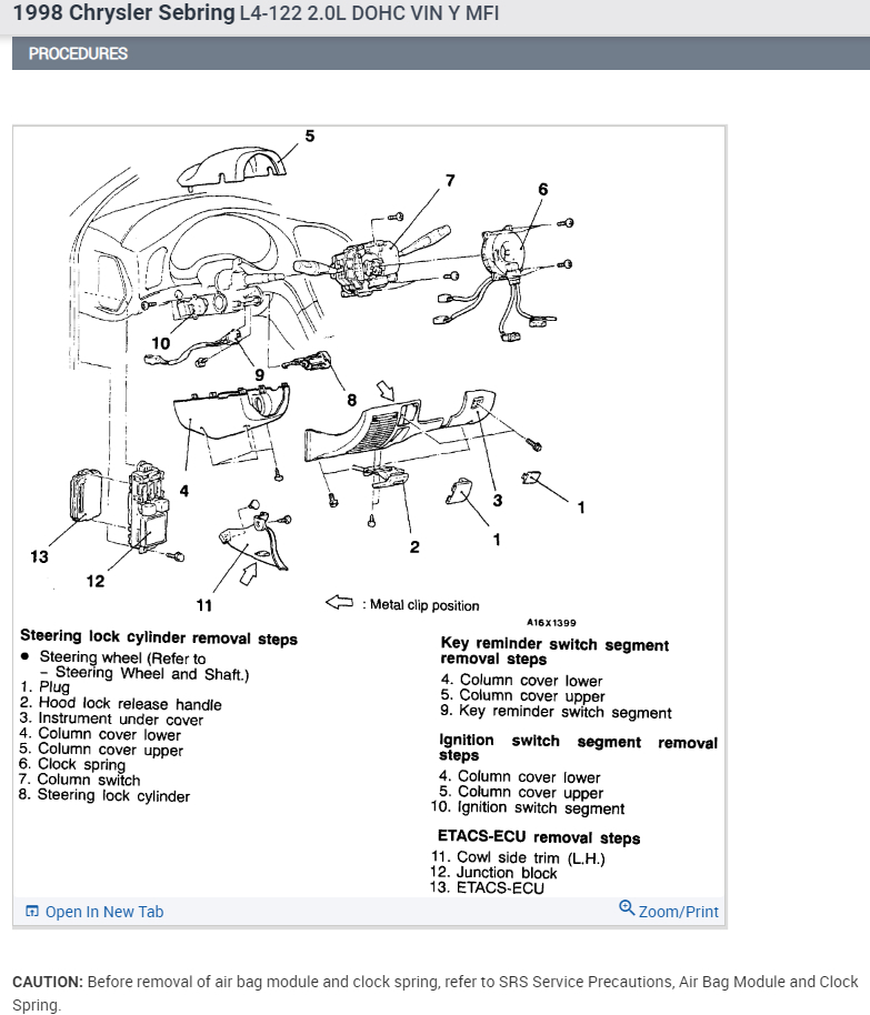

I am having a no start issue with my car listed above convertible JXi. Key and key fob work to lock and unlock car. Security light isn't on, but the car won't even crank. I have power to everything but no start. Any help is useful and appreciated.
Nov 6, 2022 at 7:41 AM
SQM
  • 6,383 POSTS

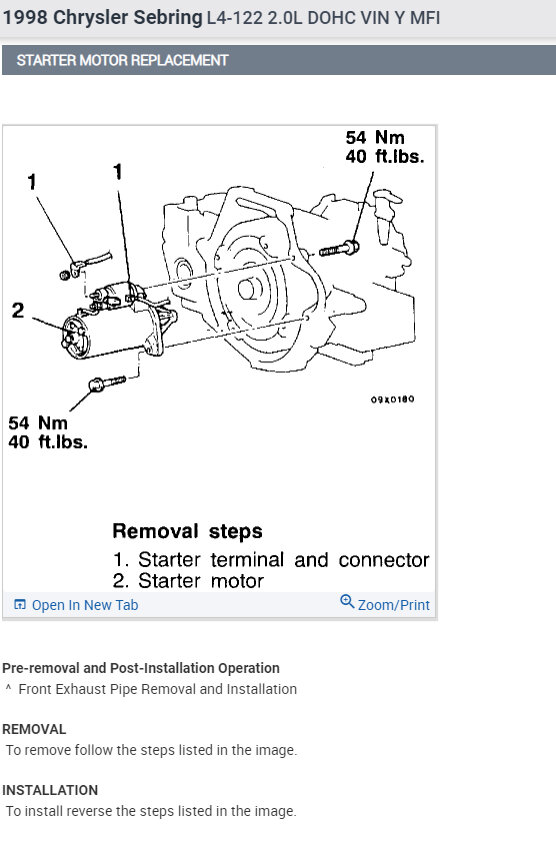

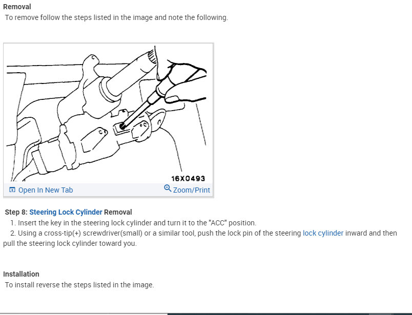

When you try to start the engine, are you getting any noise?
Does the starter click?
If the starter clicks it could be a bad starter solenoid.
If it is not making any noise, it could be worn ignition switch. Usually when the ignition switch is bad or worn. When the key gets turned to the start position, it will make dash go blank.
Take a look at this helpful guide:
Let me know if you have any questions.
