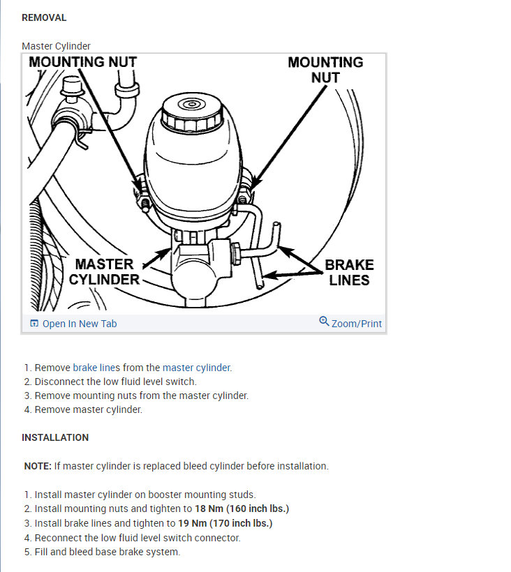

After replacing all the pads, front and rear, front and rear brake lines, master cylinder, and rear calipers. I still don't have back brakes.

At this point you need to remove line from the master cylinder cap the ports and press the pedal. If the master cylinder was bench bled then it should be a hard pedal as it is the only thing in the system if there are no lines. I didn’t mention it but if you didn’t bench bled the master then that is the issue I suspect. You will just push and pull air and not get much pressure.
Assume you have a hard pedal with no lines on the master, add them back on one at a time until it is soft again. Once it’s soft you know what area the problem is in.
If the pedal is soft with no lines on the master it is either air if you didn’t bench bled it or a faulty master cylinder.
