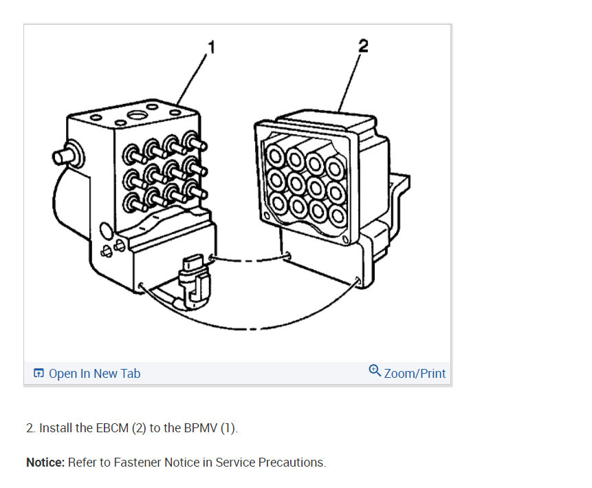

My ABS, Brake, Traction lights would come on occasionally. As I have a second 2001 Deville that doesn't have any issues with the ABS, I took the ABS control module off and put it on the Deville that was getting the intermittent ABS Brake Traction warnings.

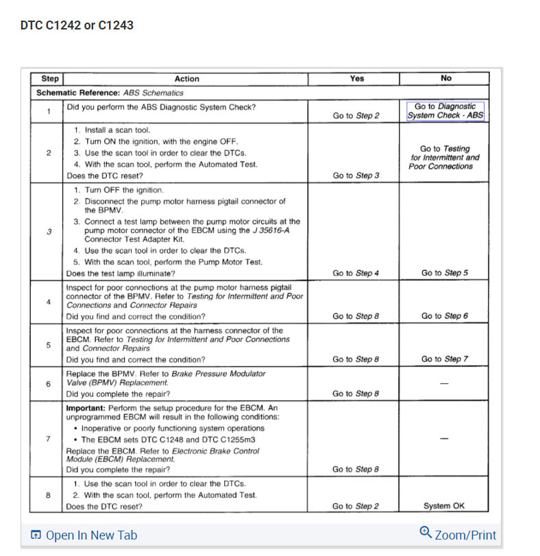

After replacing the module, I now get the ABS and Traction Warnings plus "Service stability System" readout. Running the codes I get:
ABS C1242 Current
ABS C1282 Current
ABS C1284 Current
ABS C1285 Current
ABS C1287 Current
ABS C1288 Current
I try to clear the codes but they don’t clear.

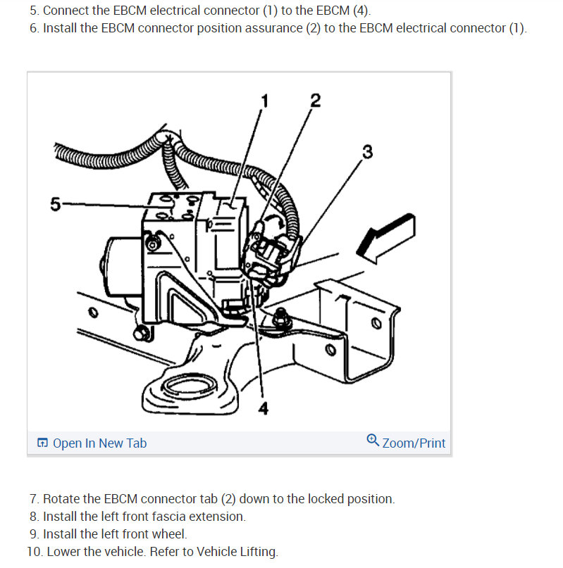

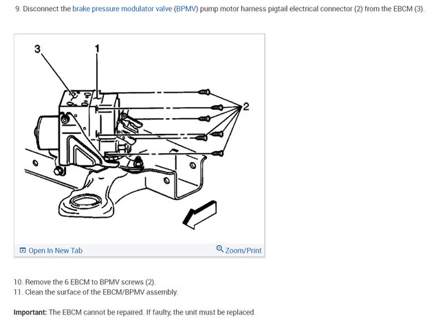

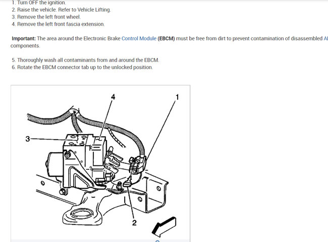

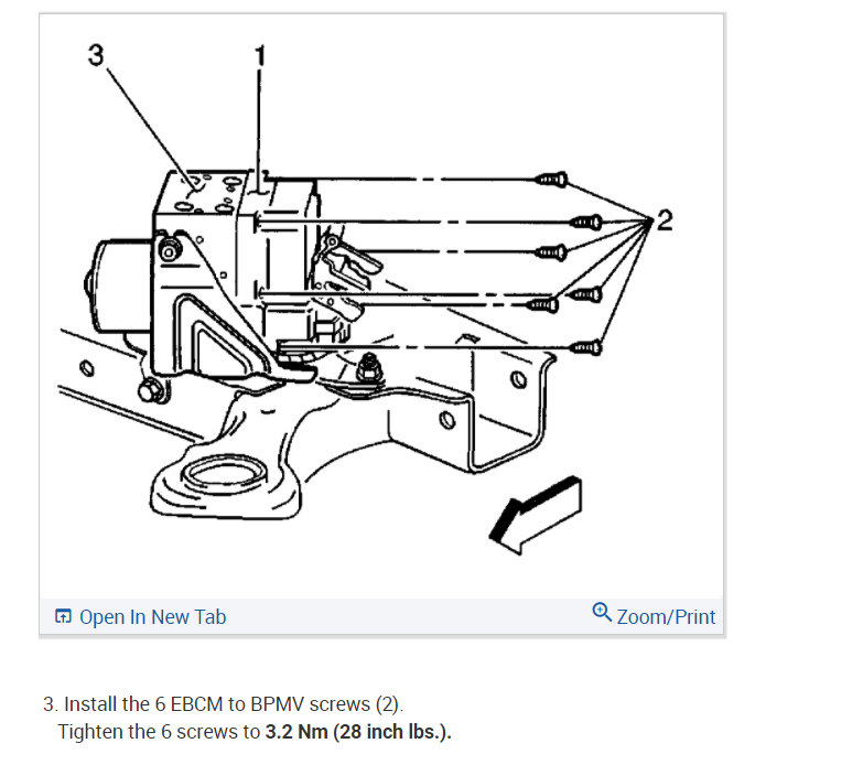

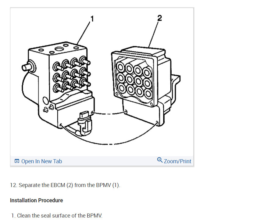

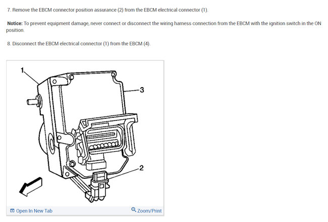

You cannot just swap modules like this. The one you installed must be the exact part number and then it must be programmed to your VIN number in order to function.
https://www.2carpros.com/articles/how-to-replace-a-abs-controller
You can have a shop with the proper scan tool perform this for you or the dealer.

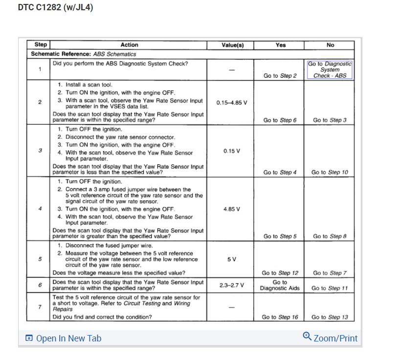

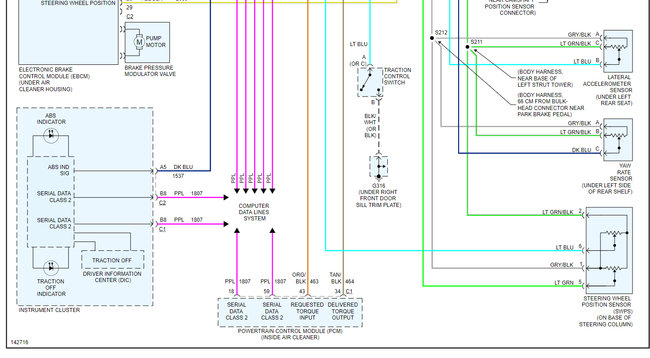

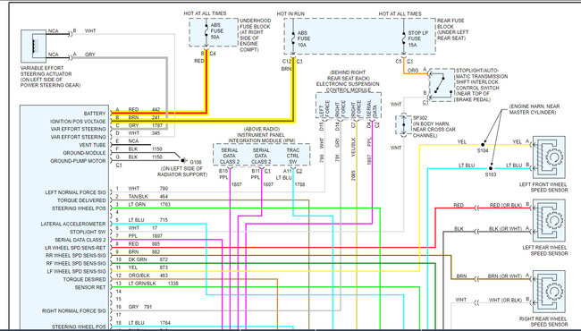

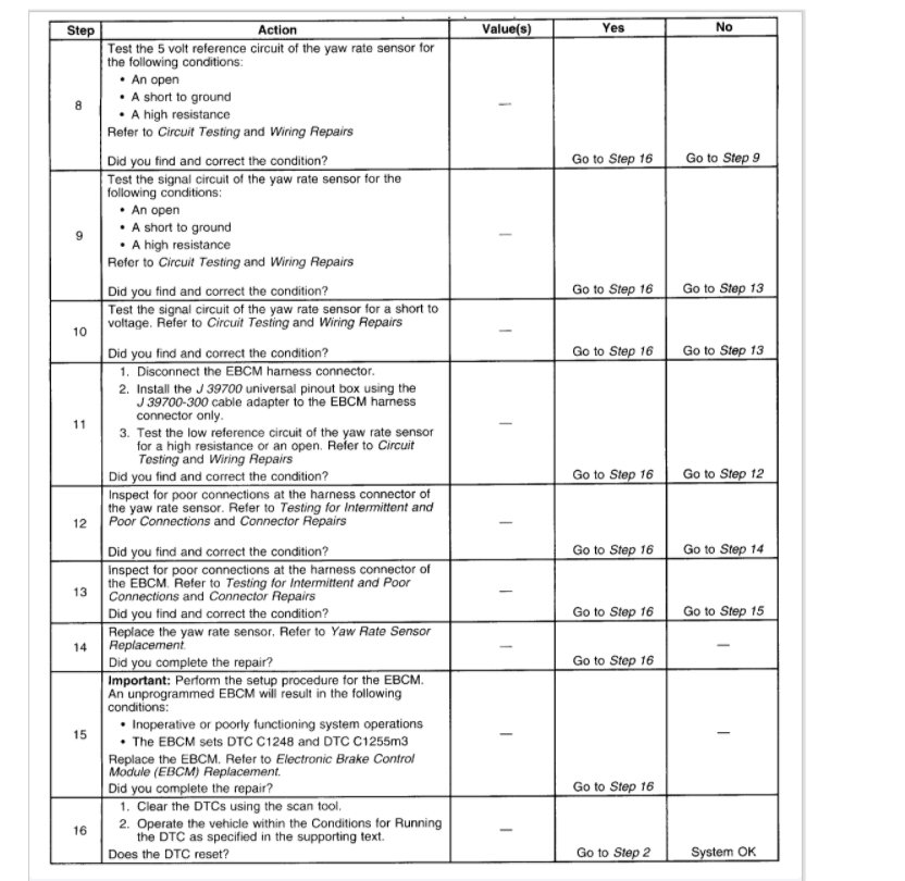

The codes are power codes and sensor codes. They will go away when the module is programmed to the VIN number of your car.

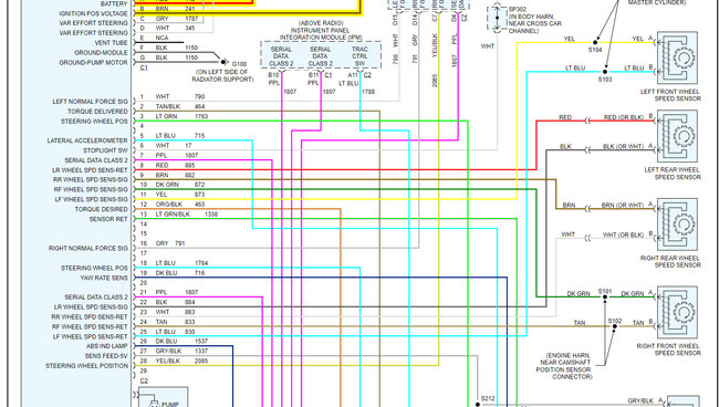

I attached a diagram for you as well. Check the 2 fuses that provide power to the unit.

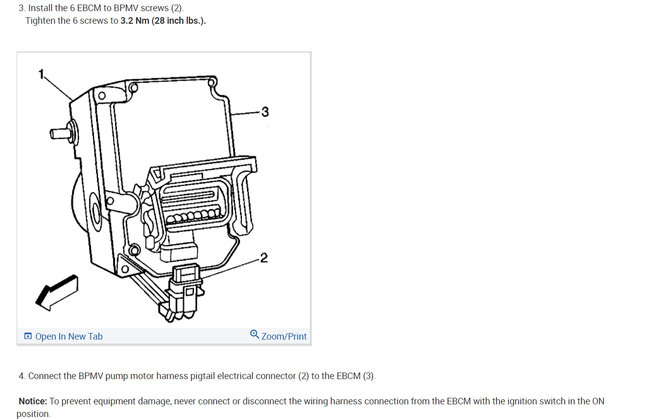

Important: An unprogrammed EBCM will result in the following conditions:
^ Inoperative or poorly functioning DRP/ABS/TCS/VSES (if equipped)
^ Set DTC C1248 EBCM Turned On the Red Brake Warning Indicator
^ Set DTC C1255m3 EBCM Internal Malfunction

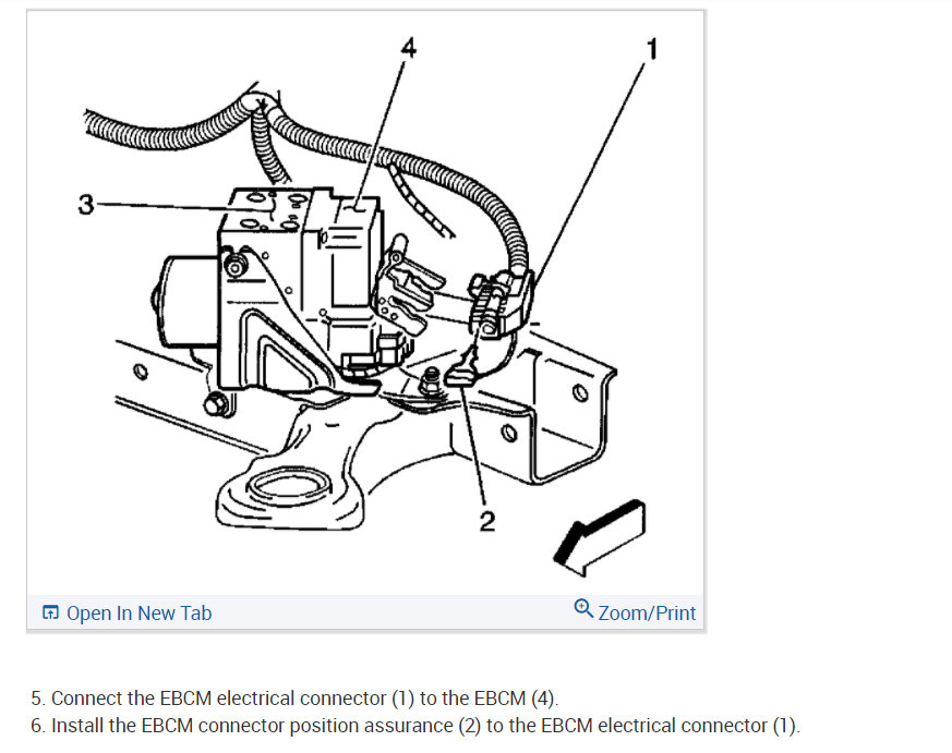

11. If a replacement EBCM is being installed, it must be programmed using the latest software matching the vehicle. Please contact your local dealer regarding this procedure.
12. Use the scan tool in order to clear the DTCs.
13. Perform the ABS Diagnostic System Check. Refer to Diagnostic System Check - ABS
