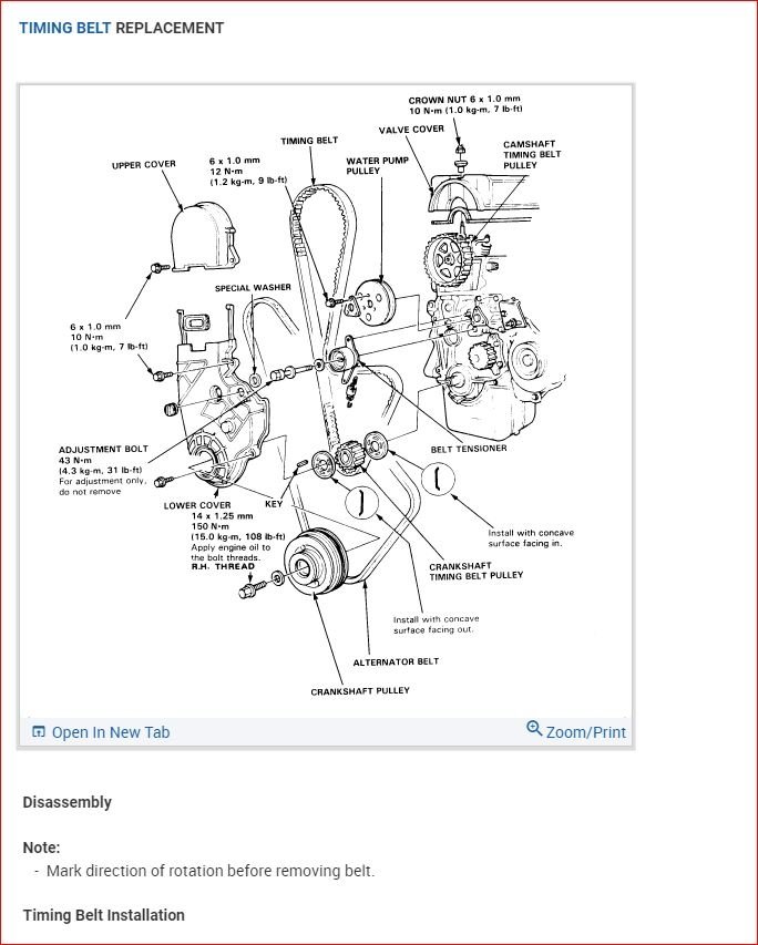

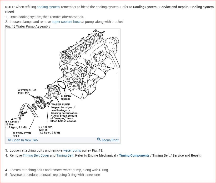

Do i have to remove timing cover and belt to replace water pump?
May 28, 2019 at 12:53 AM
Hi Clarence,

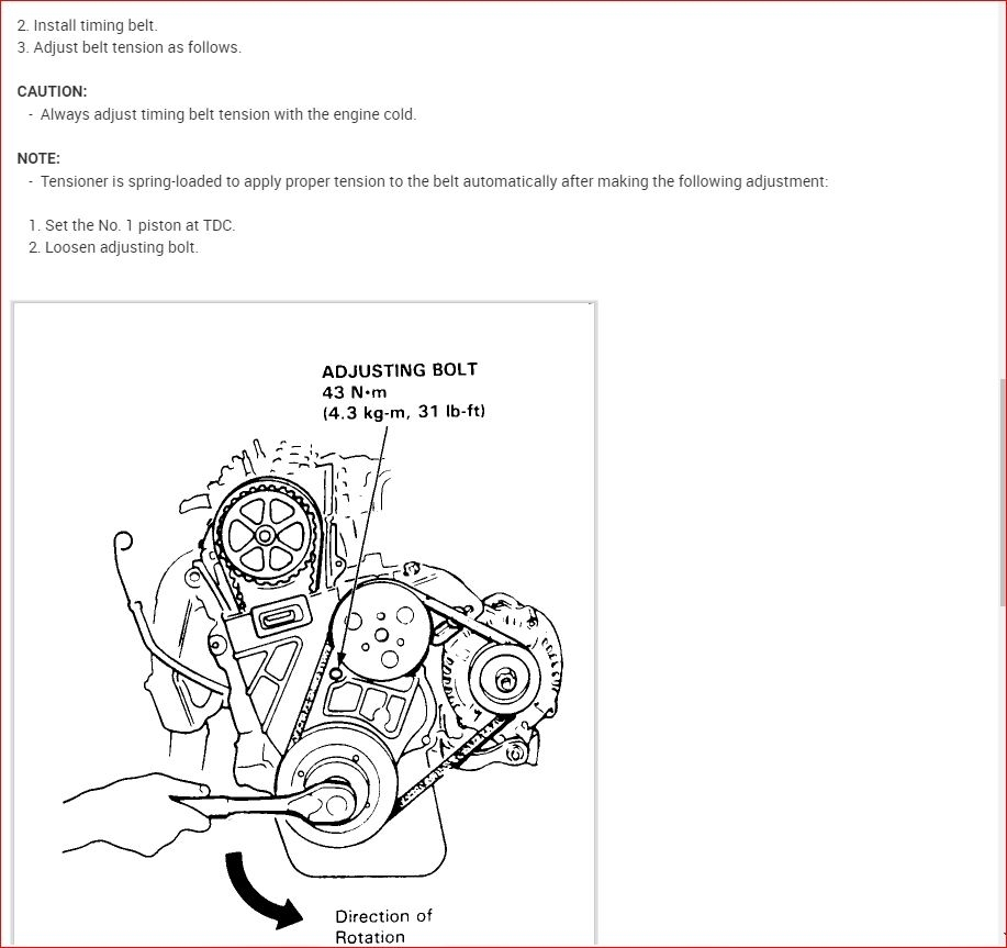

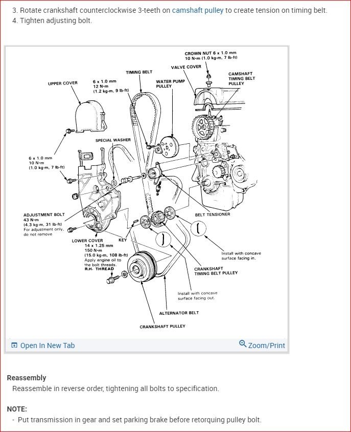

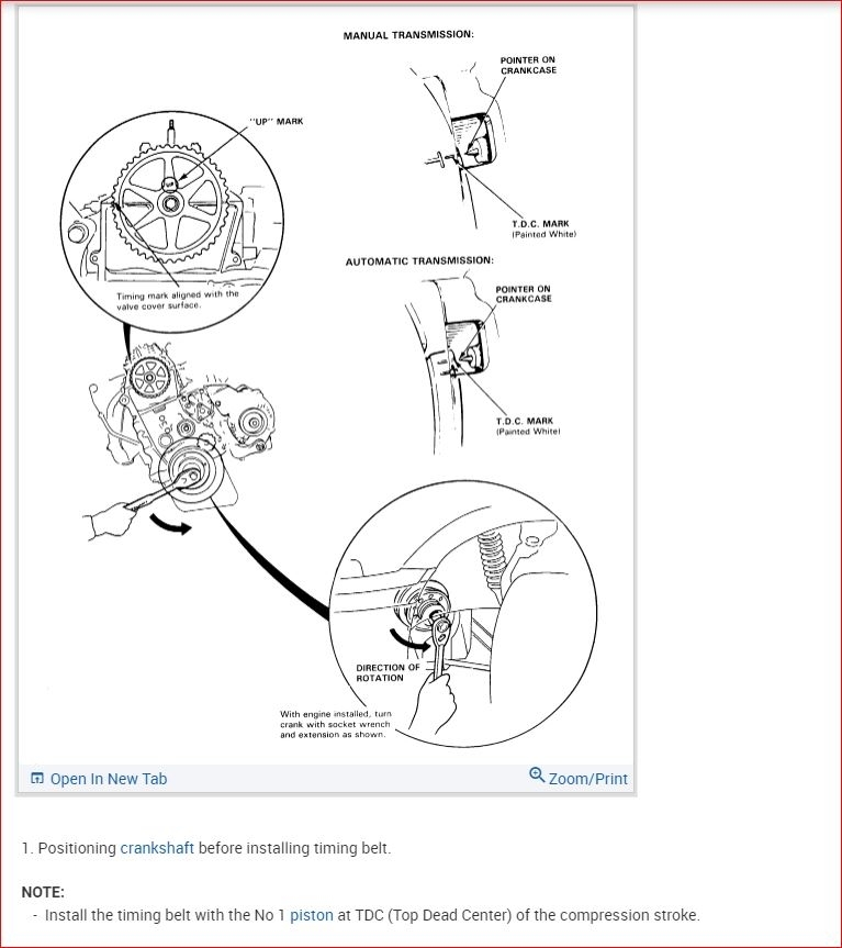

I attached the procedure to replace the water pump and the timing belt as it is required to be removed. Please let me know if you need more assistance. Thanks
