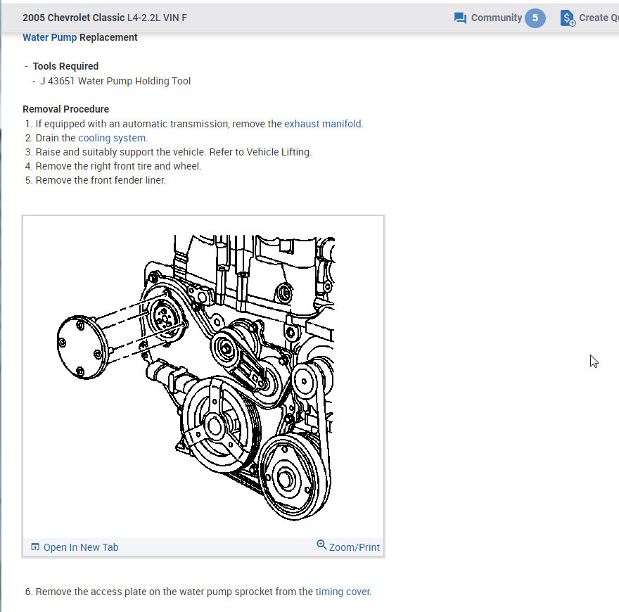

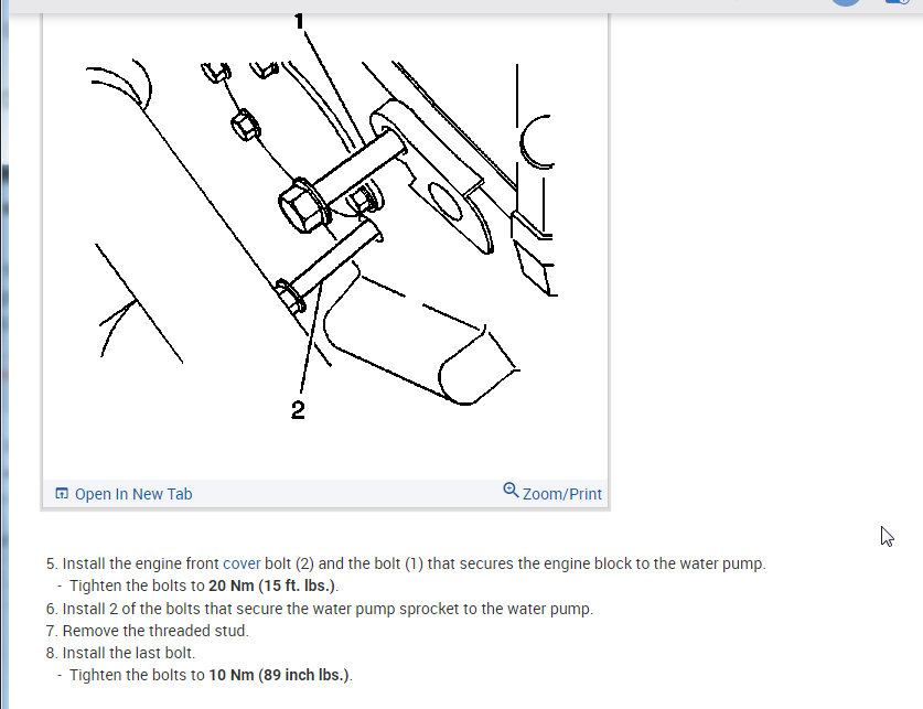

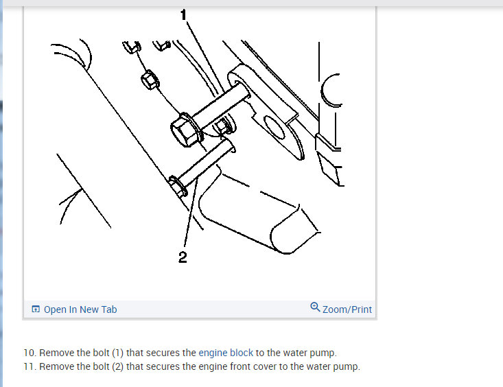

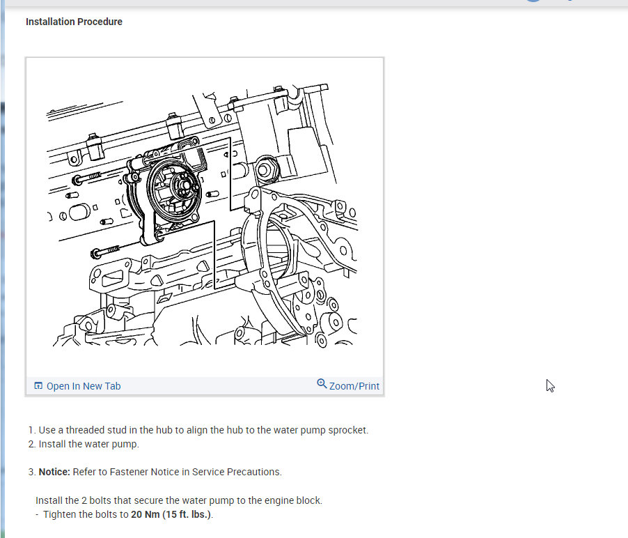

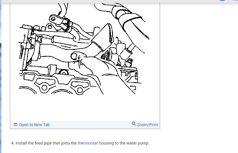

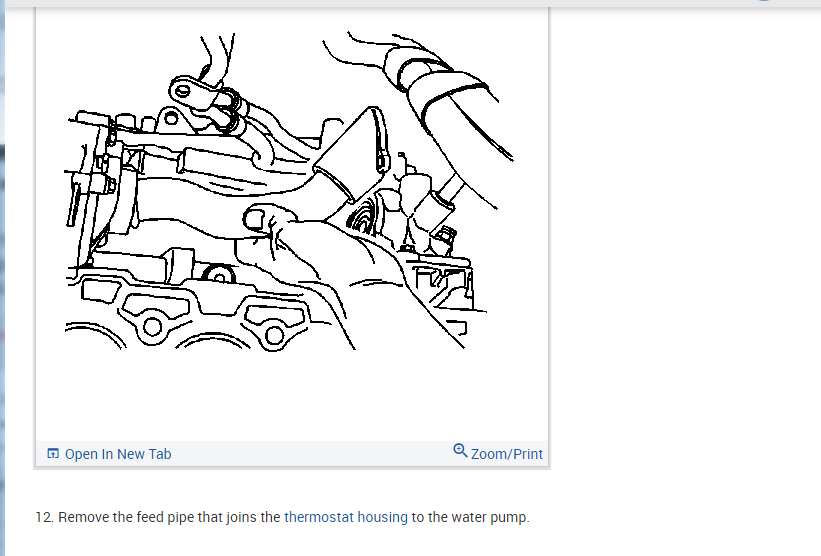

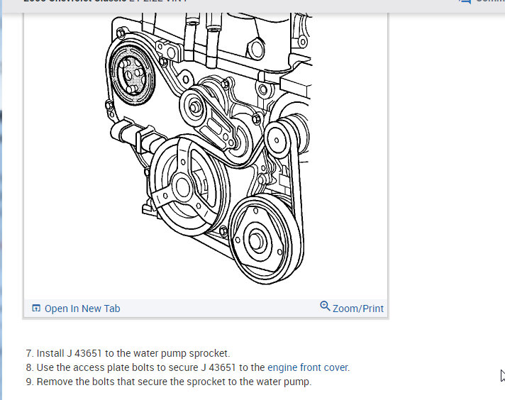

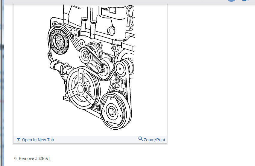

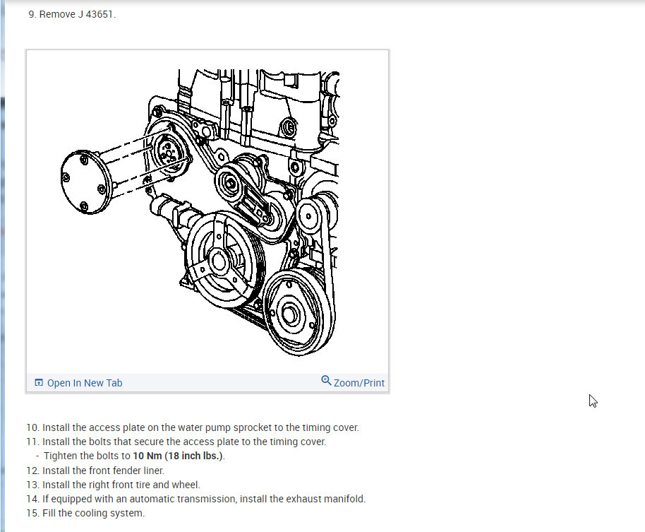

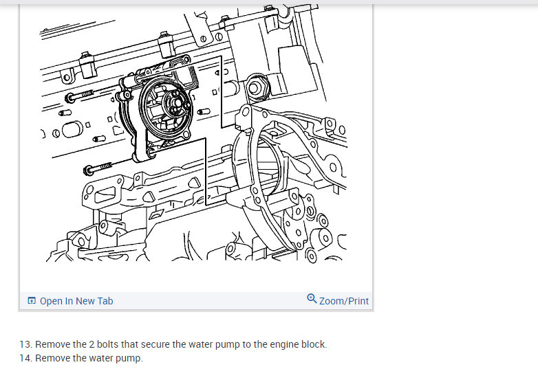

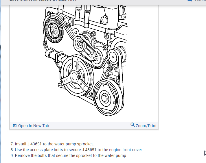

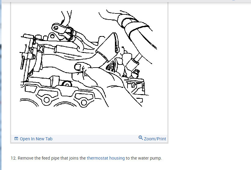

I need to replace the water pump.
Nov 22, 2020 at 3:49 AM
Experienced Mechanic
18,907 POSTS
I am attaching the entire process from the manual for your review. Let us know if you need other info. Check out the diagrams (Below). Please let us know if you need anything else to get the problem fixed. Thanks
