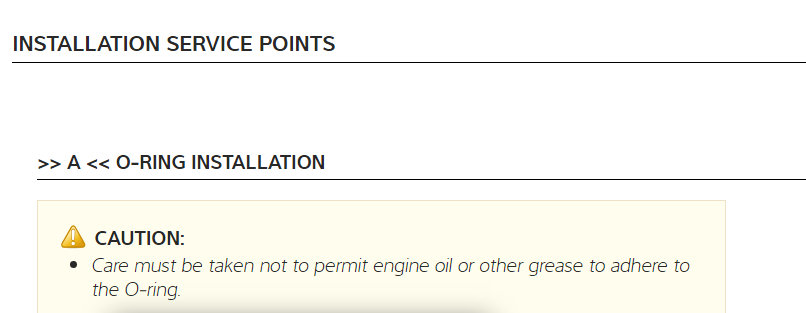

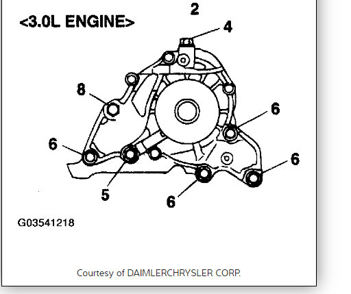

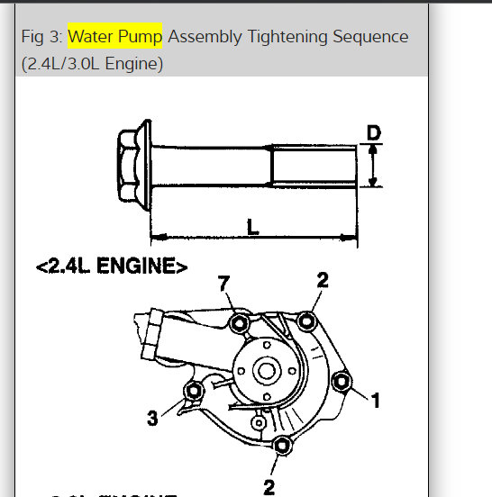

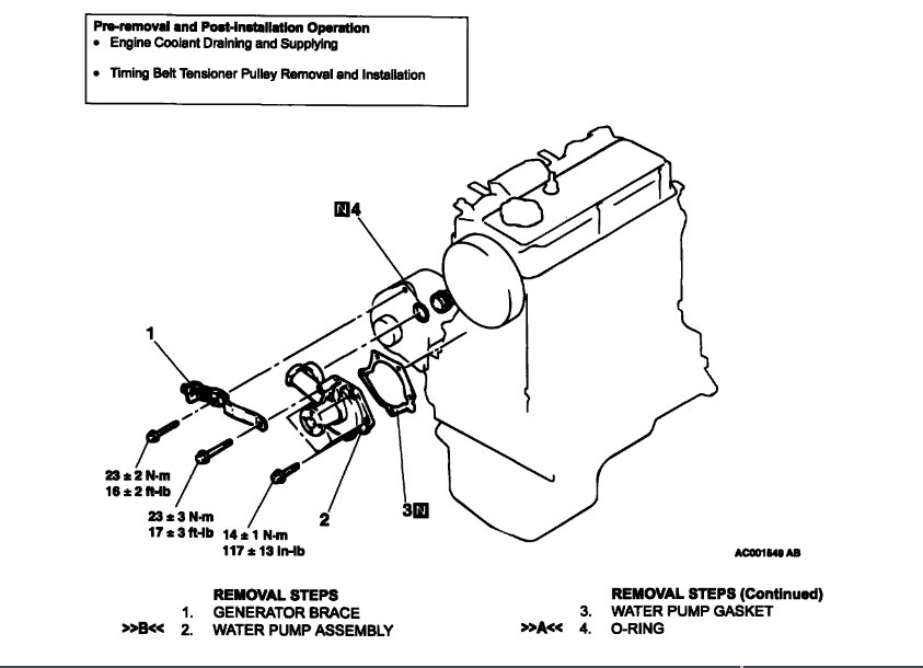

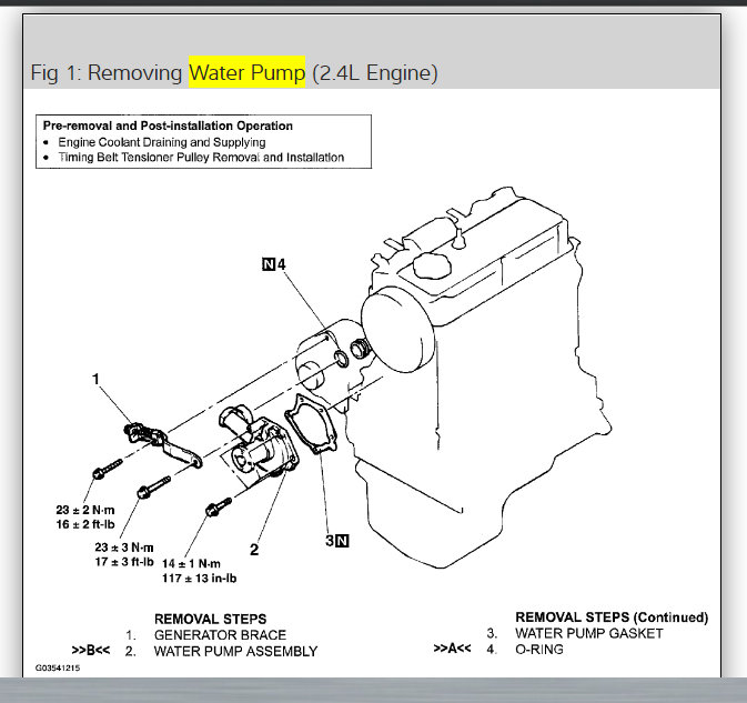

Water pump leaking.
May 6, 2019 at 2:48 PM
SCGRANTURISMO
  • 4,897 POSTS
I have included the diagrams down below the information that you have requested. Please let us know how it turns out. If you ever have another vehicle related question, please, feel free to ask. It's why we are here and what we do.
Thanks,
Alex
