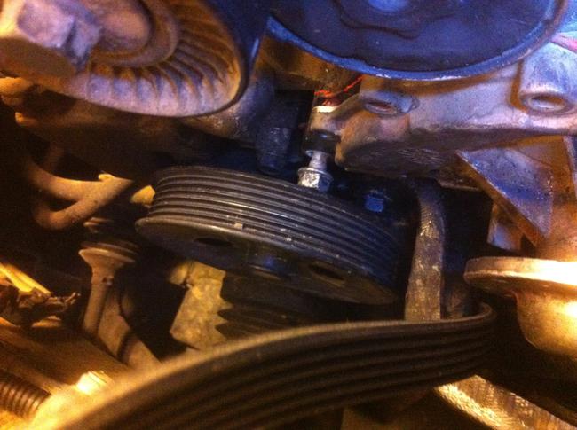

I need a diagram
Image (Click to enlarge)

There are 3 bolts that hold the power steering pump on that are accessed through holes in the pulley. Remove the bolts and slide the pump to the side to get that water pump bolt out.
