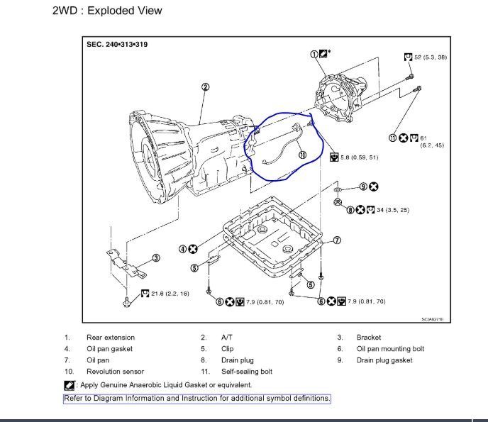

Where is the transmission speed sensor? Need to find it and replace. Thanks
May 23, 2020 at 2:06 PM
Good evening,
It is inside the transmission and is tricky to do. I attached pictures and the procedure for you to follow.
Why are you replacing it?
REVOLUTION SENSOR
TM-264 Exploded View
2WD: Removal and Installation

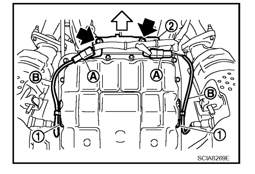

8. Disconnect heated oxygen sensor 2 harness connectors (A).
: Vehicle front
: Bolt
9. Remove heated oxygen sensor 2 harness (B) from clips (1).
10. Remove bracket (2) from transmission assembly
11. Remove clips (1).

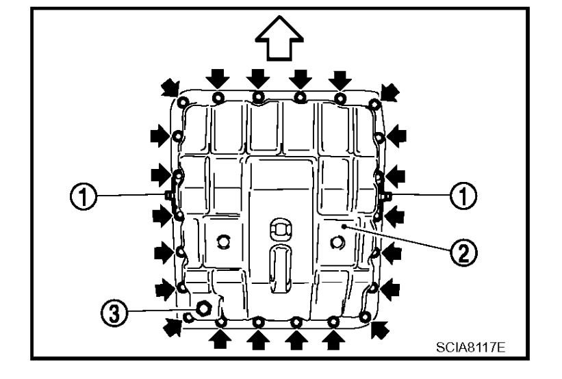

3: Drain plug
: Vehicle front
: Oil pan mounting bolt
12. Remove oil pan (2) and oil pan gasket.

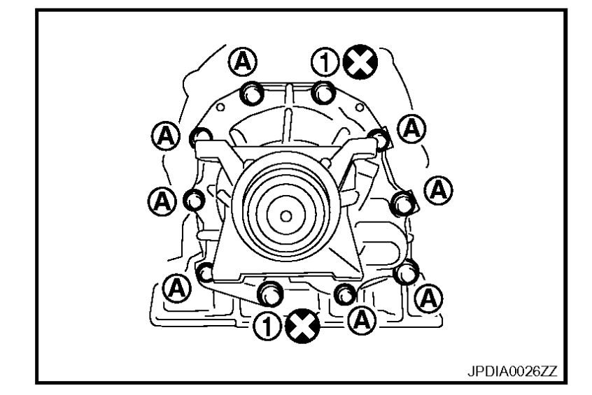

16. Remove tightening bolts for rear extension assembly and transmission case.

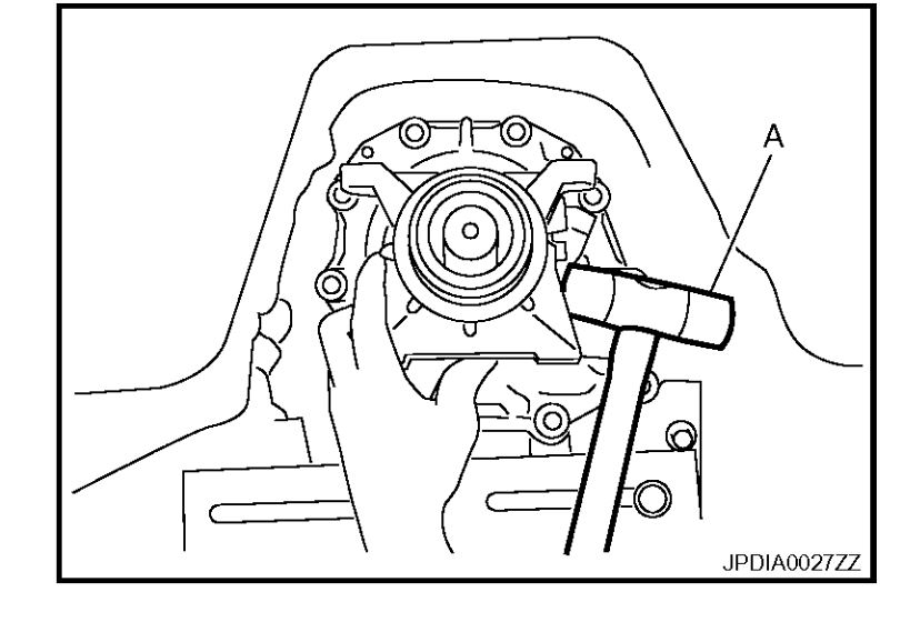

17. Tap rear extension assembly with a soft hammer (A).

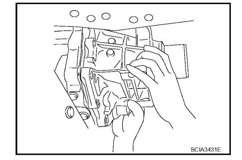

18. Remove rear extension assembly (with needle bearing) from transmission case.

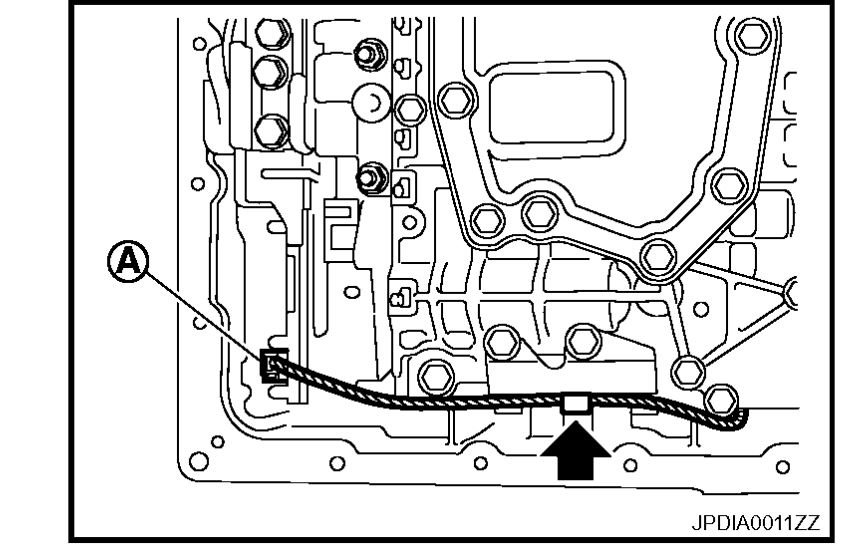

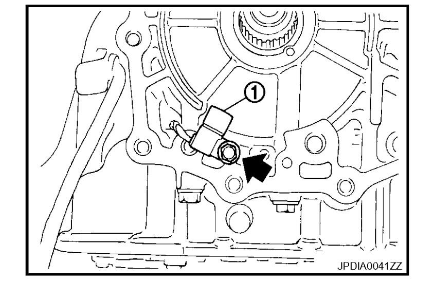

19. Disconnect revolution sensor connector (A).
CAUTION: Be careful not to damage connector
20. Disengage terminal clip (
