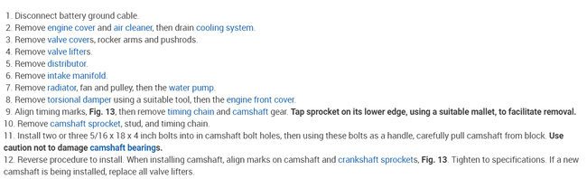

I have a few detailed questions regarding how to with engine in the vehicle.Does the oil pan need to come off in order to remove and re-install the timing cover? Do the four water pump bolts go into the water jacket of the engine? Or do they just terminate into threaded bosses?
Aug 7, 2023 at 2:32 PM
  • 55,691 POSTS

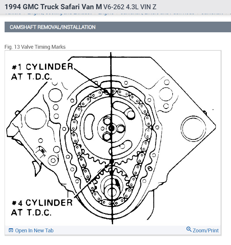

The oil pan does not need to be removed and the water pumps bolts go through to the water jacket. Here are the instructions to help if you need it. Check out the images (below). Please let us know if you need anything else to get the problem fixed.
Aug 8, 2023 at 5:27 AM
OL29RODDER
Thanks. Was good backup info confirming what I vaguely suspected. New problem (that others also seemed to encounter, but haven't told me of why or final resolve): all initial basic checks past failing shop diag as a code fault of MAF sensor (expensive wrong diag with no apologies from shop) lead me to check timing chain (stretch? Skipped Gear tooth?) and go old school. Seemed to indicate such. But, all checks and mic'ings performed to compare existing parts to new parts left me thinking the new T-set will also have slack and that's exactly what happened when I installed the new set! So now I'm really flummoxed!!! Poor quality of mfg.. It's a Cloyes set and I understood they're reputable.
