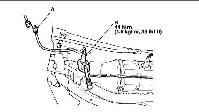

I attached possible failure for the code for you. In most cases, it is the sensor but should be confirmed by someone with a scan tool that can monitor live data.
P2A00
Descriptor
Probable Causes
Air Fuel (A/F) Ratio Sensor 1
Poor Connections or Loose Terminals At Air Fuel (A/F) Sensor 1 and Powertrain Control Module (PCM)
A/F Sensor Replacement
Special Tools Required
- O2 sensor wrench, Snap-on S3176, or equivalent, commercially available
1. Disconnect the A/F sensor 4P connector (A), then remove the A/F sensor (B).
2. Install the parts in the reverse order of removal.

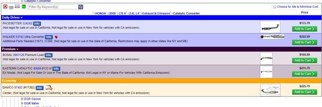

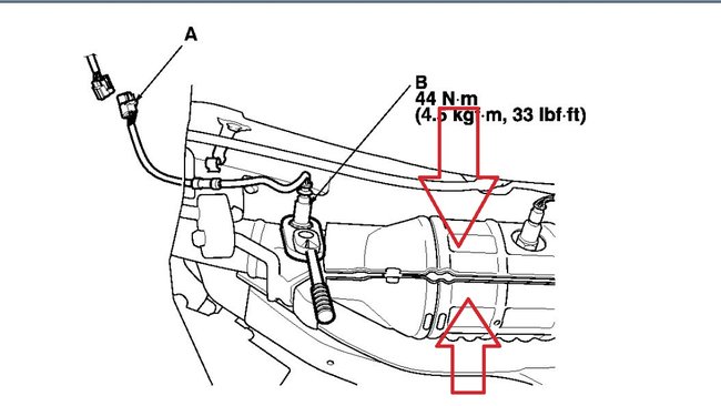

Thank you. Can you, please, identify for me (part #, commercial name) the protective covers of the catalytic converter? Where can I buy them? I noticed that they are rusted and don't hold together anymore.
Jan 22, 2019 at 7:07 PM

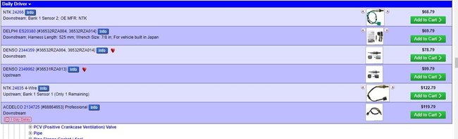

OK, it is called the upstream O2 sensor or the air/fuel ratio sensor.
The part number come from a parts store.
The shield is not available by itself. You would need to replace the cat converter to get the shield.
I attached parts available from rockauto.
