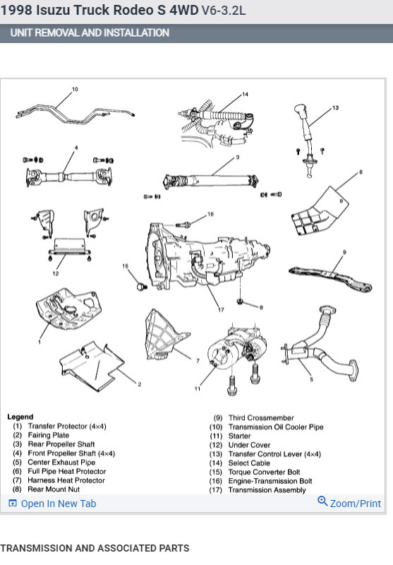

The transmission in my truck has gone out. I have a 2002 4x2 Rodeo with a good transmission and I need to know if I can use the 2002 in my 1998. Also need to know if the 4x4 vs the 4x2 drive train will be a problem?

The 4x2 and 4x4 transmissions are not interchangeable.
You will have to find a transmission that is 4x4 in order for it to work in your vehicle.
https://www.2carpros.com/articles/how-to-remove-an-automatic-transmission-rwd
I have attached the transmission replacement procedure for your reference.
