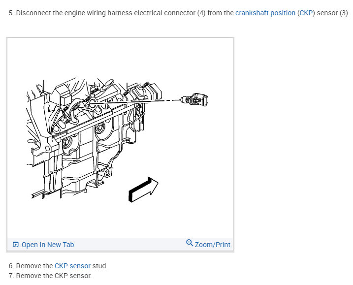

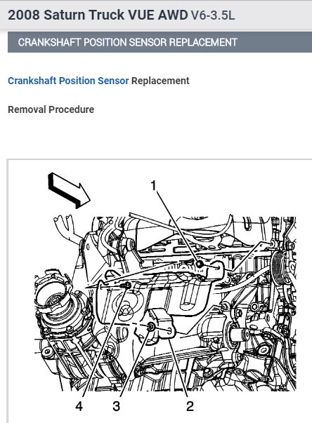

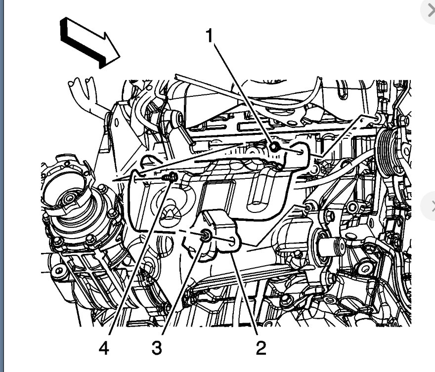

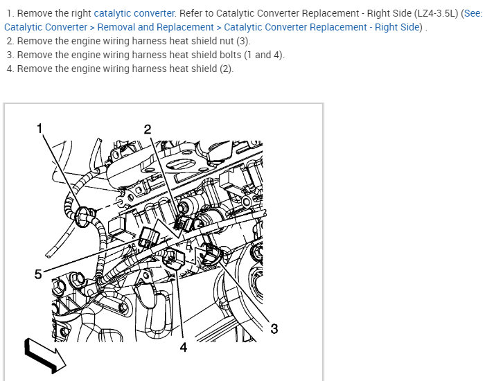

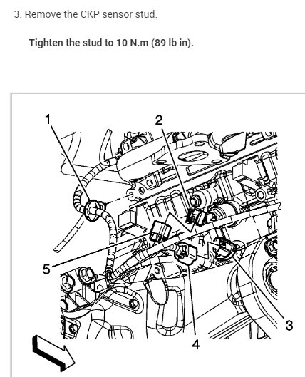

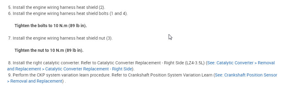

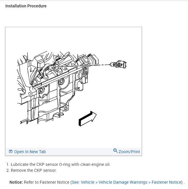

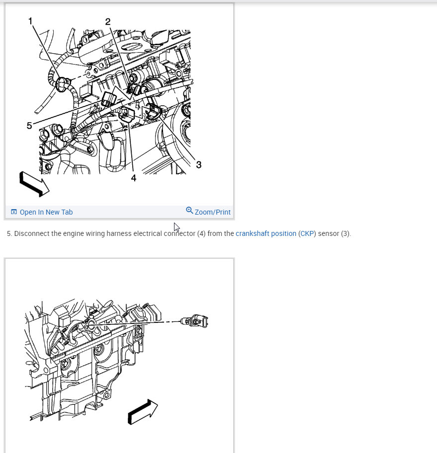

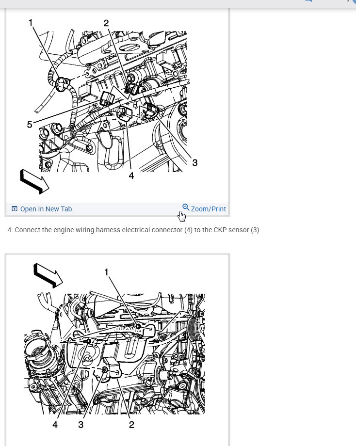

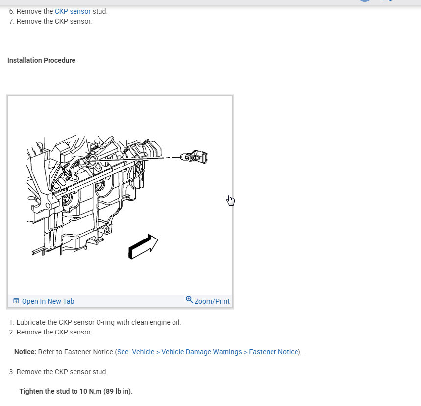

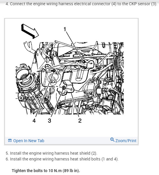

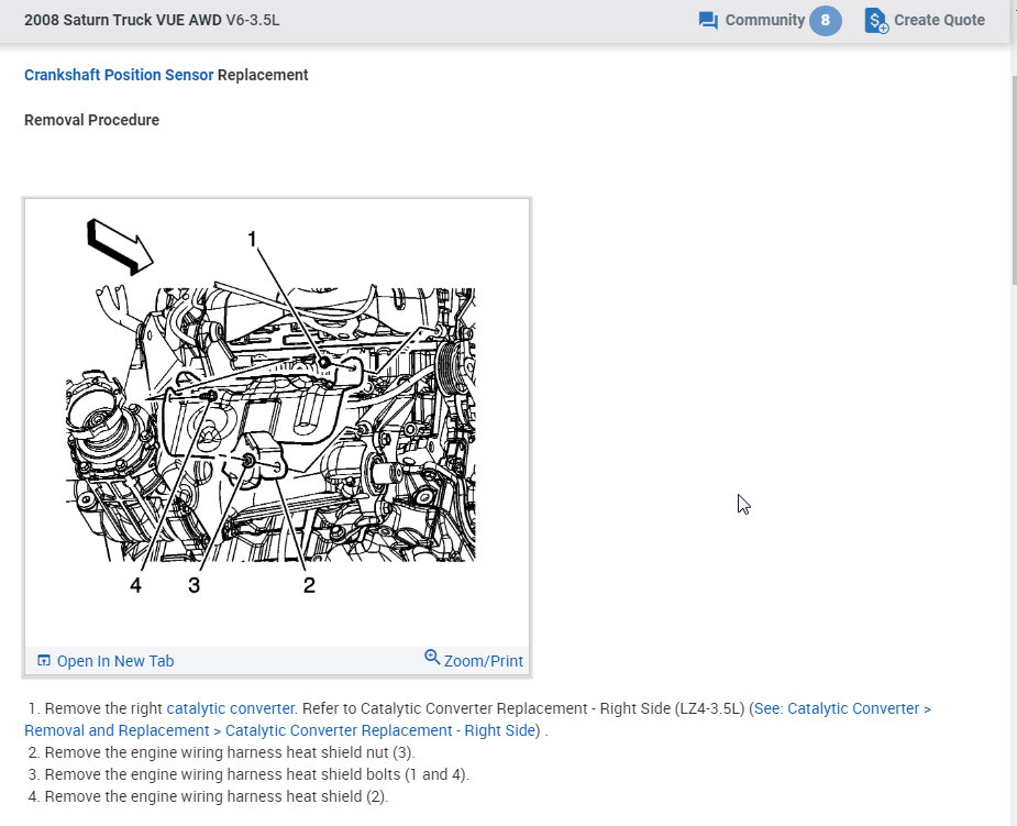

I need to know where the crankshaft position sensor is on the car listed above XE model.
Oct 14, 2019 at 4:34 PM
DANNY L
  • CAR REPAIR CONTRIBUTOR
  • 5,648 POSTS
Hello, I'm Danny.
Here is a tutorial for you to view showing how to replace a crankshaft position sensor:
Below I've attached picture step-by-step instructions on how to replace your crankshaft sensor with its location for your Saturn Vue. Hope this helps and thanks for using 2CarPros.
Danny-
Oct 14, 2019 at 5:04 PM
I attached the process. Please let me know if you need anything else. Thanks
