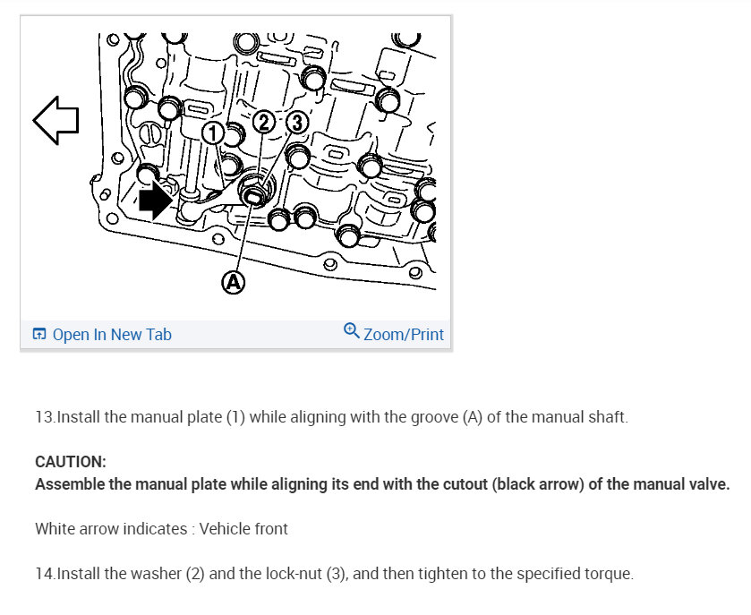

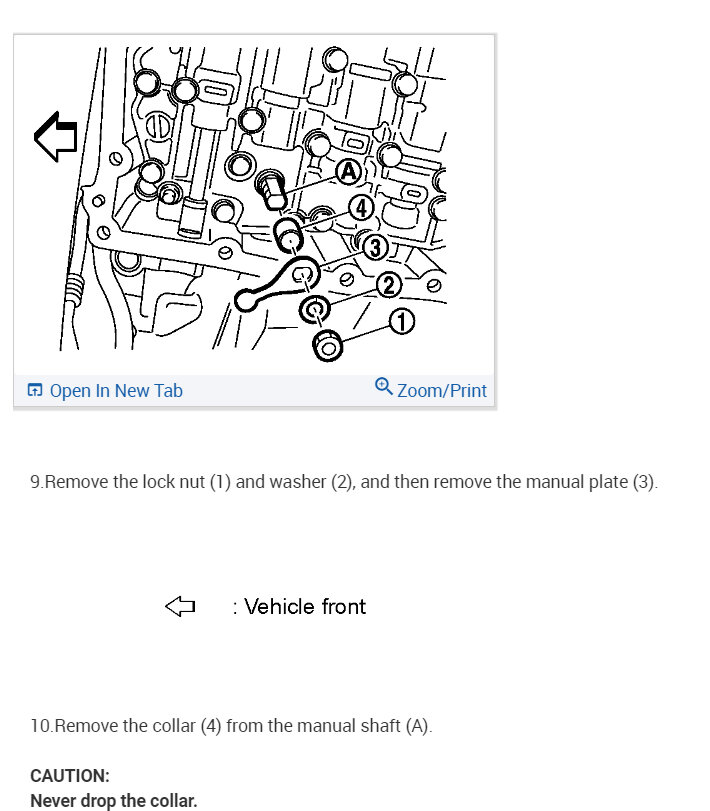

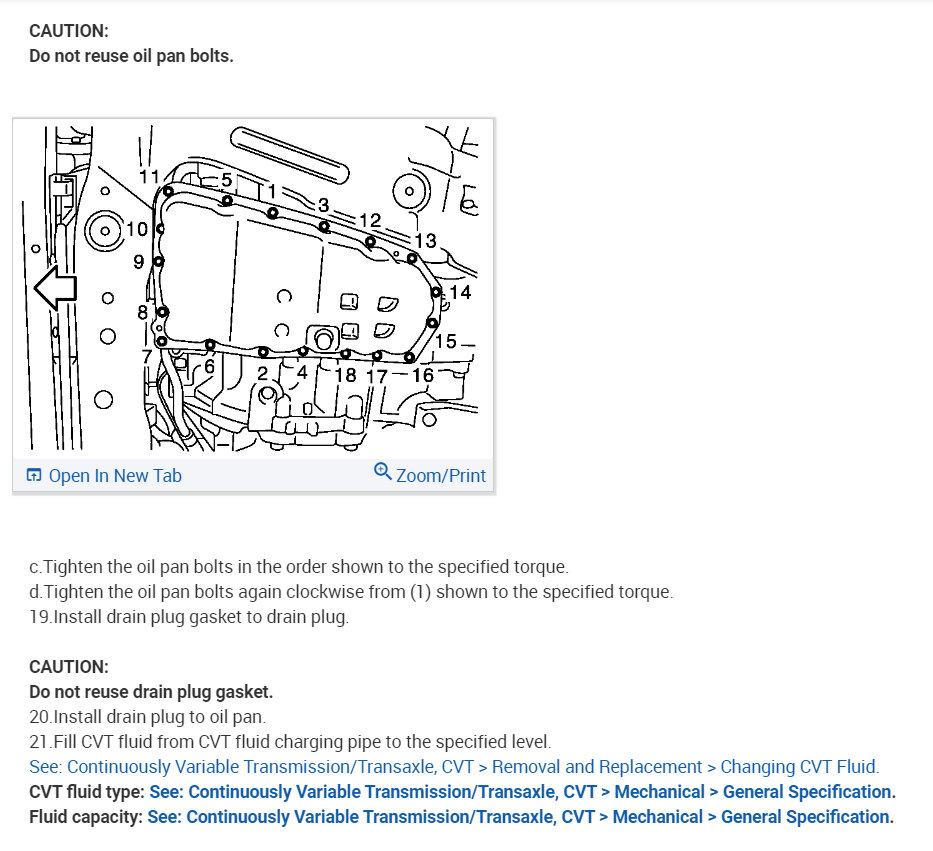

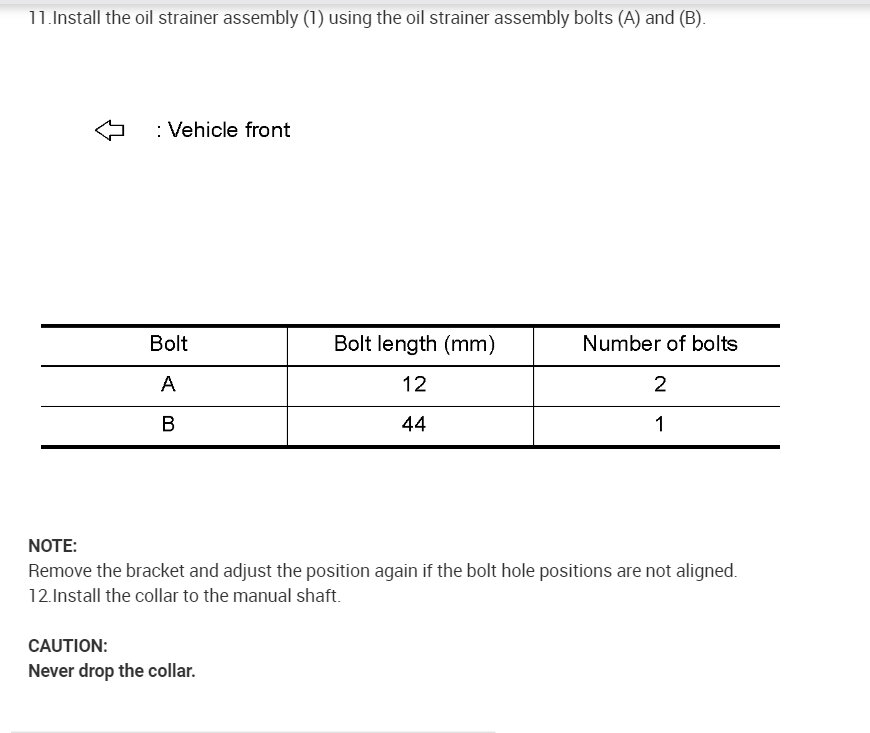

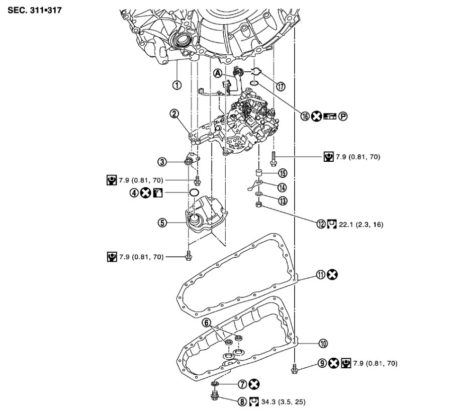

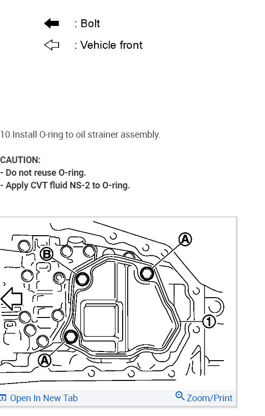

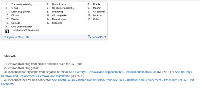

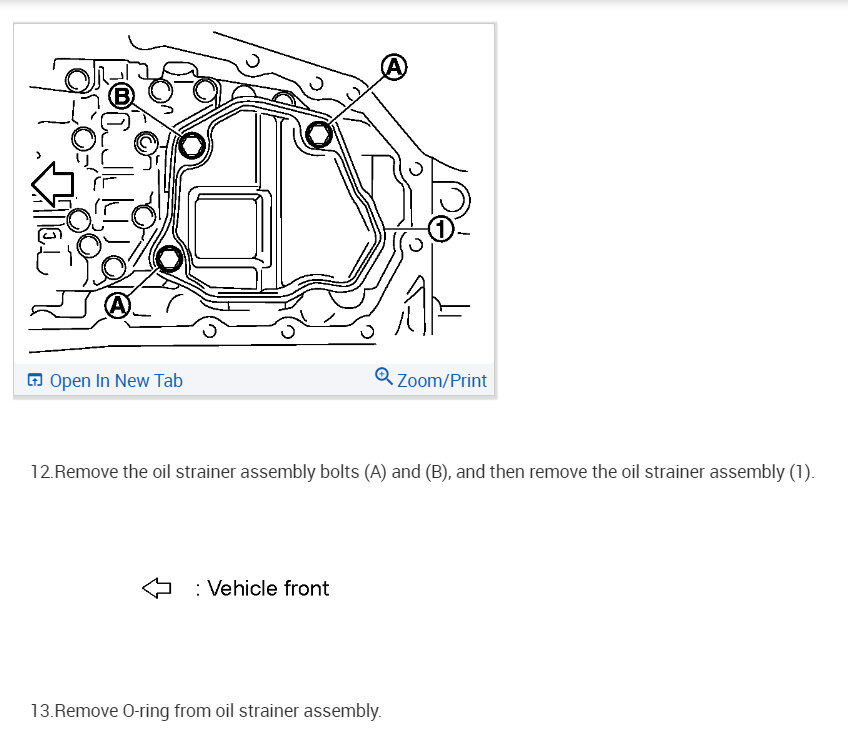

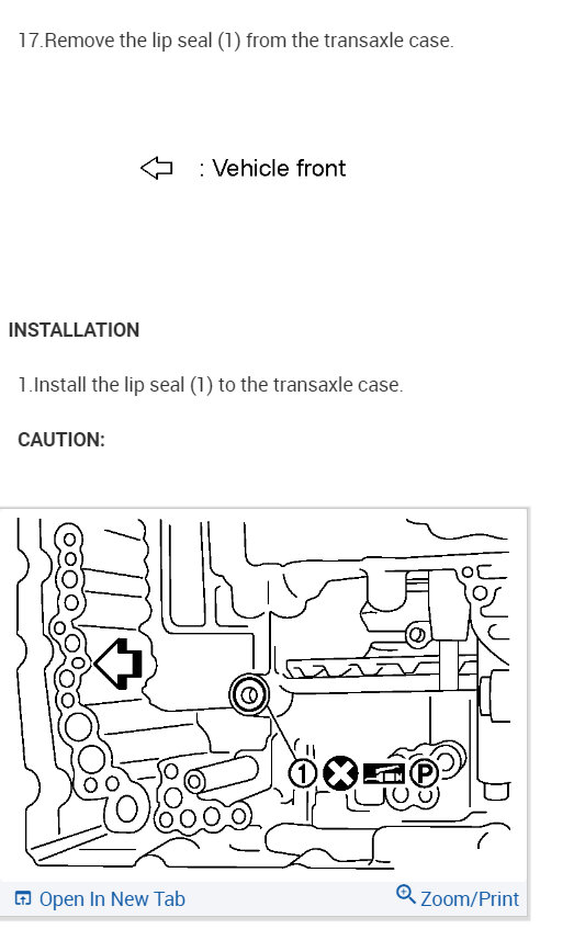

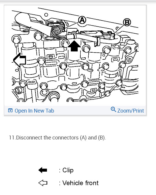

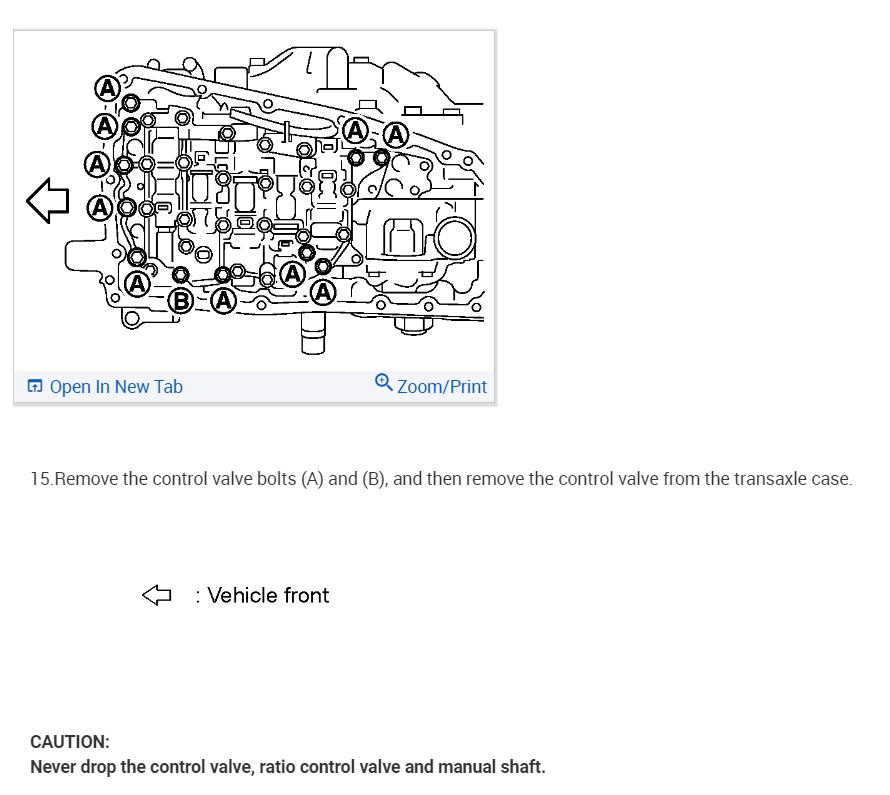

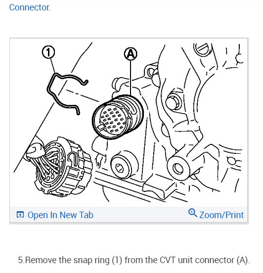

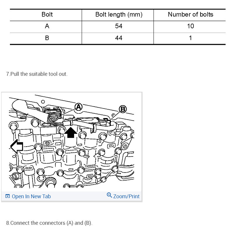

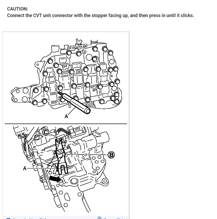

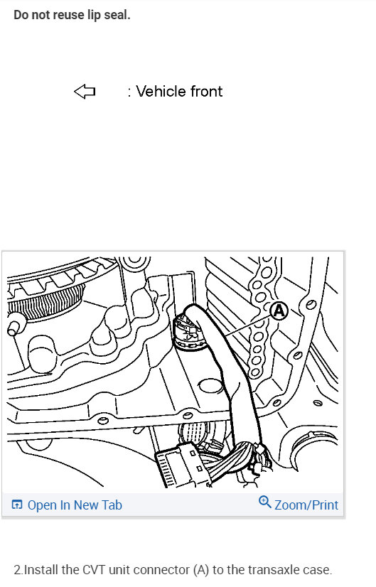

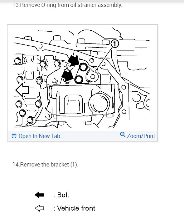

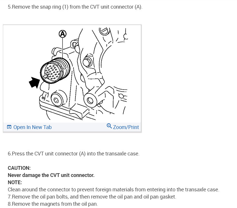

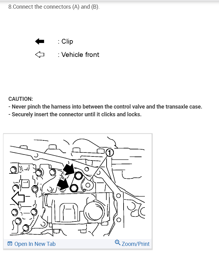

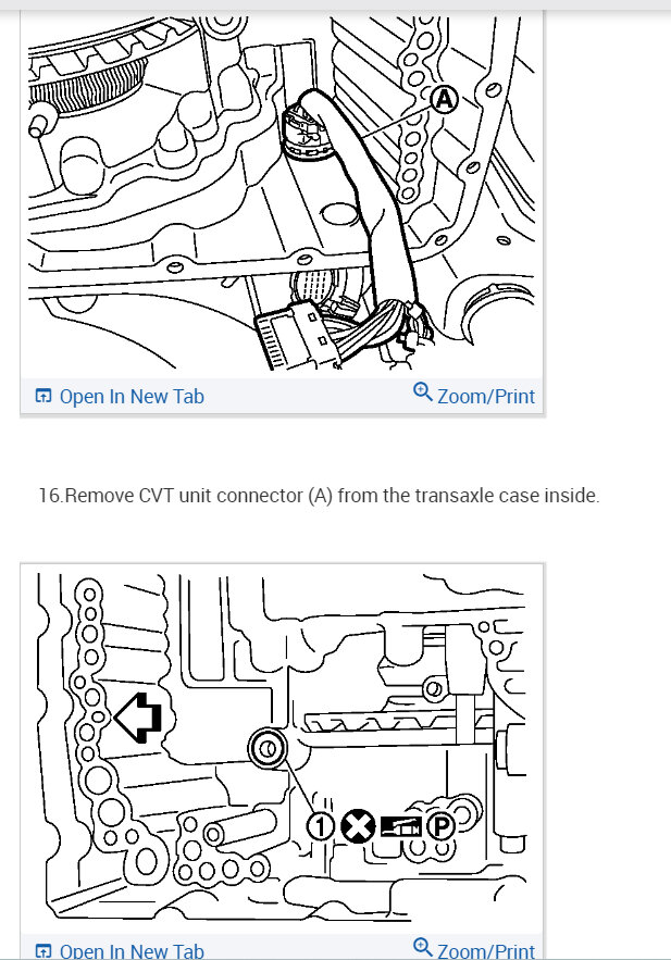

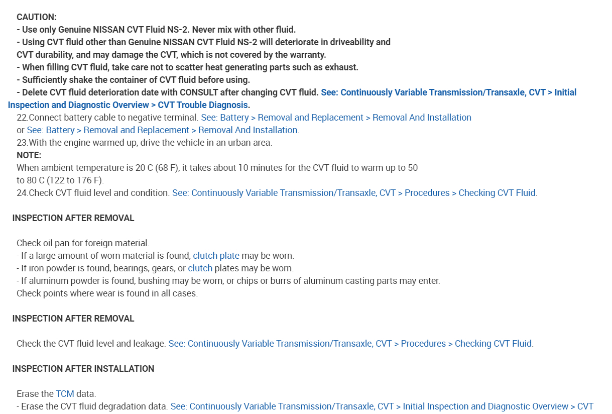

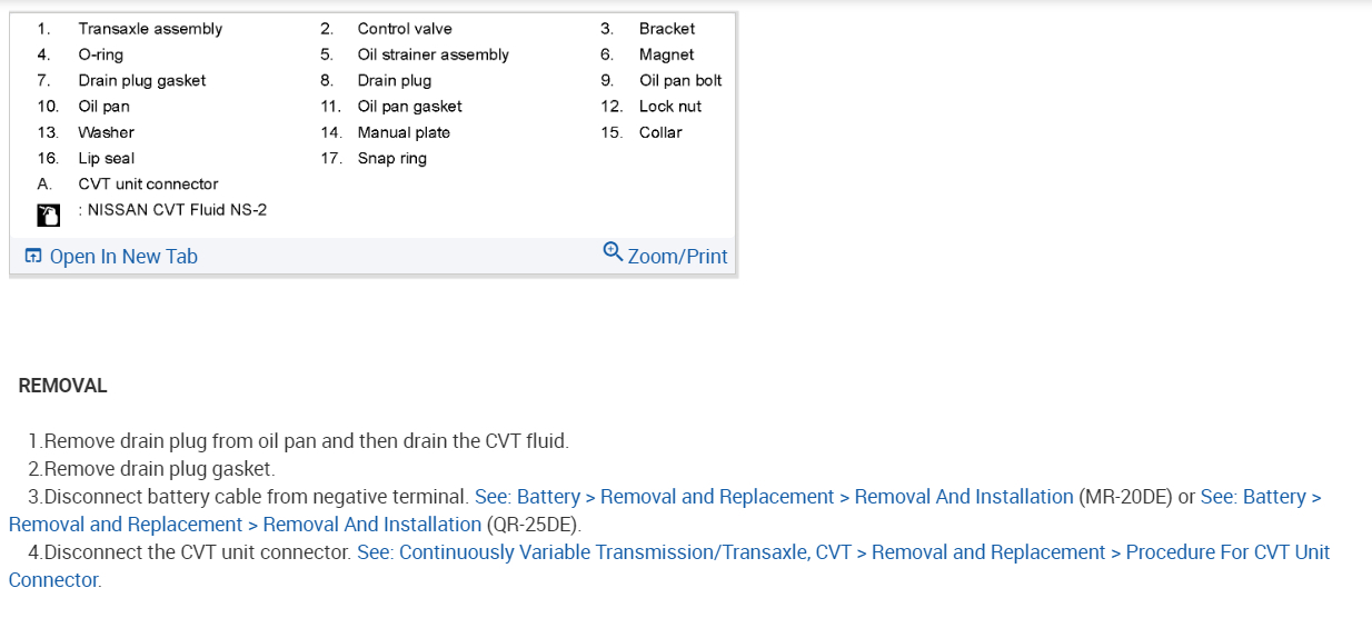

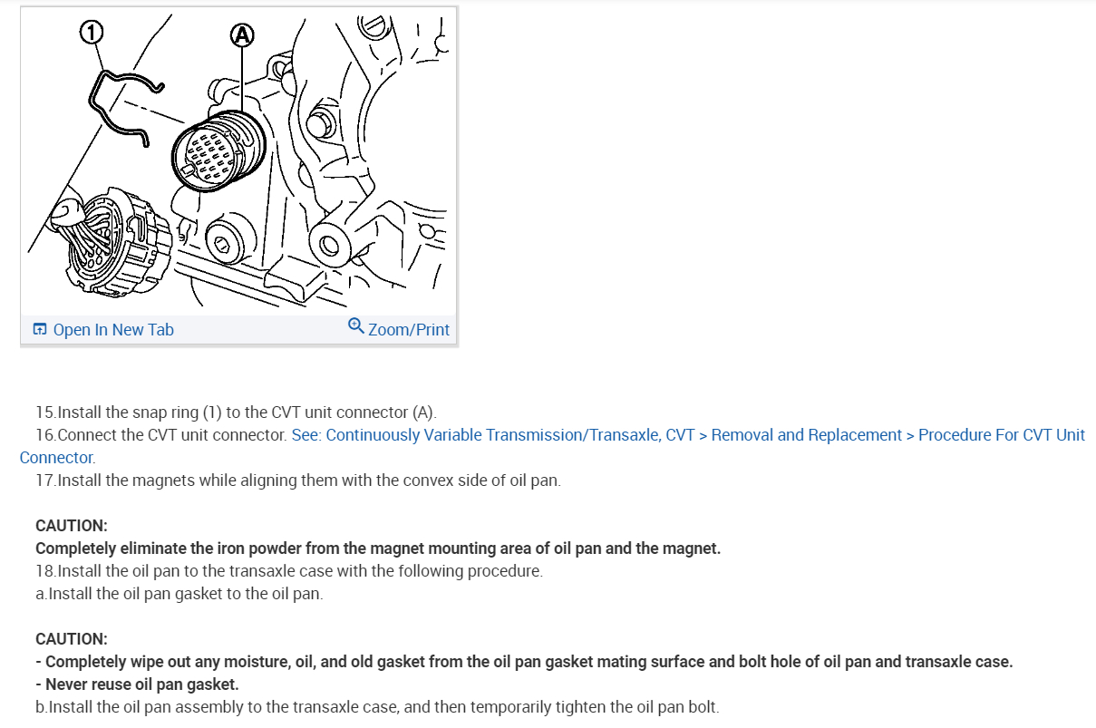

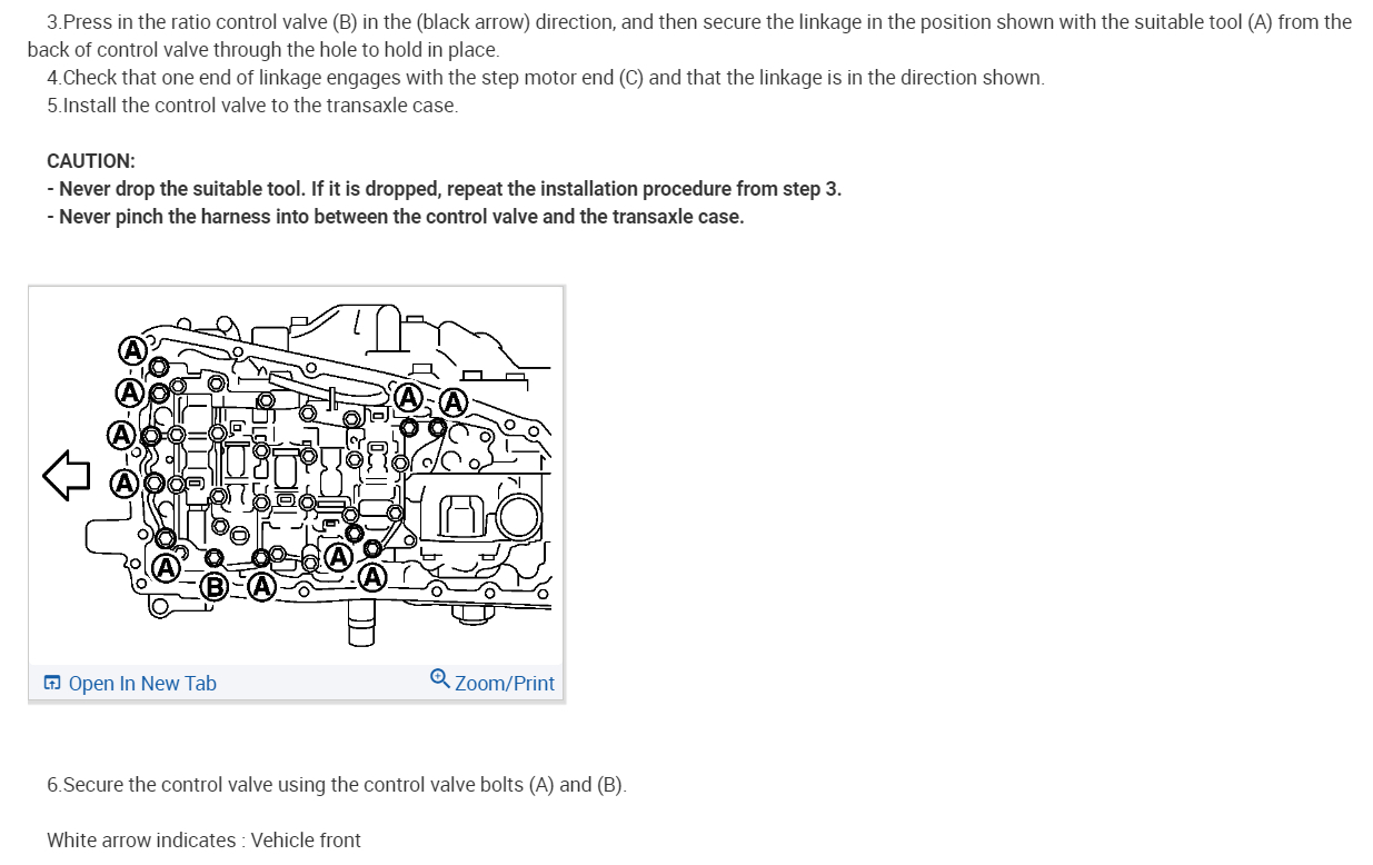

P1778 Code - Related to stepper motor. I would like to know the bolts to remove from transmission valve body.
Aug 18, 2023 at 10:27 AM
  • 55,433 POSTS
The P1778 error code step motor function within the CVT (Continuously Variable Transmission) system.
Here is how to remove the valve body and the bolts in the images below. Check out the images (below). Please let us know if you need anything else to get the problem fixed.
