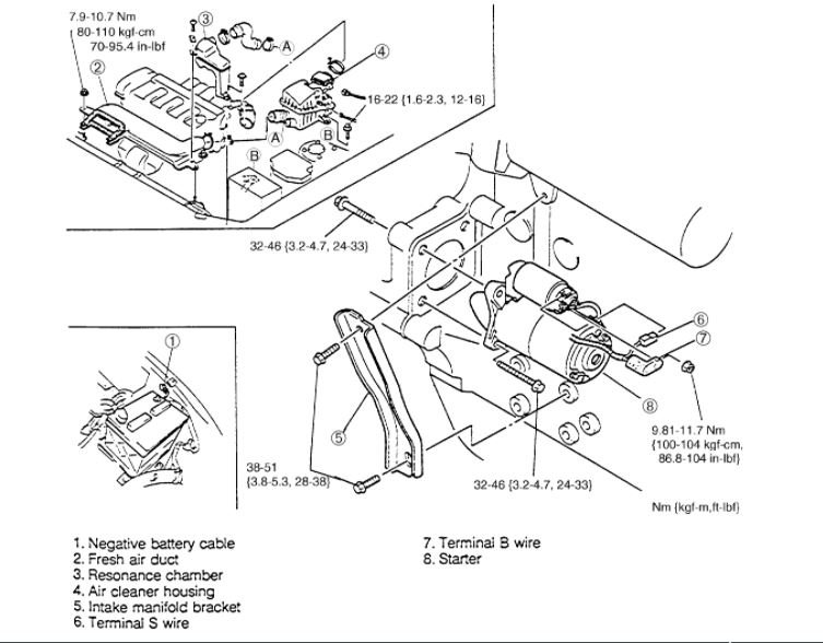

Engine won’t crank. Son replaced starter. It clicks but nothing else. How do I remove the starter?

Good afternoon,
I attached a picture and a procedure for you to follow.
I also found a YouTube video of the procedure as well.
https://www.youtube.com/watch?v=e3A-tGl7_M0
NOTE: Deactivate audio anti-theft function, as outlined under Technician Safety Information before disconnecting battery.
1. Disconnect battery ground cable.
2. Remove or disconnect components in order, Fig. 2.
3. Reverse procedure to install.
4. Reactivate audio anti-theft function as outlined under Technician Safety Information.
