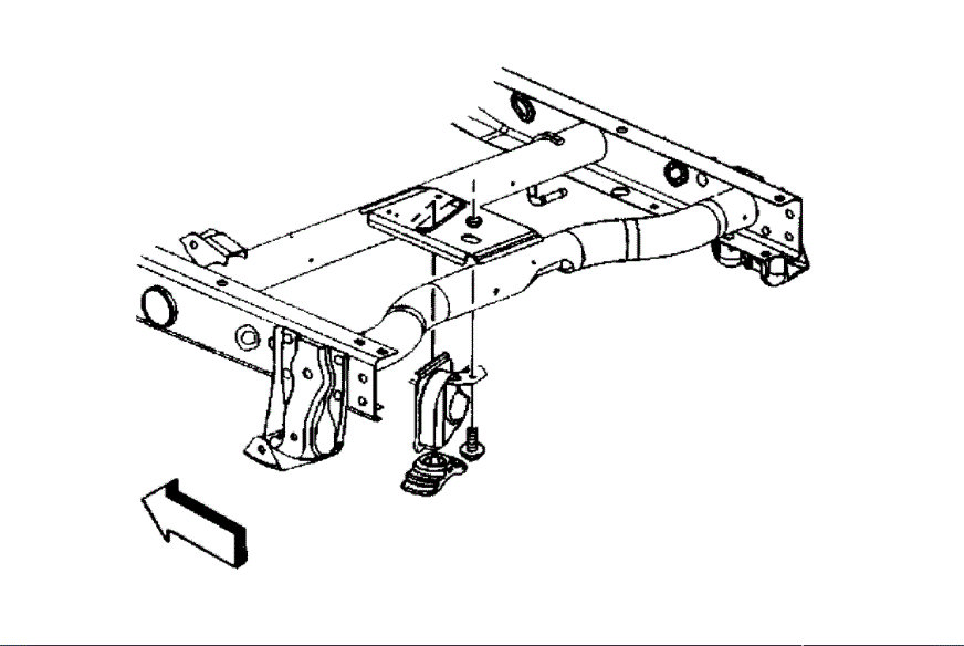

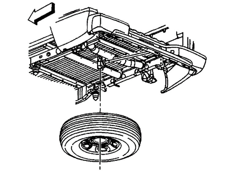

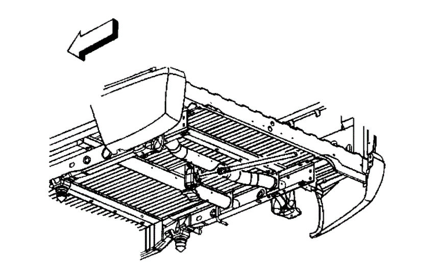

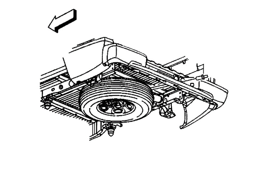

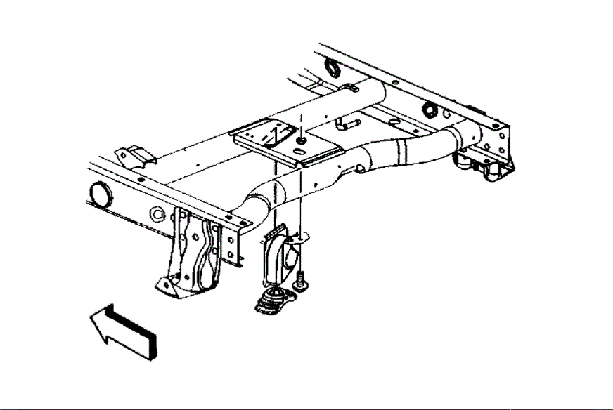

Bought the truck listed above Z71 with the spare tire gone. all the parts are underneath the a seat, not sure if everything is there and I want to know how to properly put back and secure the tire hoist and the tire. thank you!
Sep 1, 2020 at 12:12 AM
Good morning,
There is a cable that lowers and raises the spare tire into place. I attached pictures of that for you.
If that is missing, you need to get it at the dealer's parts department. Make sure you get the handle as well. the handle just stores in the back of the truck in one of the side panels.
Tire Hoist and Shaft Replacement

1. If the vehicle is equipped with a spare tire stowage lock cylinder, open the spare tire lock cover on the bumper and use the ignition key to remove the lock.
Notice: Use only hand tools to lower and raise the spare tire hoist assembly. Do not use air tools. The use of air tools at high speeds will damage the spare tire hoist assembly.
2. Turn the hoist shaft counterclockwise to lower the spare tire to the ground. Continue to turn the hoist shaft until the spare tire can be pulled out from under the vehicle and removed. If the spare tire does not lower to the ground, the secondary latch is engaged causing the tire not to lower.

6. Depress the tabs, remove the guide shaft from the hoist collar, and slide the shaft toward the bumper.
7. Remove the collar from the hoist
8. Remove the bolt.
9. Remove the hoist from the bracket.
10. Remove the spare tire hoist shaft guide from the bumper.
