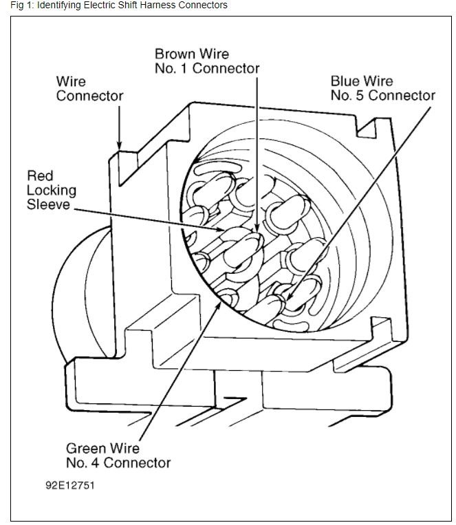

So I was looking over what it would take to replace the shift control motor and ran into a conundrum with the wiring. There is a plug which leads the wires from the shift control module to the shift control motor. Most of the wires on the motor side lead in to the motor. But there are three wires coming out of this connection two of which lead to what I believe is the speed sensor and the third wire (a green wire) leads to what I believe is the wire feed for the magnetic clutch.
At any rate I cannot for the life of me figure out how to unplug this wire feed so that I can remove the shift control motor.

See if this helps.
On electronic shift models remove speed sensor bracket. Fabricate tool by forming small hook at tip of paper clip or safety pin. Remove Red locking sleeve from connector by hooking with tool and pulling from bottom.
Fig 1: Identifying Electric Shift Harness Connectors

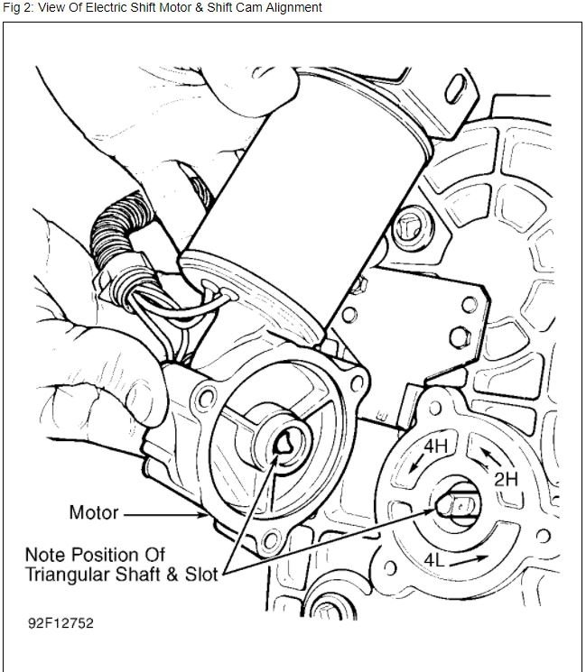

Remove Brown wire (center), Green (No. 4) wire and Blue (No. 5) wire by pulling from back of connector. See Fig 1 . Remove speed sensor and shift motor, noting position of triangular shaft in case and slot in motor. See Fig 2 .

Fig 2: View Of Electric Shift Motor & Shift Cam Alignment
