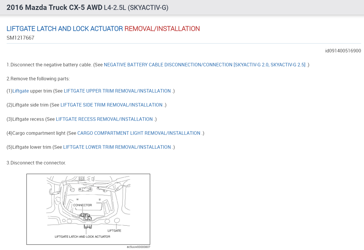

Lift back will not open. I have to crawl into the hatch area of car and with a flathead screwdriver manually move the latch to open the lifts back.
Part number I wish to install is: Trunk Latch Liftgate Actuator G33M-62-310B
Mar 31, 2023 at 5:09 AM
  • 55,721 POSTS

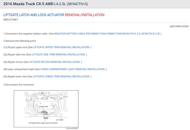

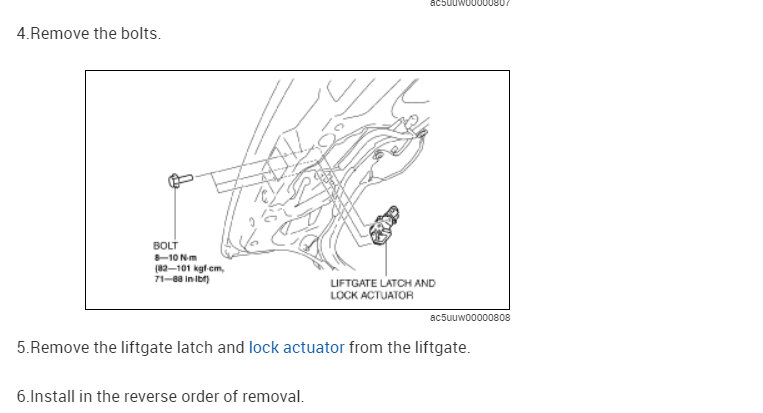

Sure, here are the instructions on how to change out the liftgate in the images below. Please let us know if you need anything else to get the problem fixed.
