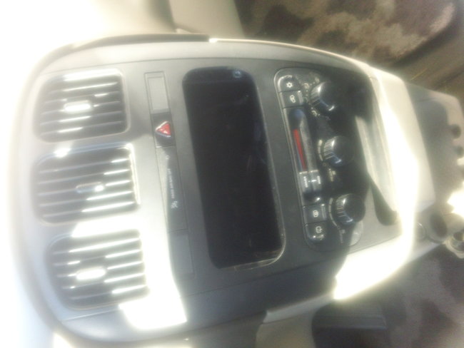

Never seen them tear one out that way, but I guess they may have. Around here they just unplug the unit and stuff the wiring plugs out of the way. That would mean all new wiring and speakers along with a replacement head unit if they pulled the wiring. That isn't a fun job. Think you could take a picture of the dash opening and post it, might have an idea depending on what I can see.

I will see if i can get a pic/video of it sometime tomorrow morning for you.

This is the best i could get. Where the gap is, if you put your hand in there, you can actually fit half your arm all the way in, which explains what i was meaning when i said there is nothing there. You may have to rotate the pic and enlarge it.

That is the factory surround just missing the radio. It can be gently pulled out to remove it, then look in there and see if you find any disconnected plugs, There will be one multi-pin connector that could be tucked just about anywhere because it isn't very large. As for a replacement, you can get a kit that lets you install an aftermarket unit right in that opening. The trim gets pulled out and the kit has brackets and clips to install the replacement unit.
