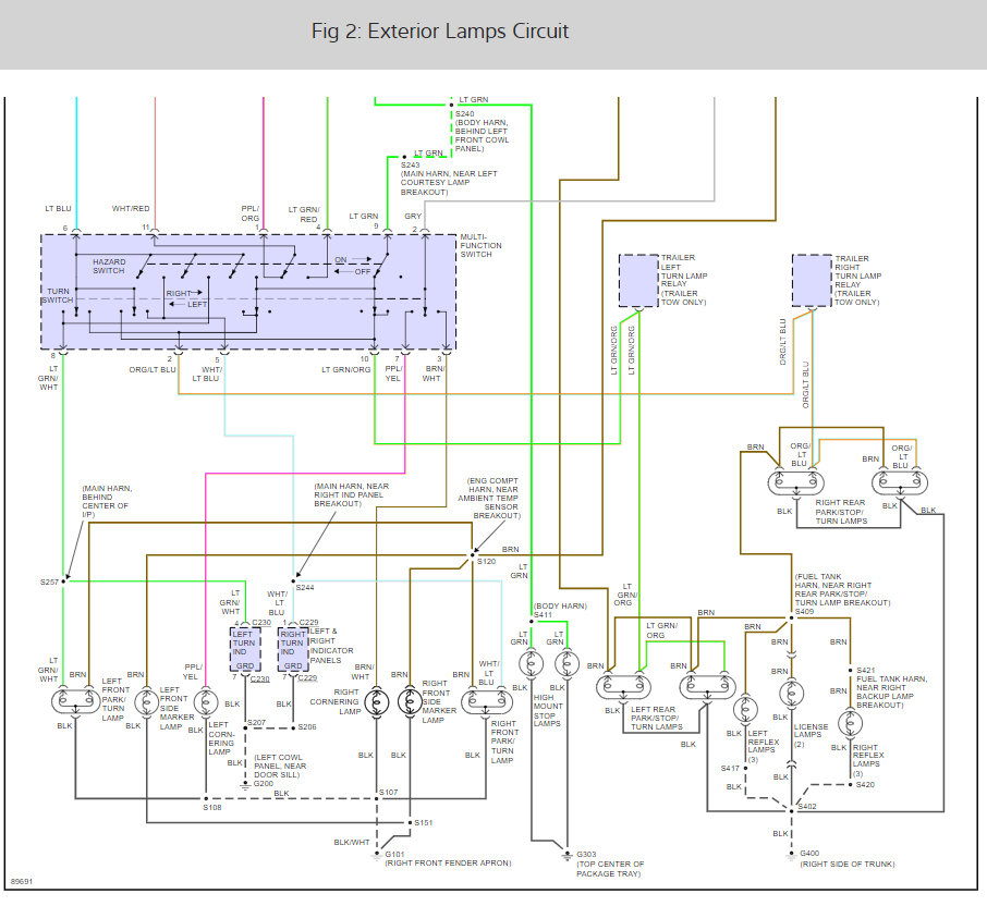

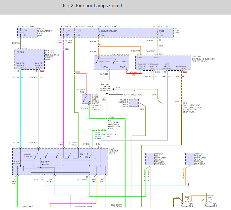

Replace light control module, warning lights now work, but turn signal lights are inoperative. Fuses are good. Can it be the turn signal switch? What do you suggest?
Jun 1, 2018 at 2:35 PM
  • 54,840 POSTS
Yes, it could be the switch but to be sure lets check to see what where are losing power. Here is a guide and the blinker light wiring diagrams:
Check out the diagrams (below). Please let us know what you find.
