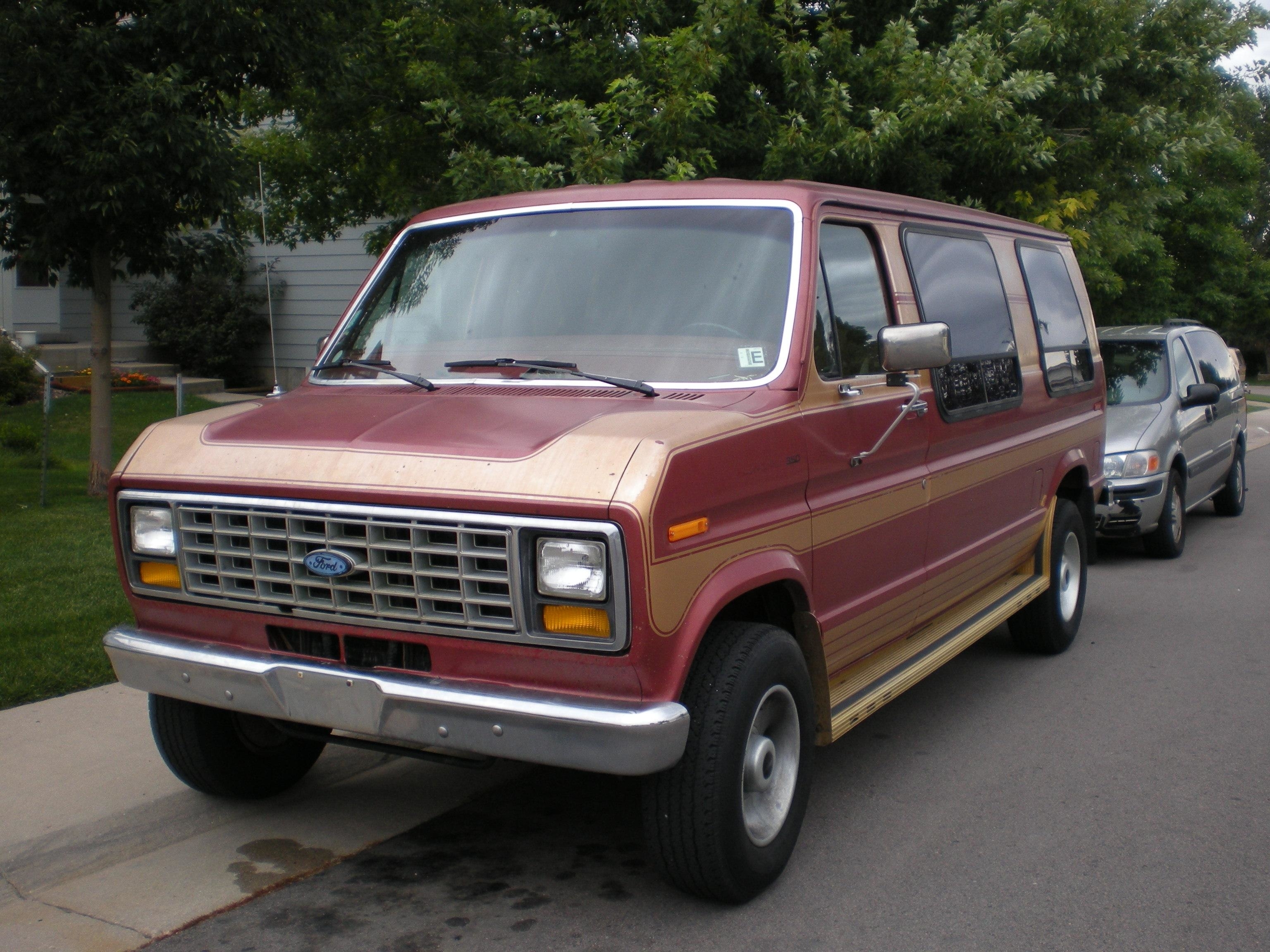

Need to replace the front passenger side turn bulb on a 1986 Ford E150 Econoline van; it is burned out. Can't find easy access. Must I remove the battery in order to get access to this bulb in order to replace it? Thanks. - Ken -

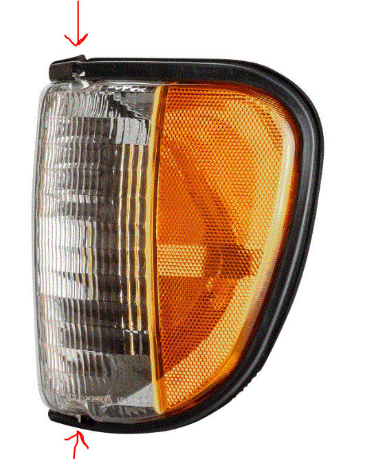

It has been a while since I've done one. However, if I recall correctly, there should be two screws holding the assembly to the vehicle. If you remove them, the assembly will come off and then you can access the bult.
Take a look at pic 1 below. I have arrows pointing to where I believe the screws are located. Check if I'm correct.
See pic below.

Attached is a photo of the 1986 Econoline front end. As you can see, the front light does not match up with the photo that you emailed. Your photo must be a different model or year. Please give this another shot using the new photo. Thanks. - Ken -
May 26, 2022 at 3:31 PM

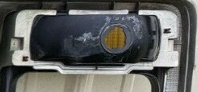

Ken, you're right. That was a 96. Sorry about that. This one either requires the battery removal or the front grille. The lens assembly is clipped to the rear of the grill.
I attached what it looks like from the rear.
See pic below.
