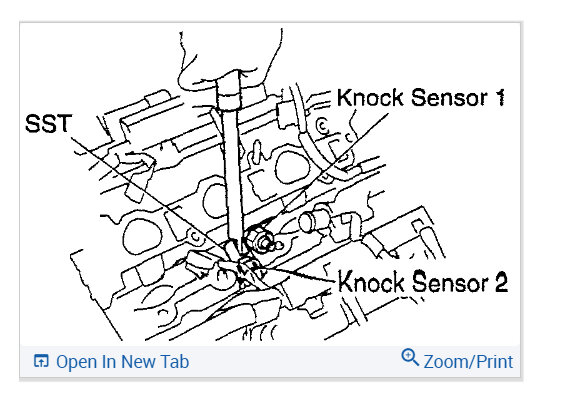

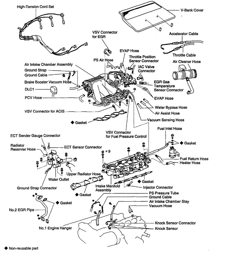

i wish to replace the knock sensors in my car listed above, v6 engine 3vz-fe.
Nov 10, 2022 at 2:27 PM
  • 55,694 POSTS
There or two knock sensors, one for engine of the engine banks which are both located under the intake manifold. Here are instructions to replace the sensors in the images below. Please let us know if you need anything else to get the problem fixed.
