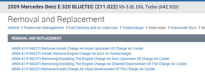

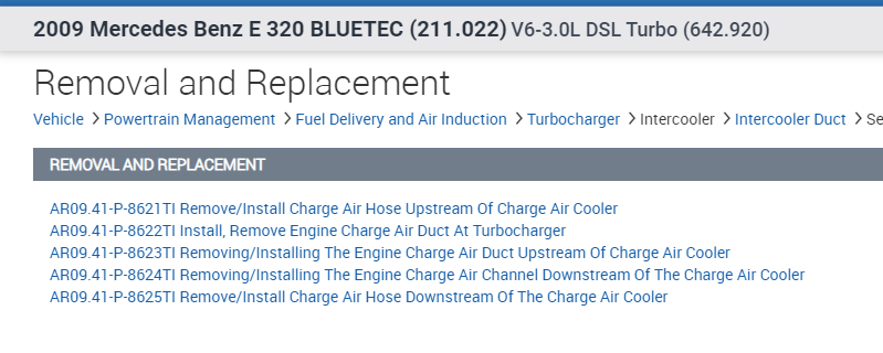

I would be happy to help with specific directions. However, there are several different hoses/tubes related. Were they specific in which one needed to be replaced?
Take a look at the pic below. It lists the different ones that could be the problem. Let me know if you see the specific one involved.
joe
See pic below.

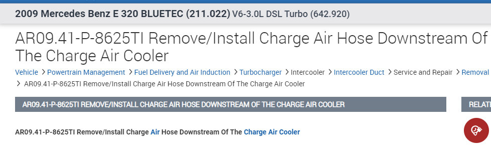

Hi Joe, I think it is the last one, exit of the intercooler, back to the air inlet. Here is the part number and link to FCP Euro: https://www.fcpeuro.com/products/mercedes-charge-air-intercooler-hose-burgaflex-2115282682
Oct 17, 2023 at 11:59 PM
  • 110,244 POSTS

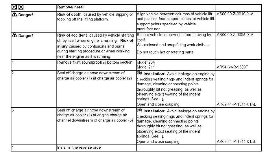

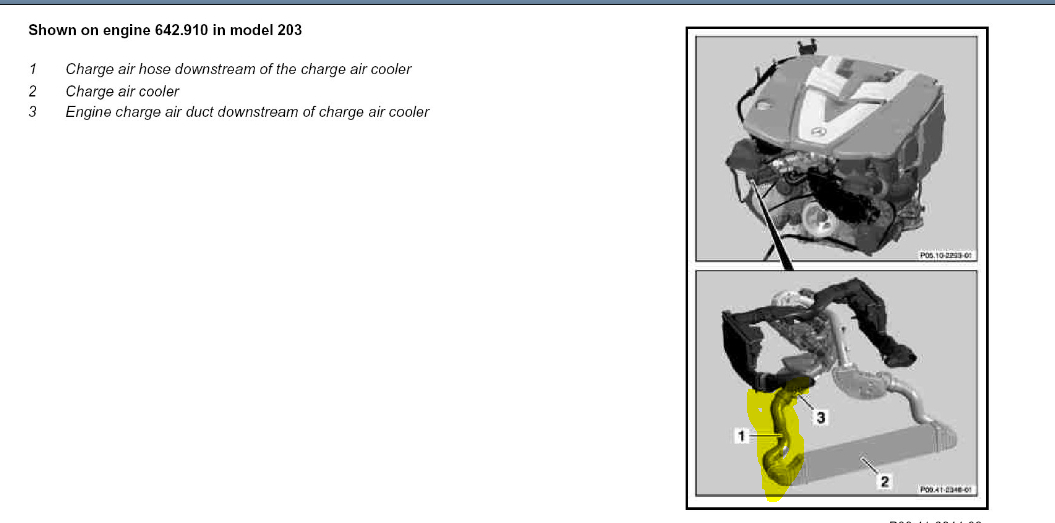

I attached the directions below. In pic 2, I highlighted the downstream hose which I believe is what you are referring to.
Take a look at the pic and let me know. That appears to be the one in the link you sent me of the part you ordered.
Oct 18, 2023 at 10:31 AM
RYAN.TIM.J
  • 57 POSTS
Hi Joe, yep, that highlighted one is it. Thanks. Procedure says go in at the bottom which is what I thought. Thanks for the help.
