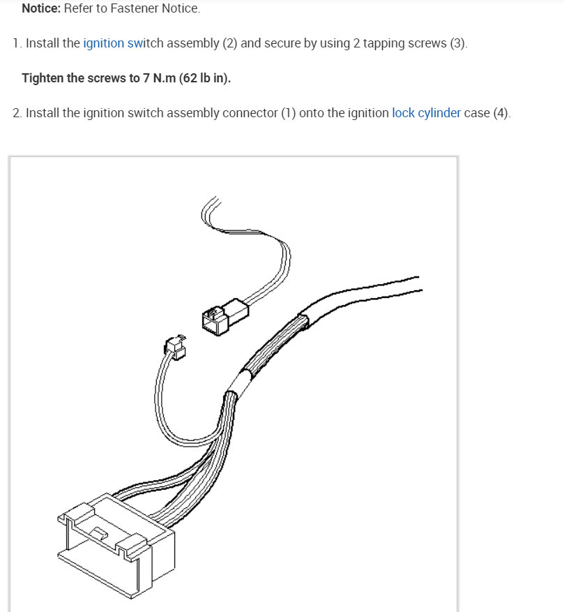

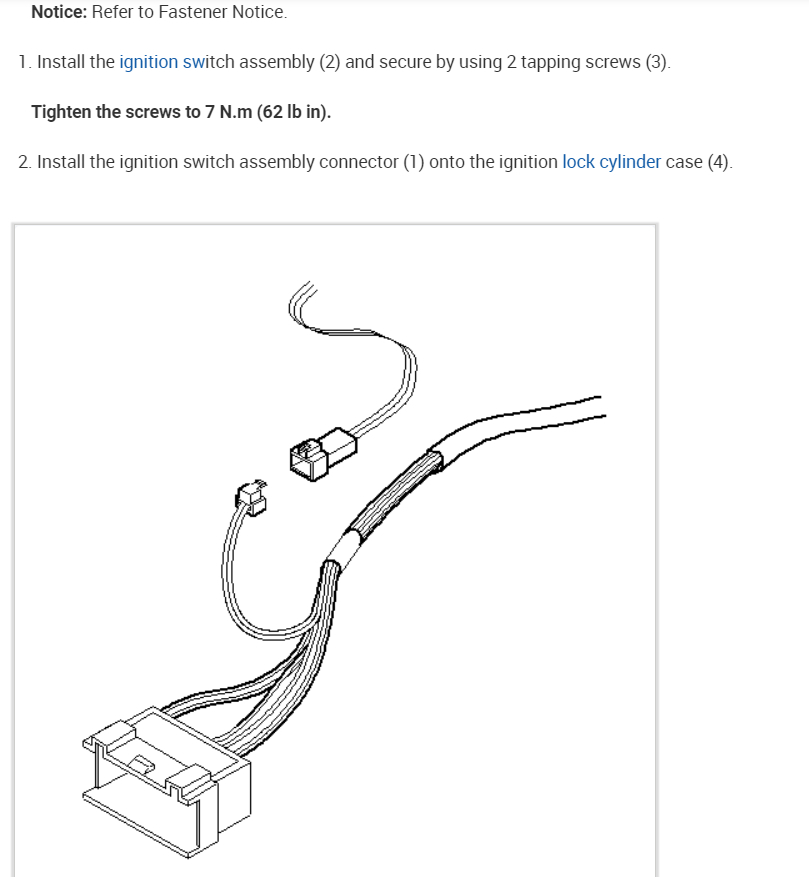

I installed a used ignition switch and lock key lock cylinder. now I tried to reset the pass-code by letting it sit for ten minutes with the security light blinking key on. I tried to restart the car and I get nothing but dash lights.
Jul 11, 2019 at 9:36 AM
DANNY L
  • 5,648 POSTS
Hello, I'm Danny.
Here is a tutorial showing the security system reset. Try this first and get back to us.
https://www.2carpros.com/articles/how-to-reset-a-security-system

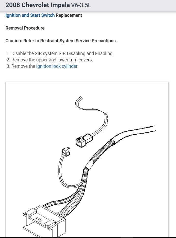

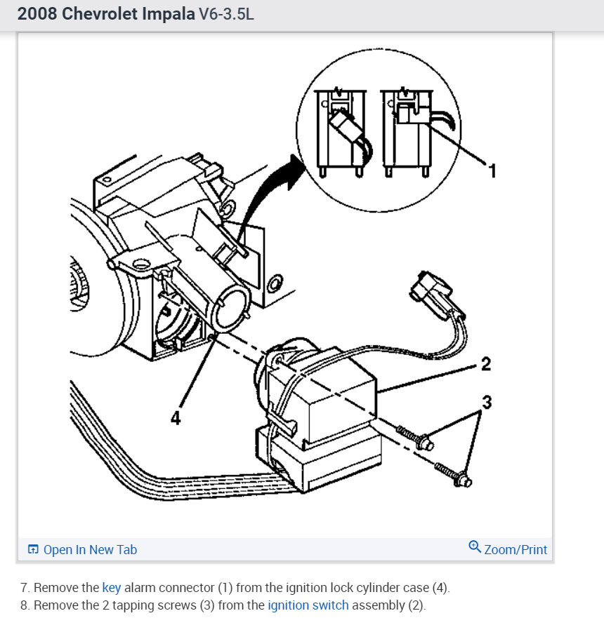

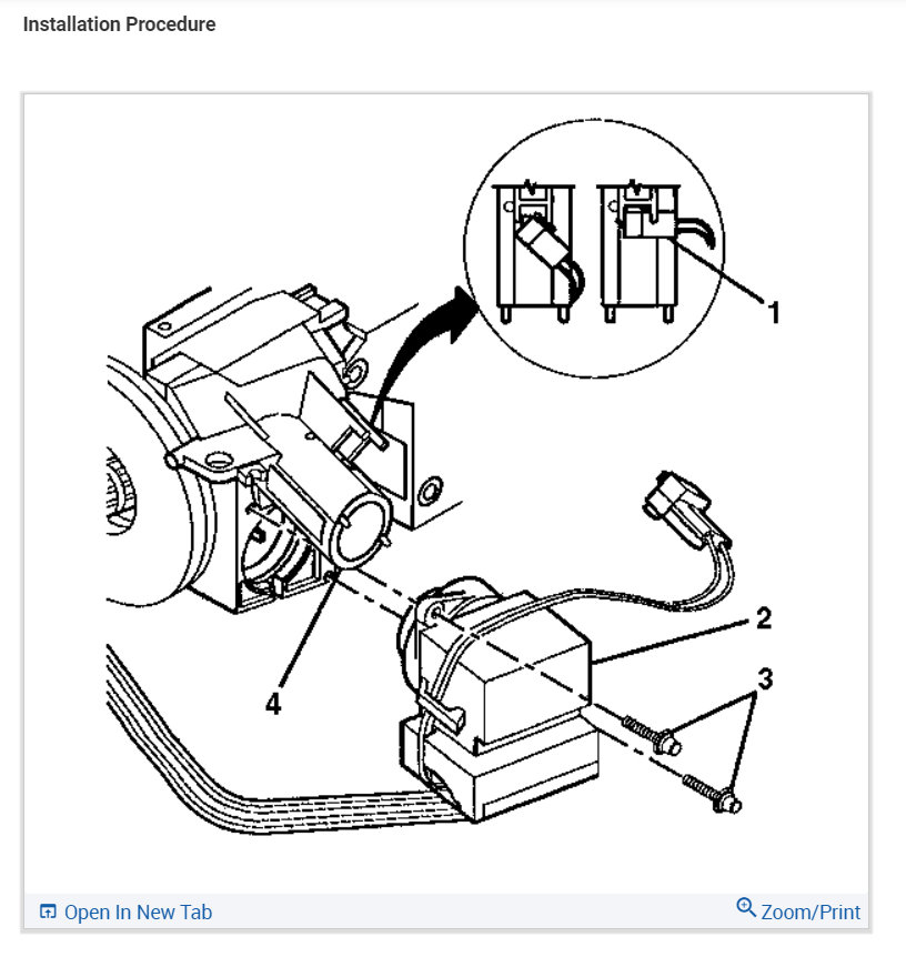

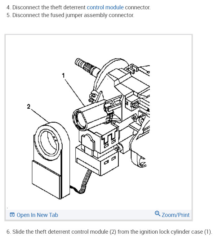

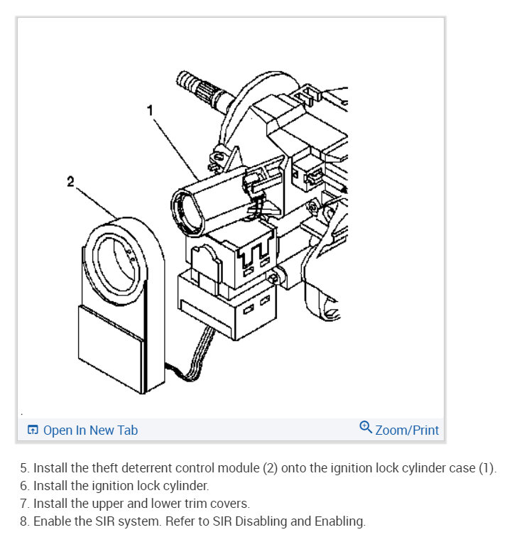

Also I have included the instructions on how to replace the ignition switch and key in the diagrams below. Check out the diagrams (Below). Please let us know if you need anything else to get the problem fixed.
