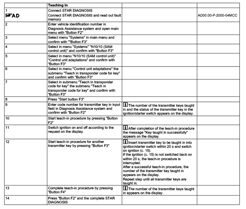

I purchased the car listed above with only one ignition key, which of course I lost it. I can't afford hundreds of dollars to replace all the fob functions. is it possible to get a replacement key that just starts the car?
Dec 19, 2020 at 1:20 AM
  • 55,628 POSTS

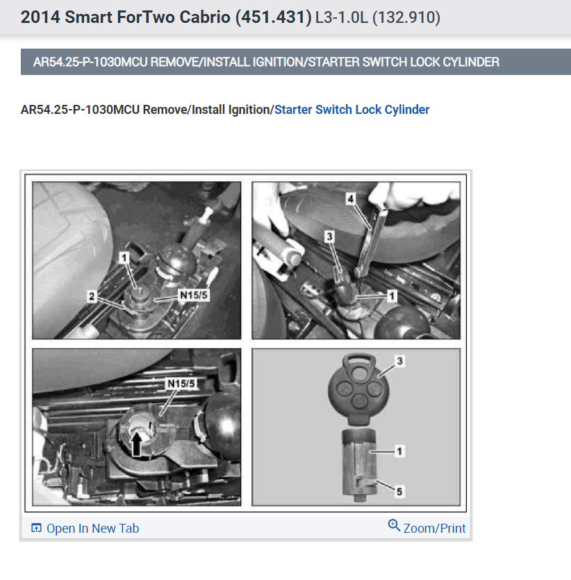

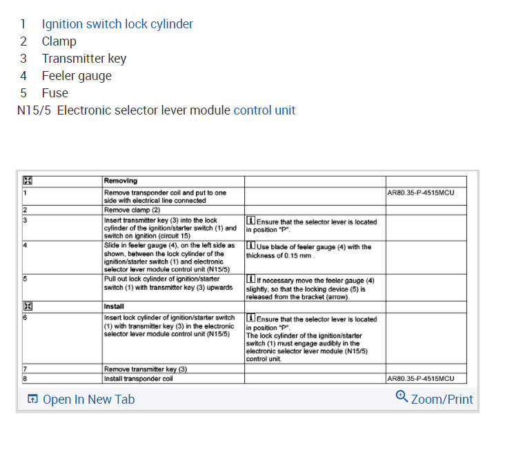

Here are the instructions on how to replace, the ignition key. Check out the diagrams (below). Let us know what happens and please upload pictures or videos of the problem.

I have a working ignition cylinder with no transmit key. If I follow these instructions I will have a second good cylinder with no transmit k key. Thanks for your efforts in any case. Bert
Dec 22, 2020 at 2:55 AM
  • 55,628 POSTS
Got it. try these instructions in the diagrams below. let me know
