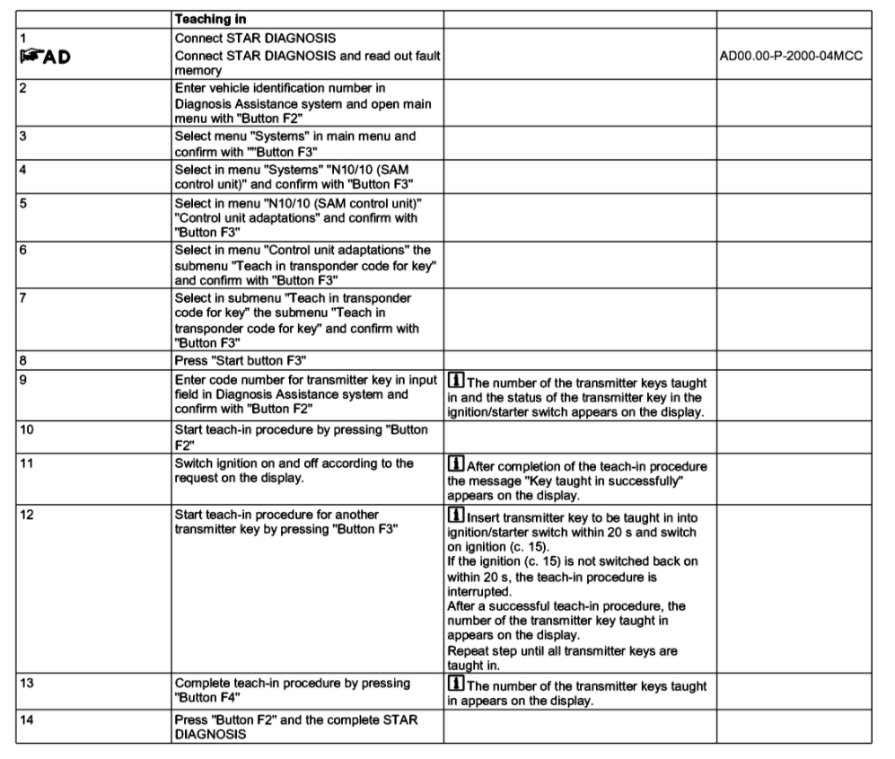

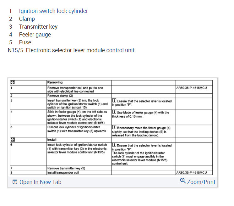

I have a working ignition cylinder with no transmit key. If I follow these instructions I will have a second good cylinder with no transmit k key. Thanks for your efforts in any case. Bert
Dec 22, 2020 at 10:55 AM
  • 54,832 POSTS
Got it. try these instructions in the diagrams below. let me know
