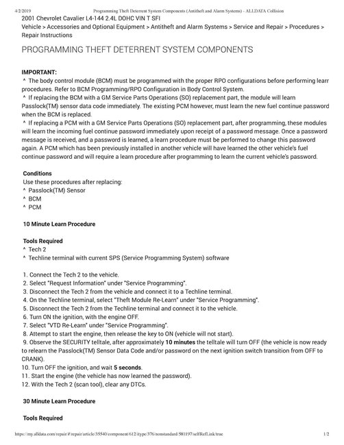

Someone tried to steal my car they put a thin saw blade through ignition. It come down to there is no ignition at all in car left. Will i need more then just ignition to repair and how do i reset the theft security on ca
Mar 21, 2019 at 2:16 PM
JOETECHPRO
  • 705 POSTS
Hey KELLIE BENNITT,

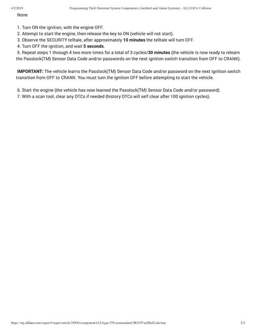

You should be ok if you replace the complete ignition including lock cylinder and the electrical ignition switch. You will then have a new key for the ignition.
The electrical ignition switch includes a sensor for the PASSLOCK system.
You may need to do a relearn, the procedure is attached to this message.
Regards, Joe
