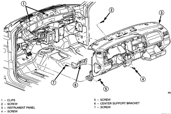

Dash Removal
Before starting this procedure, be certain to turn the steering wheel until the front wheels are in the straight-ahead position and block them in place. Very Important!
Much of this will be brittle plastic so be gentle in how you pry the clips loose.

10. Remove the center support bracket from the instrument panel.

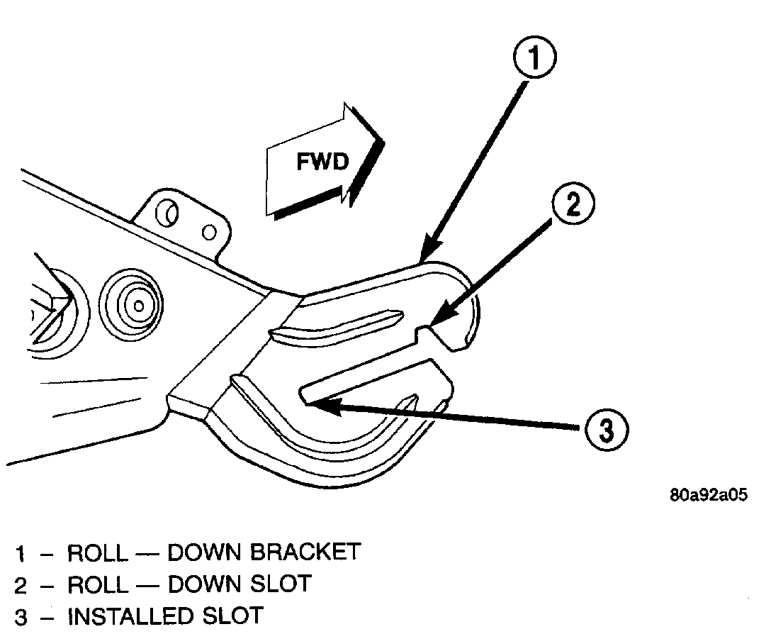

16. Loosen the right and left instrument panel cowl side roll-down bracket screws about 6 mm (0.25 inch).
17. Remove the five screws that secure the top of the instrument panel to the top of the dash panel, removing the center screw last.
18. Pull the lower instrument panel rearward until the right and left cowl side roll-down bracket screws are in the roll-down slot position of both brackets.
19. Roll down the instrument panel and install a temporary hook in the center hole on top of the instrument panel. Secure the other end of the hook to the center hole in the top of the dash panel. The hook should support the instrument panel in its rolled down position about 46 cm (18 inches) from the dash panel.

20. With the aid of an assistant, remove the temporary hook and lift the instrument panel assembly off of the roll-down bracket screws and remove it from the vehicle.

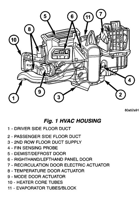

Front HVAC Housing
The heater-A/C housing assembly must be removed from the vehicle and disassembled for service access of the blower motor, blower motor wheel, heater core, evaporator coil, blend-air door, and each of the various mode control doors.

Heater core removal
1. Disassemble the HVAC housing to access the heater core.
2. Lift the heater core out of the heater-A/C housing.
Heater core installation
1. Insert the heater core into the bottom of the heater-A/C housing.
2. Reassemble the heater-A/C housing.
3. Install the heater-A/C housing into the vehicle.
Reverse all of the above to reinstall the HVAC case.
